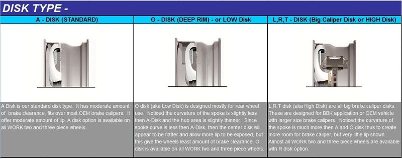

yes they differ between brands and even models, since at times the spoke design dictates the pad. advans are generous with their caliper clearances.
you can have the same wheel with different pads:
and
https://www.more-japan.com/blogs/201...he-disk-types/
