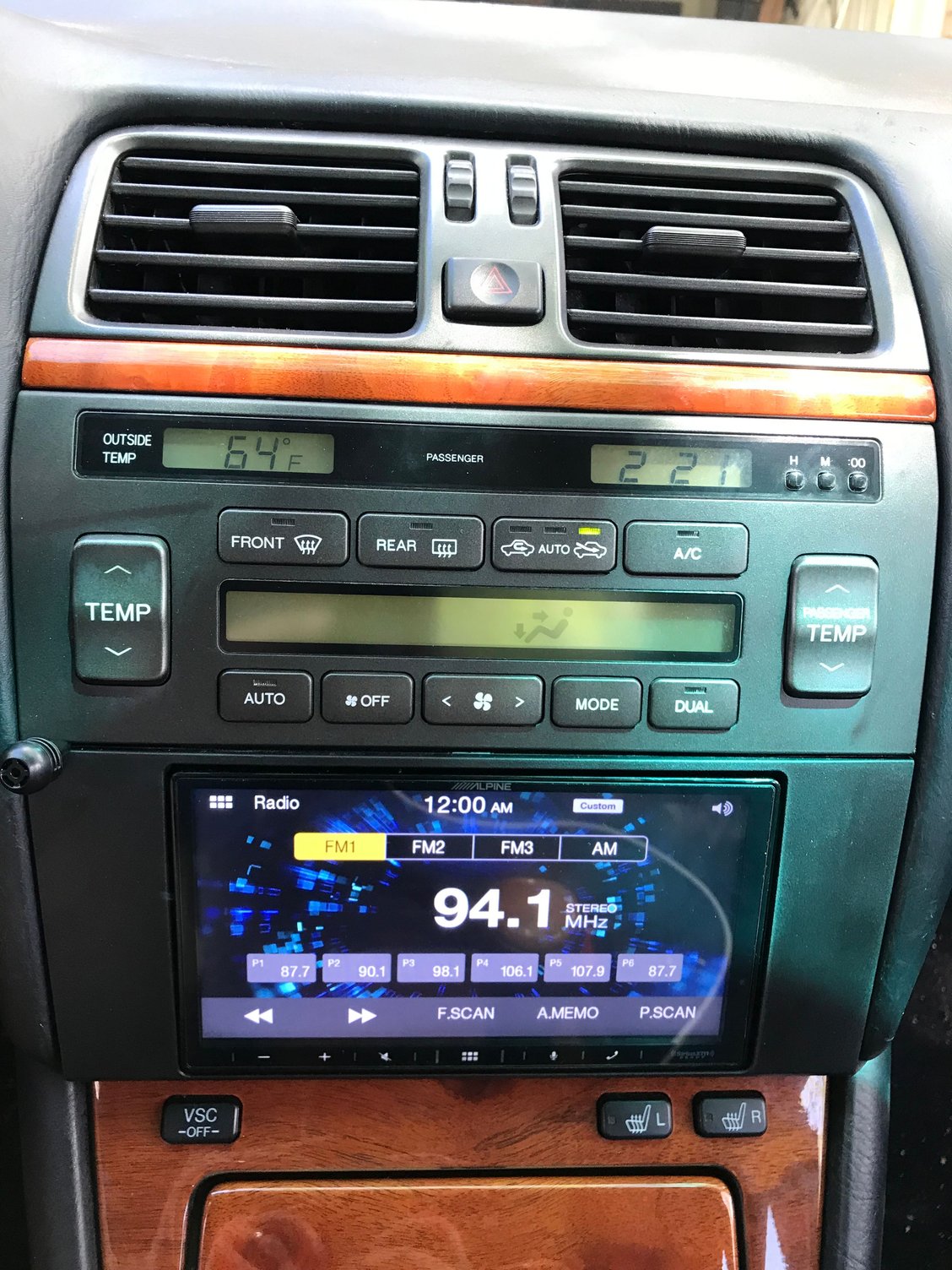

I have hands free and CarPlay!!
Going for a stock look in the interior, I think I succeeded. Only thing you can see in the cabin is the head unit. Microphone is temporary... I have an OEM looking one I will mount at a later date.
So far I really like the Alpine, I do miss a volume ****.

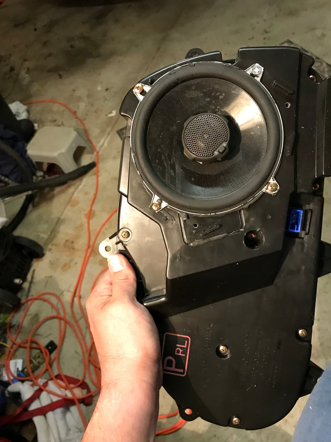

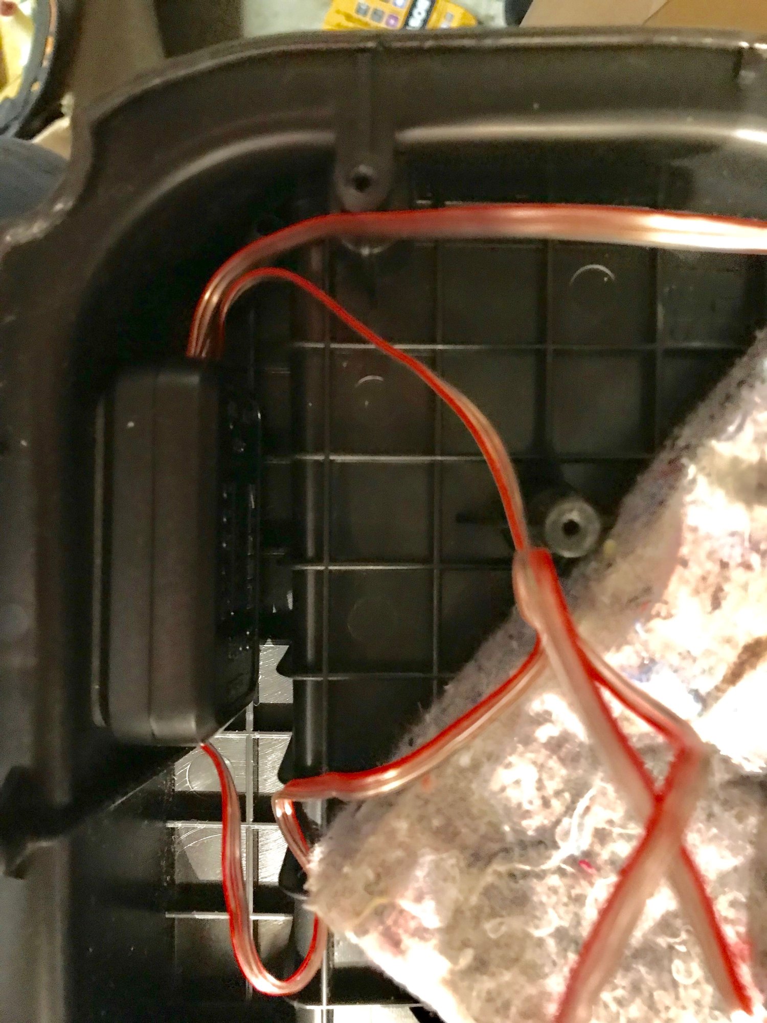

Hertz separates are great for the $100 I spent on them. The crossovers were small enough to mount in the speaker enclosure.

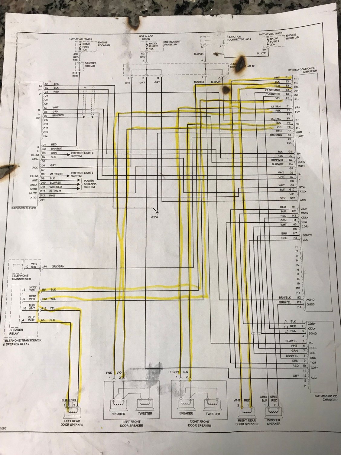

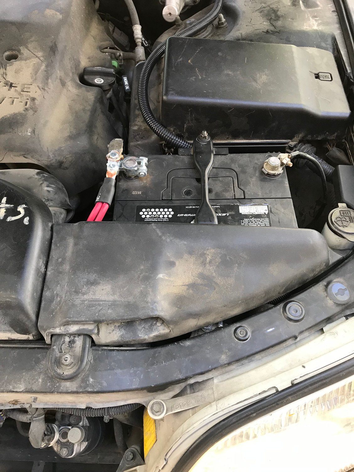

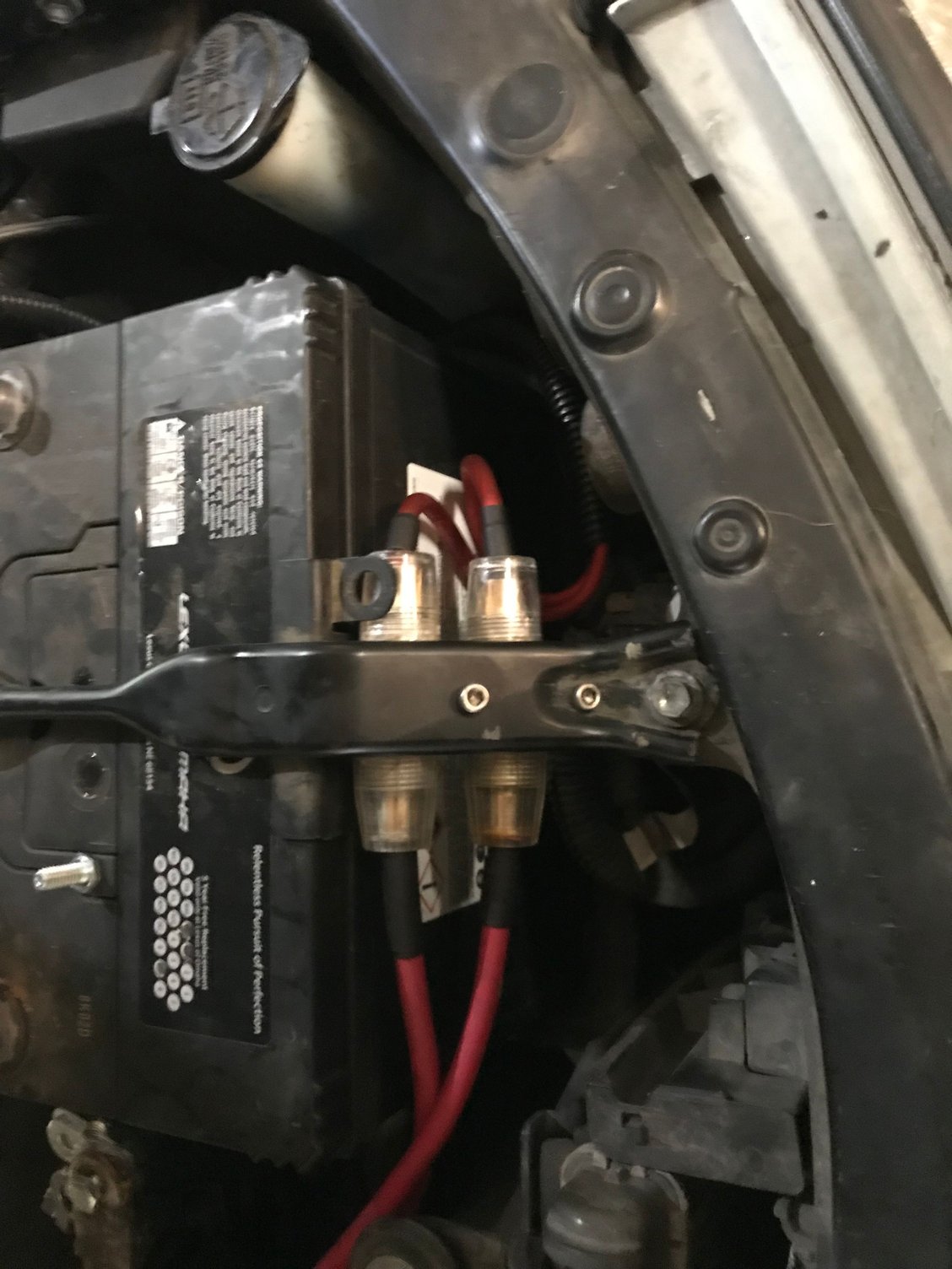

Ran 2 8 GA power wires, mounted the fuses under the battery hold down out of view. To the back of the engine bay, through the firewall on the passenger side, then down the side of the car on the floor passing through into the trunk right below the rear passenger side seat belt connection.
RCA’s and speaker wires run under the console up and over down through the stock subwoofer location.
Ran the speaker wires back to the stock amp under the seat, and soldered them to the stock harness. Worked great. I attached Photos showing the wire colors.

Crossover in the box...

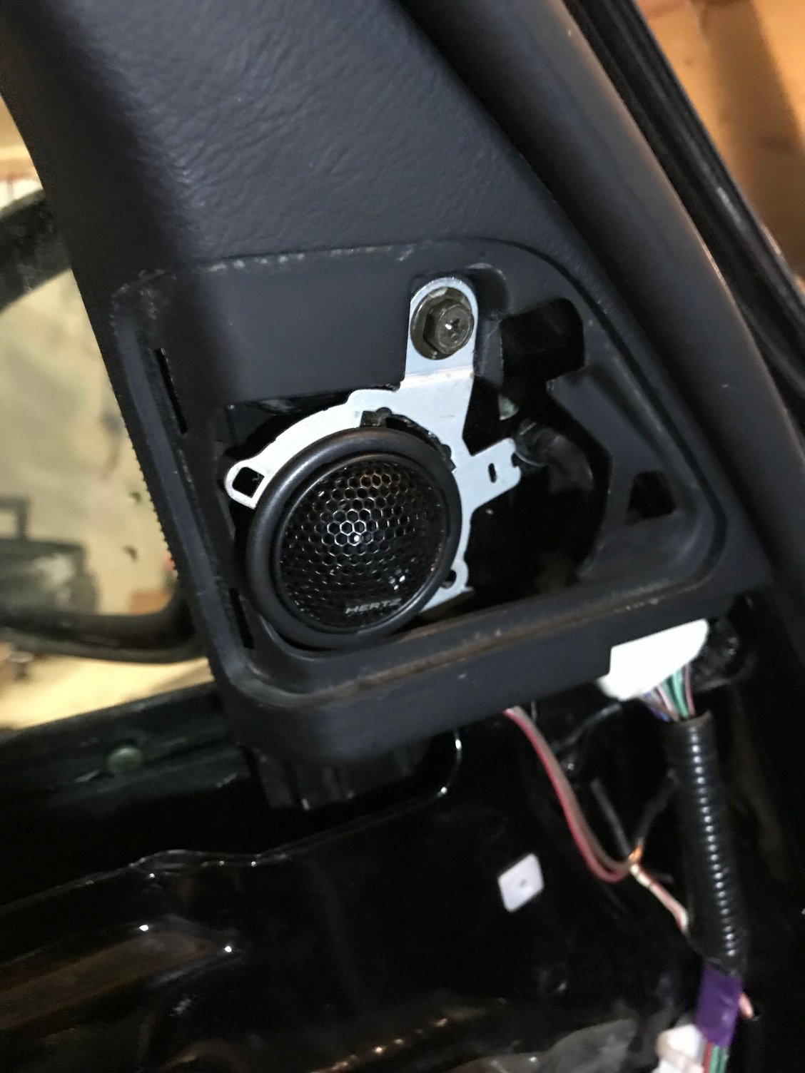

Stock Mount fit tweeter well, 2 sided tape on the back for stability

what double din kit was used?
Old May 22, 2019 | 04:34 PM
jayn's Avatar
jayn
Joined: Mar 2017
Posts: 14
From: NE
Default Dash kit
Metra 95-8153 $14.25 delivered on Amazon.
