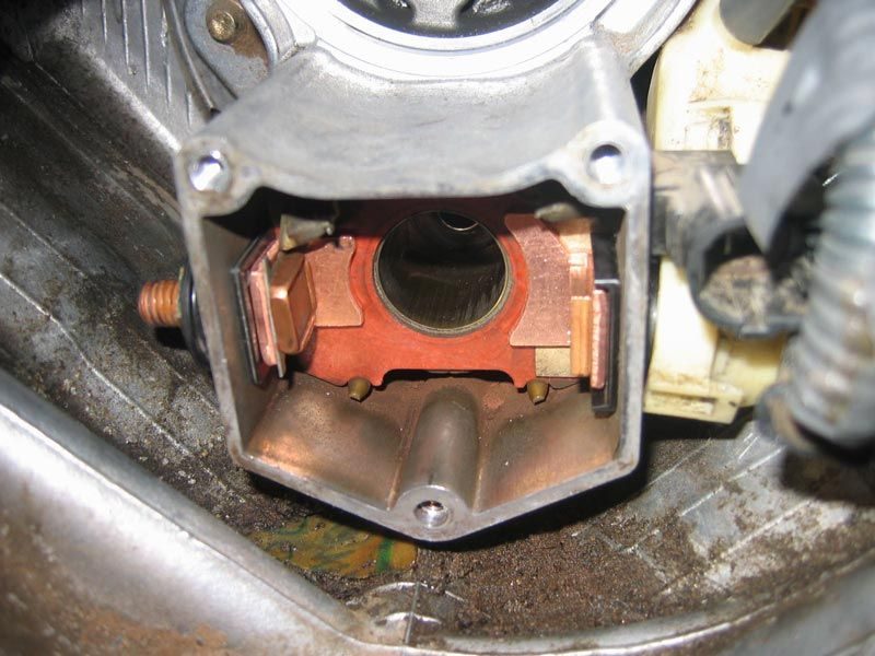

only gaskets you need are intake.. and you dont even need a starter, at 165k my 99 started to do the click click thing, we pulled it down and replaced the solenoid kit.. that was 8+ years ago,(2010) and it is still starting perfect....

Use only OEM component parts or consider purchasing a Denso rebuilt starter.
Your brushes are probably near end of life.
Replace the brush assembly..check.the commutator for wear.
Check bearings/ bushing run out- tolerances..
Lubricant is tired after 20.years: reduction gear assembly and motor bushings/bearings.
Unsure whether Toyota or Denso branded or recommended lubricant(s) available for the starter..
Anyone?
Part numbers?

Thanks so very much for your advice. Sorry for not posting earlier but I am nursing a bad knee injury has kept me sidelined for a long time. As we speak I am calling the day due to the discomfort in both knees. Regarding this particular starter, If my memory serves me correctly, This is the second time I change it in this car. The last time, My friend kindly helped me out and mainly he finish the whole job. In return, I build him a nice concrete bbq. LOL. I did remember we only changed the starter with a pep boys brand. I still kick my self for not getting a rebuilt OEM.
I will take images of the solenoid. I think the starter is not the problem. I think to remember something to do with the starter not working well after the installation. The current starter only lasted some 20k miles. Perhaps I overlooked something? I do remember the car exhibited the typical symptoms of a failing starter.

I just finished installing the starter. The actual starter was bad the solenoid was engaging but the starter would not spin. I was able to install the starter without removing the water bridge. However, if I would do it again, I would remove it and put new gaskets. In the process, my temp sensor broke. I found a good replacement on eBay for about $ 8 dollars delivered.
