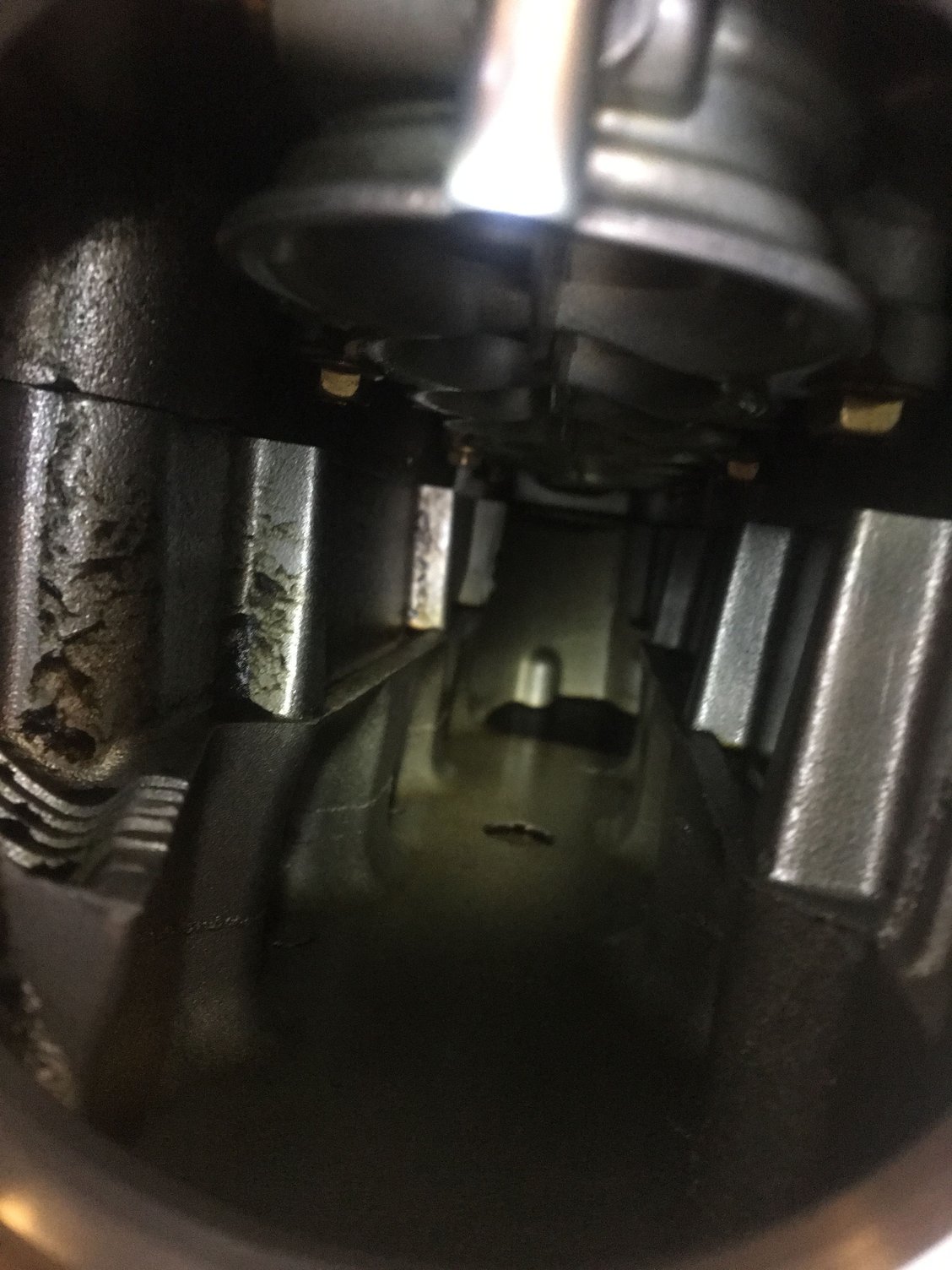

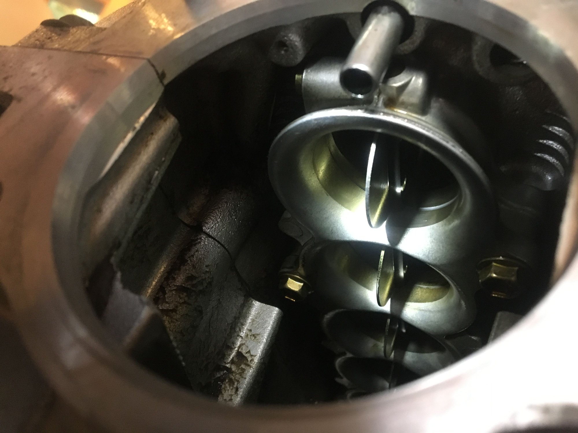

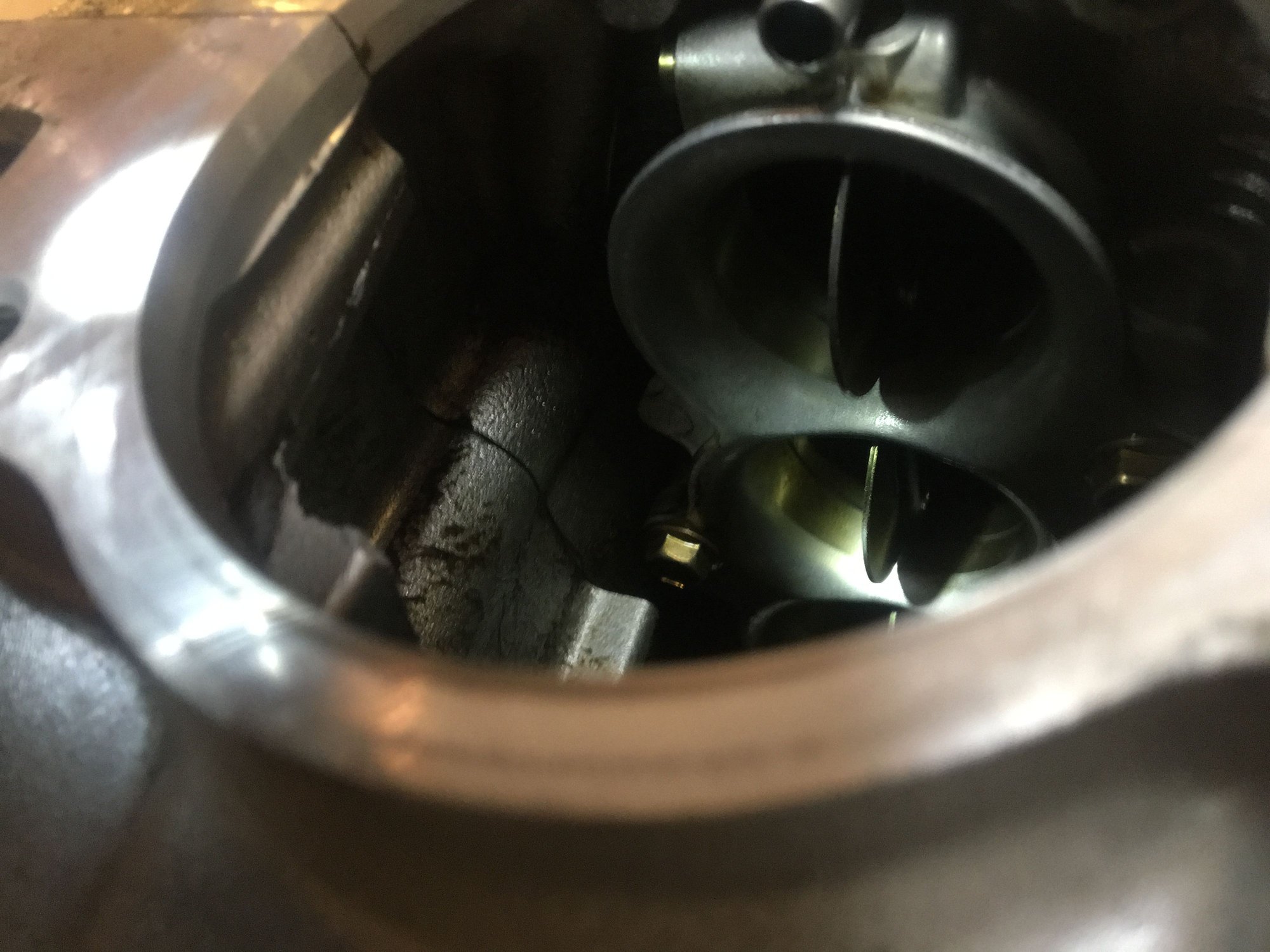

Changed manifold gaskets, valve cover gaskets, new injectors and spark plugs.
Spent a LOT of time just cleaning... every tube and every bolt...
The intake ports were pretty black and carboned up, I wrapped a waffle towel ( less lint) around two fingers, sprayed carburetor cleaner on the towel and fingered the ***** out of those ports, vacuuming every few minutes too.

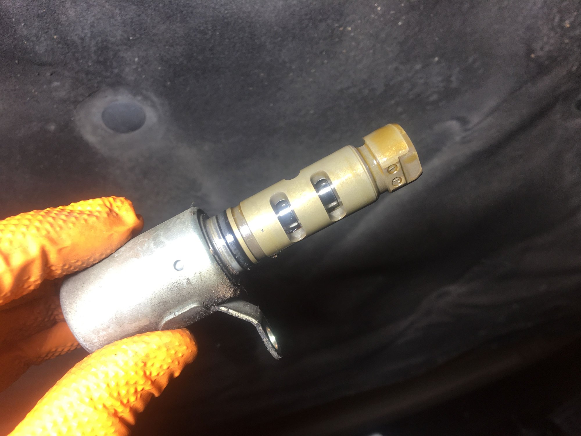

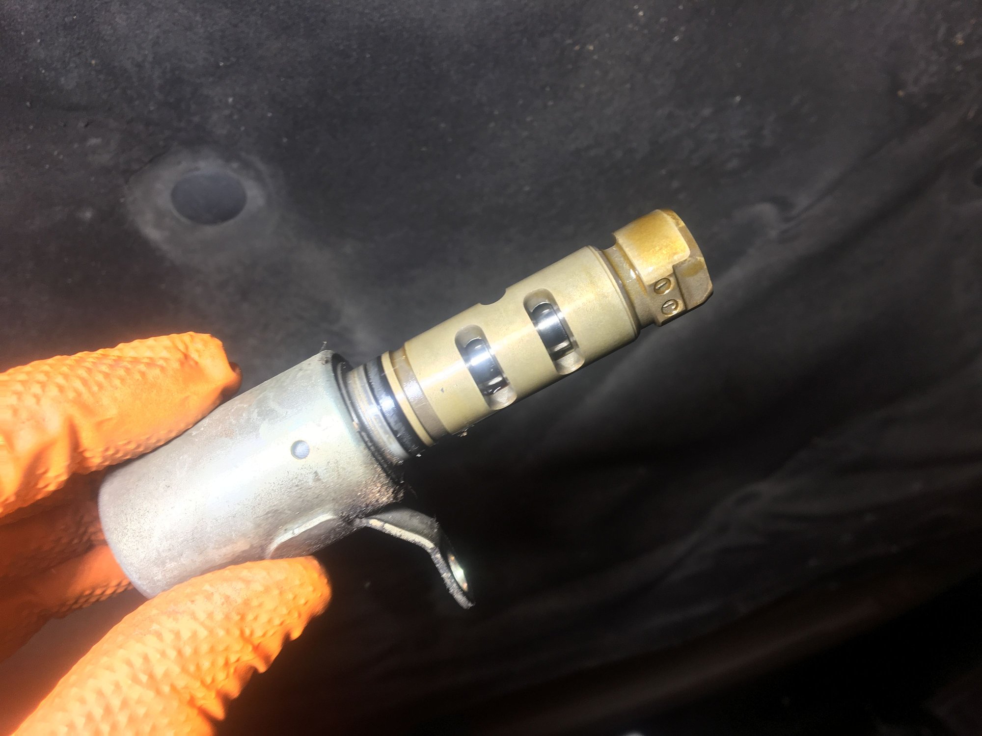

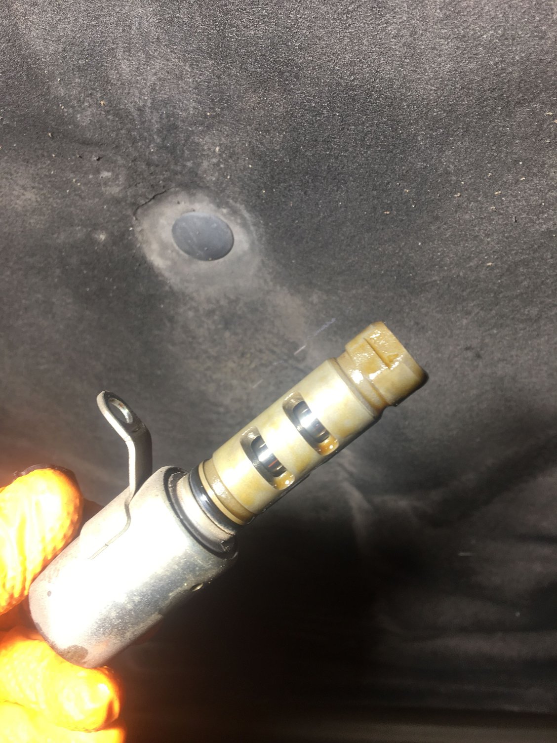

VVTI valves were pretty clean

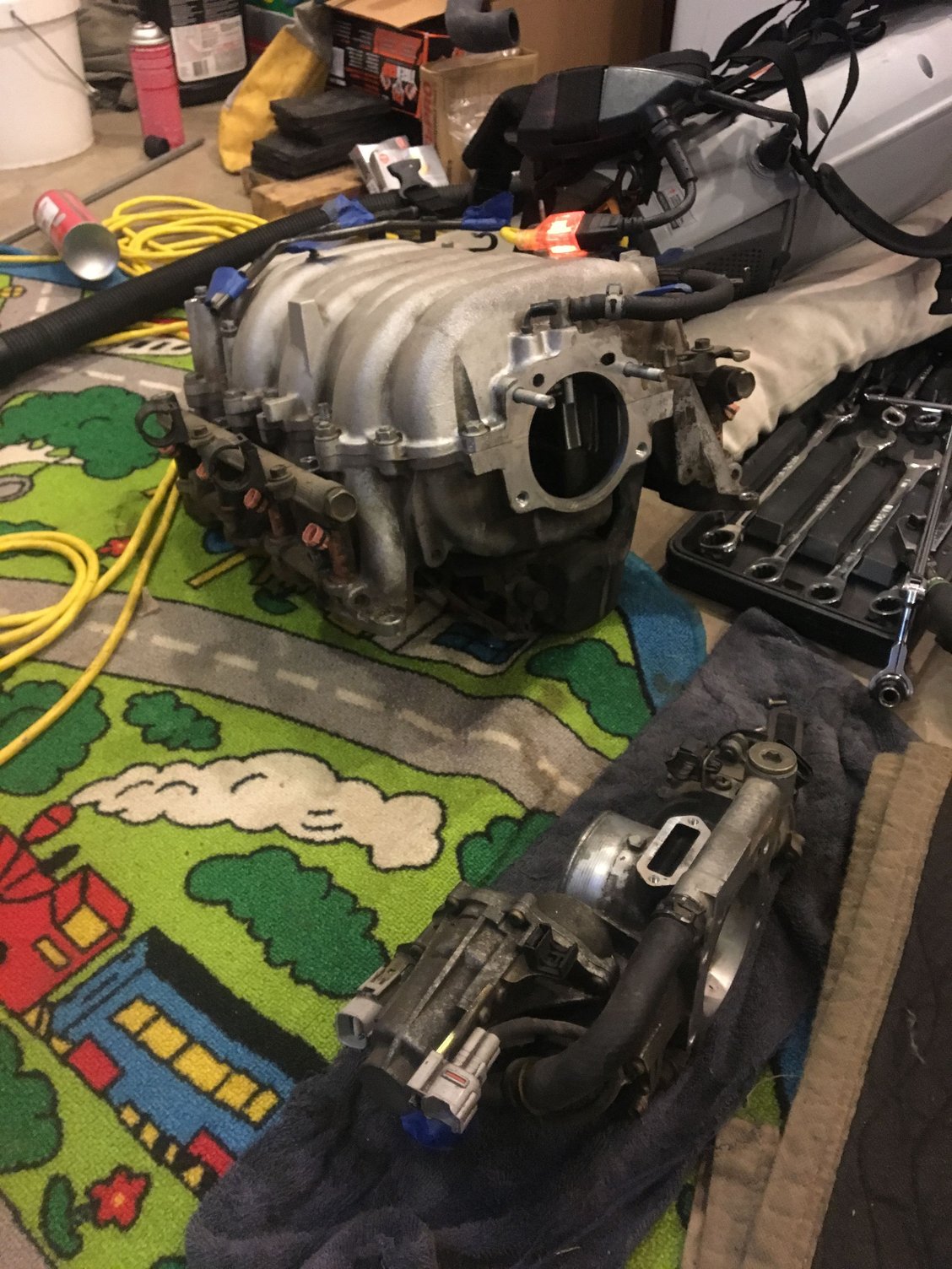

It was the most involved job I did on my LS so far, I had to take my time and stay organized.
The articulating t-arm and hose pliers were necessary.

This thing is pretty heavy and I had to climb inside the engine bay to pull it out

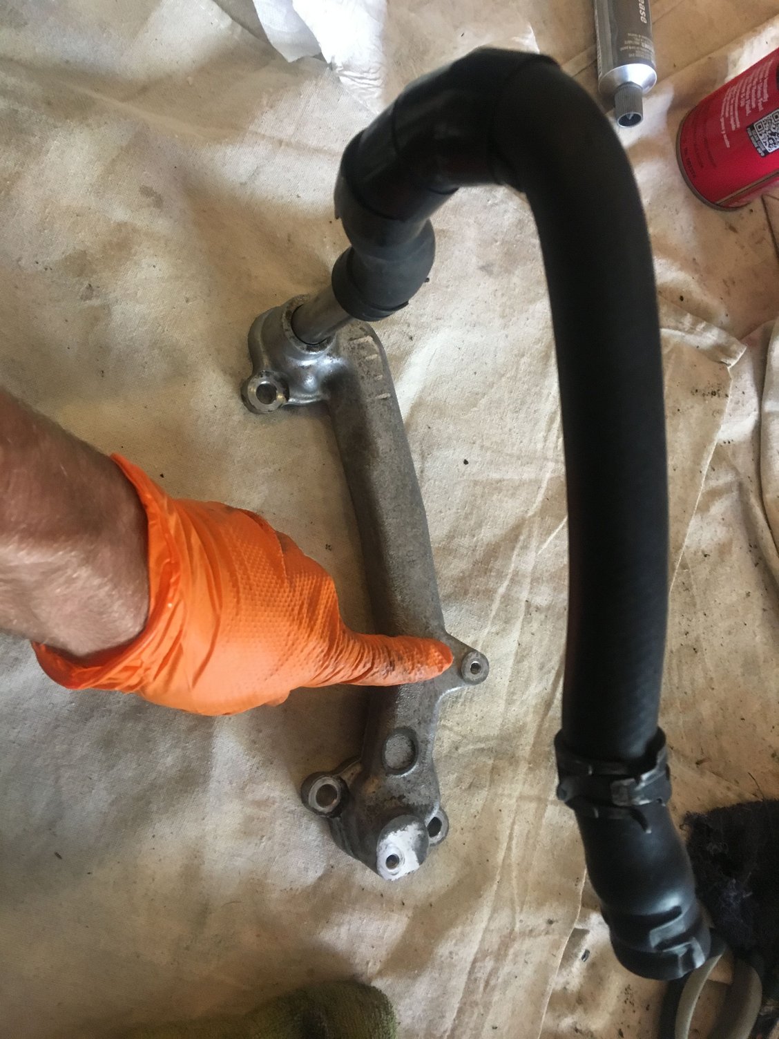

Rear coolant bridge came out completely, to make work on starter easier. 1998-2000 are easier than previous models with EGR, I heard.
New coolant bridge gaskets, of course.
That harness bolt on the rear of bridge I am pointing to was a pain to access.

Mission accomplished! As most can see I took my time and persevered through almost a week of sub zero temps and minor glitches and oversights here and there, but it was worth every bit of it when I finally "turned the key", it was music to my ears. No cel's, no hard starting, and it runs as smooth as silk. Cleaning the intake ports alone took a couple of hours, the gunk that builds up in there is incredible. After I scrubbed them clean I put an ounce of Sea Foam in each of the 8 ports, having that sit in there over a few days while I put everything back together can only help. She really runs smooth. The Denso Reman fired right up without a hitch, checking and cleaning all of the electrical connectors and wiring is a must, I had the misfortune of one of the knock sensor wires break off at the connector! I did a pretty good job improvising a fix that made the wiring much stronger than when new. I also took out both vvt-i ocv's and tested them, and did a reverse cleaning of the vvti oil filters by putting an ounce of Sea Foam into the ocv slots and blowing it out with compressed air, I think it worked. I took some photos but they are pretty much the same as posted by Valex above. One word of caution, make sure you remove the gas filler cap and don't put it back on until you've reconnected the fuel delivery pipe, I made the mistake of putting it back on "after" disconnecting the pipe and it represurized and continue to leak out veeery slowly, when I went into the garage the next day, there was gas all over the floor! It was an adventure to say the least, but now with 320k and she runs as smooth and good as new, let me know if anyone has any questions, otherwise I will keep you posted on the progress of the Denso reman from time to time. Cheers.
