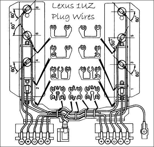

i would double check your spark plug wires to make sure they are seated properly. it might be worth unseating and reseating them into the tubes. also check the wires to the ignition coils.
when was the last time the caps and rotors were replaced? that's another source, but if the spark plugs themselves are an unknown, it's worth replacing first before tackling the caps/rotors.
welp, I’m back, seemed simple enough, the spark plug was shot. We are back, engine light is off…..
