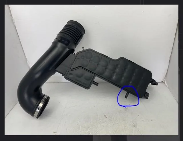

other than standard valve cover leaks it's also not uncommon for the little plastic extrusions on the intake to be cracked or broken off completely as they become brittle over time

like clockwork someone on the LS 400 subreddit just made a post yesterday about their LS having a P0171 code with this piece broken:
like 5 years ago i ordered a replacement piece since mine was broken here as well, i'm glad i could still find a new one then because now it seems unavailable... but anyway it's part# 17875-50161 for that piece
