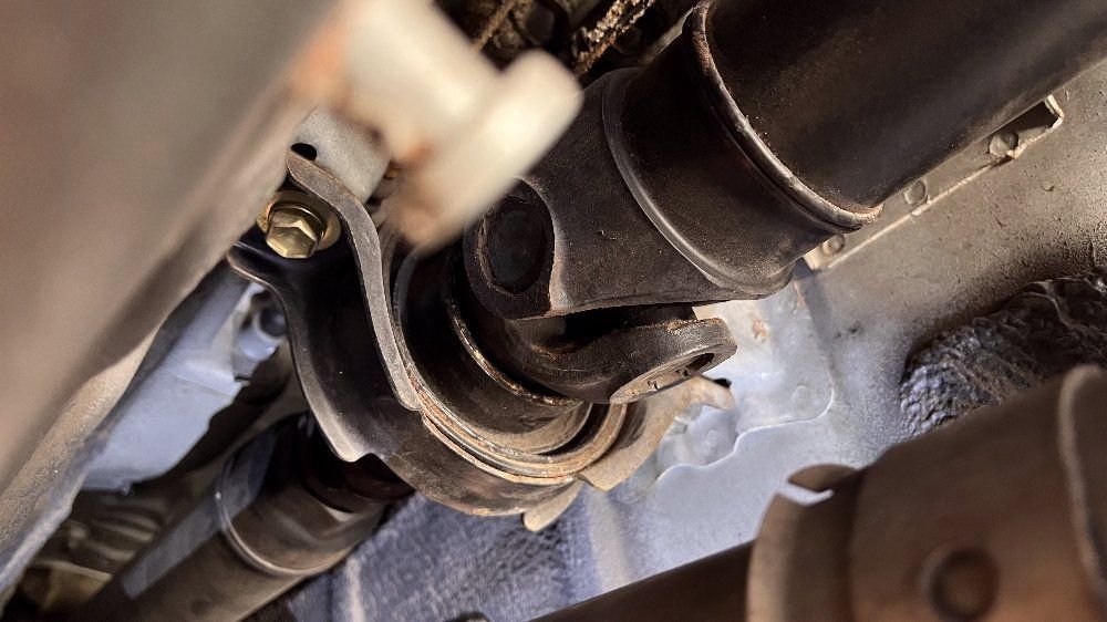

The center bearing moves about 1/4" vertically if I push it by hand. (The two ends seems solid.)
Is this amount of give clearly bad?

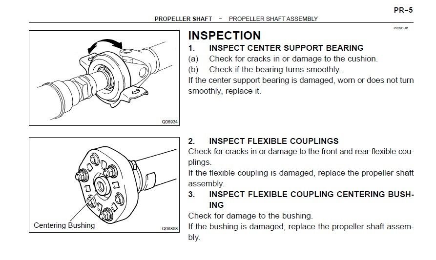

There is no movement spec in the center support bearing inspection procedure. That amount of movement you have seems excessive. You might have to get a new center support bearing and compare it with your existing one.
From '98 FSM

The only spec for the prop\driveshaft is runout (0.08''), and link angles which have an enormous 30 degree tolerance range.
Everything else is "to the judgement of the tech who visually inspects it".

How the carrier bearing moves.

SO I dropped the two bolts holding the center carrier bearing, and examined how freely it turns. It turns nice and smooth. But I'm not sure how much the rubber support is meant to 'give' vertically. It seems pretty flexible, like it moves more than 1/4" to 1/2" when I give it a shove.
At the rear, the rubber connector does have small visible cracks. The rear of the shaft definitely has more runout than the front.
What would your recommendation be? A complete new aftermarket shaft is around $500.

AFAIK, the driveshaft itself should be fine unless it's been hit, impacted or otherwise damaged. They aren't really a wear item. The wear items are the flex discs and the bearing. How were you able to determine the runout with it still attached to the car?
The standard playbook is to remove the driveshaft, replace the center bearing and the two flex couplings at either end. The parts should be about $280 from Amayama. I'm not sure if the bearing comes with that rubber surround, which yes should be there to support the driveshaft and act as an insulator. IF you're gonna pull the driveshaft, may as well replace the bearing.
For the record, I'm not sure if this will address your vibration concerns. I'm also not an expert on this w\ driveshafts and such. What else have you replaced on the suspension\driveshaft of the car? But I am curious, if you do go ahead with this, what the results would be.

For the runout I just held a thin screwdriver so it's side is pushing on the shaft, and seeing how much the handle moved - around 3mm at the rear and maybe 1mm at the middle of the front section. By geometry divide that but about 3. Up by the transmission it was basically zero. In other words, much more runout in the rear. I had it in drive and spinning the wheels up on the lift.
To remove the whole shaft, it looks like I do NOT need to remove the exhaust. Can anyone confirm whether this is the case or not?

The movement of your center support bearing is normal, it is designed that way. The proper way to measure runout is with a dial indicator and spinning the shaft by hand in neutral. With your screwdriver test the rear suspension was unloaded and fully extended so the difference in “runout” of the two shafts you measured is most likely normal. Did someone sit in the car while it was running on the lift to confirm the vibration is still there?
I have been chasing a vibration in my LS for years and put in three different driveshafts only to find out it’s not the driveshaft. It has been confirmed the vibration is coming from the torque converter. Not a cheap fix. Vibrations can be very difficult to diagnose.
Yes you can remove the shaft without removing the exhaust but it’s a bit more complicated and not recommended. Mark everything before removing the shaft if you insist on removing it. You must rule out the engine mounts as well, if they haven’t been replaced by now then do that before messing with the driveshaft.
