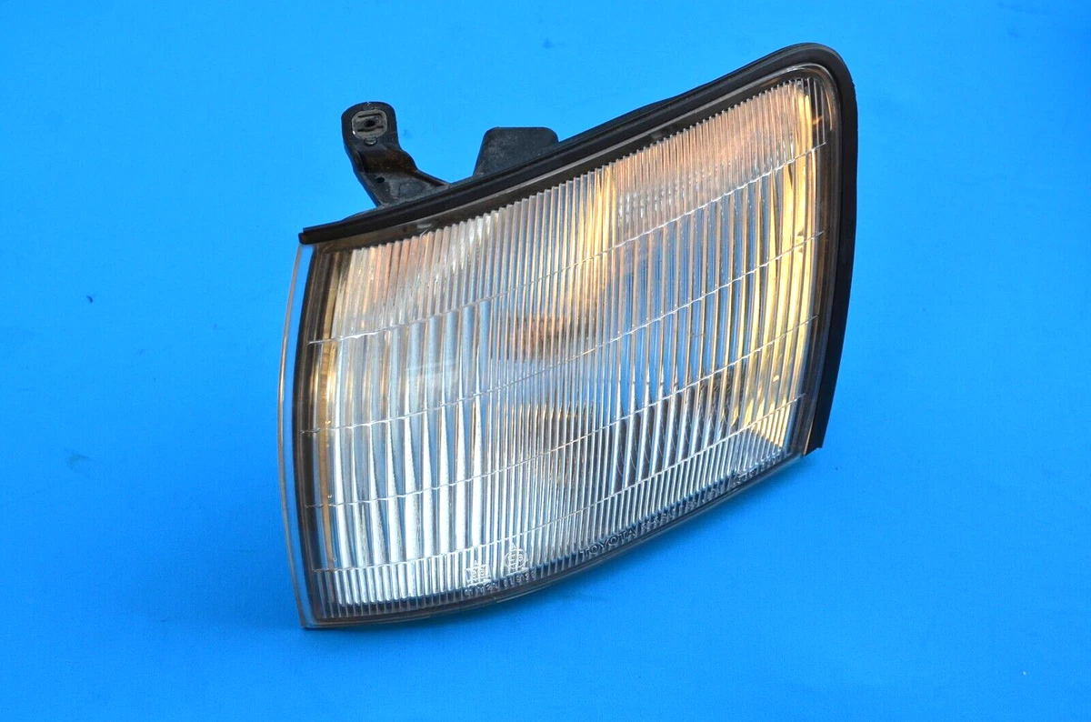

Both clearance lights, the ones next to the headlights have cracks on my '93 LS. What years will fit? A '90 posted at the local PnP so I'm hoping.

The clear corner lights beside the headlights, yeah?
1990-1994 will fit. The lens is exactly the same. The only difference is the backside of the housing changed in 1993 to save on some plastic, but the fitment and exterior appearance are the same
