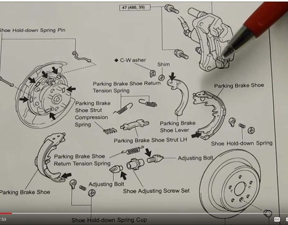

Don't mess with the foot pedal it never needs adjusting (unless someone messed with it). Remove the inspection plug on the rotor and rotate the adjuster to back off the parking brake shoes as much as possible. If the rotor still won't come off use your bolts to put tension on the rotor then hit rotor with a hammer. This is what you're dealing with
https://www.japan-parts.eu/lexus/us/...-brake-cable/2

the rear are drum brakes inside the rear rotor hats, so first make sure the parking brake is off.
then you need to access the shoe adjusting screw (cog) inside the service cover hole on the rotor; turn the rotor so the hole is at the 6-oclock position as shown below and remove the rubber dust boot in lower right.
NOTE: pictures below are NOT LS400 but are similar.
