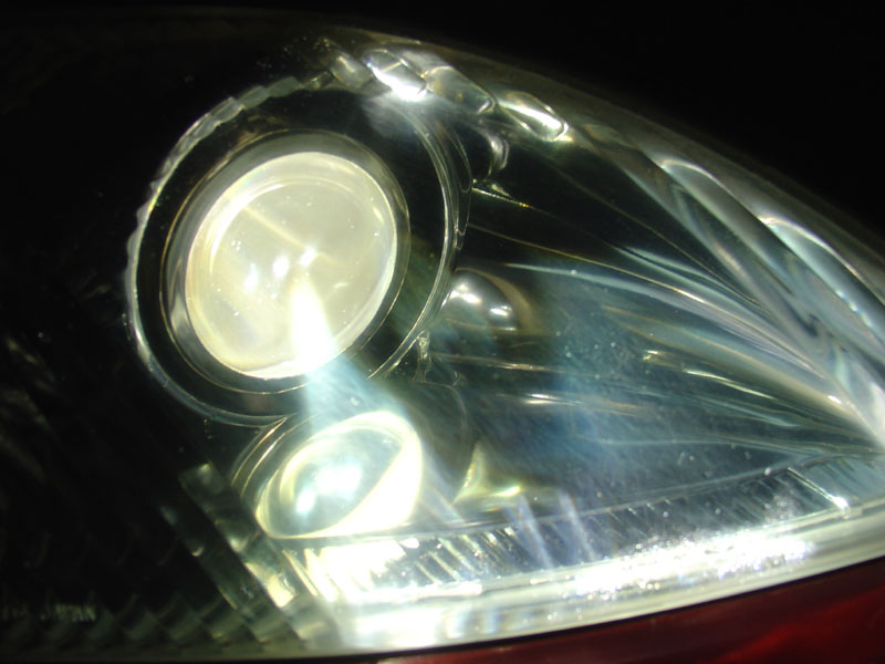

Originally Posted by biglexass
madness thats all iamgoing to say.....
haha. actually, delining the headlights wasnt that bad. took me about no more than an hour to finsh it off. its a ***** polishing it up cause i dont have the rotary buffer. i had to use the rotary buffer at my work

^^It actually took me longer to sand than to polish! what grit did you start at? I began with 400 grit, then went up after i had sanded down the lines. I made the mistake of wetsanding the whole INSIDE of one headlight when I first took it apart. I learned the hard way and had a heck of a time polishing in between those small curves with an electric buffer.
i took off the lines with 800, then worked my way up with 1000,1500, then 2000. yea, its pretty hard to use the buffer inside the lens

awesome retrofit, the lens look very clean, what type of polish are you using? I don't think I'm getting the best out of my retro...it's the lens...but already delined.
i just used what i found in my garage. it was turtle wax scratch and swirl remover. i had to use an electric buffer to polish it and make it shiny otherwise it'll be all hazy and cloudy when i try doing it with my hands

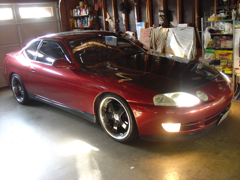

all done! been waiting for bulbs to arrive and finally got em. ill get some night shots soon. heres a preview for now. btw..dont mind the black sides imma have it painted soon hopefully.

Looks great! What temperature are those at? Can't wait to see night shots and cut off beam shots.

not sure. its 85122+ from a es330
