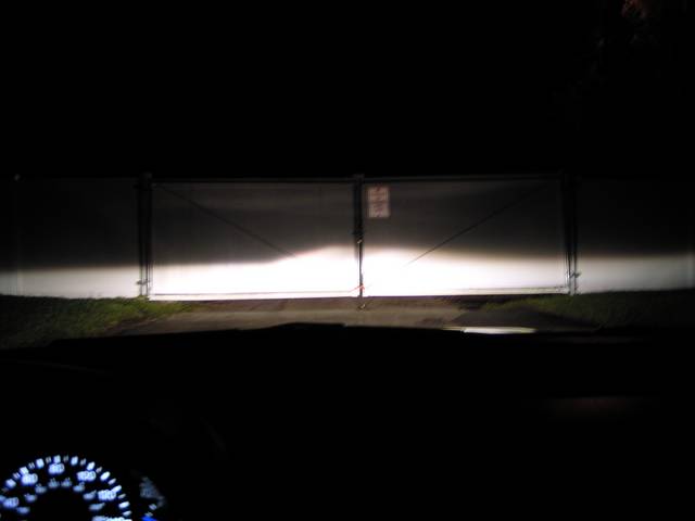

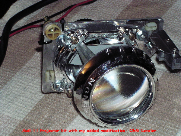

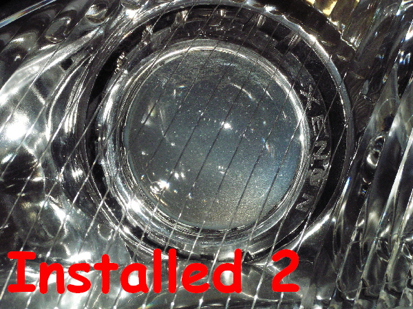

SC400TT's Avatar
SC400TT
Joined: Mar 2003
Posts: 3,395
Originally Posted by SC4Hundo
OK, maybe you guys can clarify something for me.
Is it possible to do a HID conversion on the SC with out having to change the projector?
I though you had to do a huge project, replace the projectors and all that crap, but i was reading a site somewhere that made it seem like you could do a hid conversion with just a bulb, ignitor and something else. I know im and idiot when it comes to hid systems and im not talking about crappy bulbs that claim to be hid or xenon, but i took it as a hid system that you could basically "bolt on" to your existing headlight system. Is this possible?
Plug-n-Plays are nice, but tend to scatter the light because the projectors are not really made for HID lighting, but a true conversion is a lot of work, like this one...https://www.clublexus.com/forums/sho...ghlight=sc400t
One cannot deny the excellent results of the true product...
Ryan
Old Feb 14, 2006 | 08:08 PM
LexAnt's Avatar
LexAnt
Joined: Dec 2002
Posts: 1,737
second that notion sc400T.... retrofit is the only way to go
