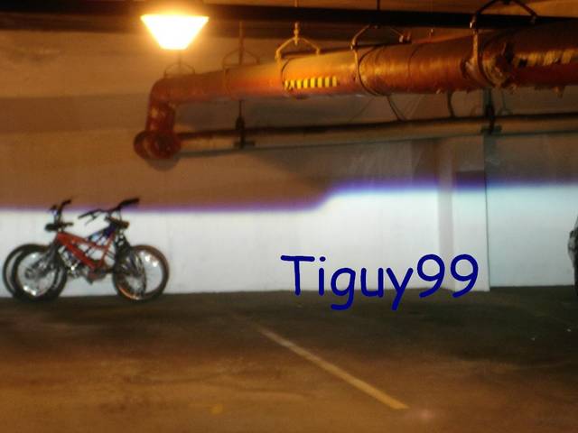

DO post pics of that cuttoff when done. The standard is 25 feet from a white wall kinda like this...
Actually that one (LS430 washer modded) was close to 50' at that point.
