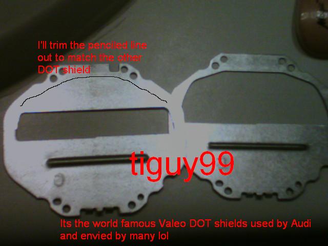

Finally the moment of truth, I picked up the Special DOT shields from Henry as well used to create the Hybrid projector which consists of the
Valeo Brand Audi A4 Euro Edition (ECE) model xenon projectors
Valeo Brand Audi A4 US Edition (DOT) model xenon projector shields

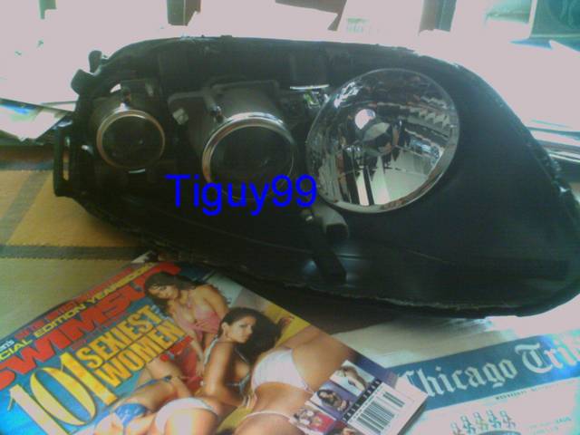

Here's a few shots from earlier. I've moved further along since then though. Right now I'm creating a new way to mount the projectors into this setup that serves good form and function which is what Toyota is known for. Look for that later. In fact this is exaclty how my old ES300 retrofit was and boy I remember those days. Definately a little higher on the challenge side but I know I can do it. Just takes a little more preperation but this'll come out well in the next day or so.
Anyhow enough about me....here's the pics

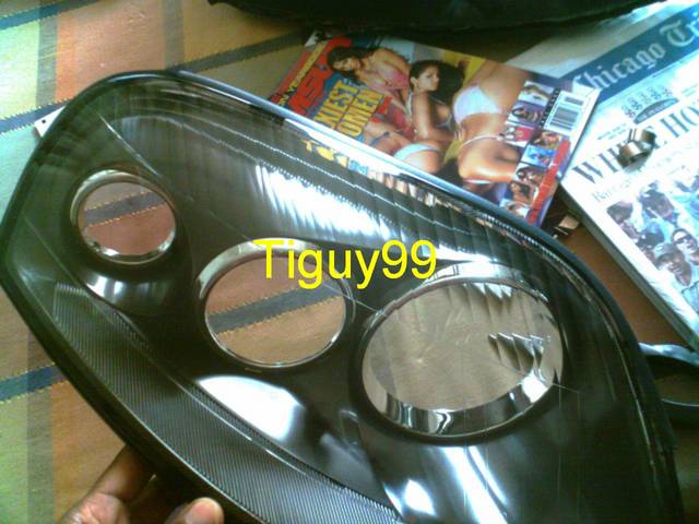

Never forget to remove tabs before you place the lamps in the oven!!!!!!

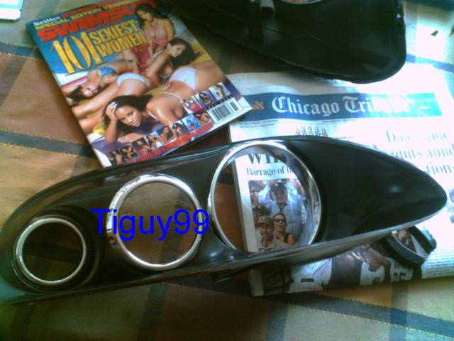

Pending Brian's approval, I may paint the Supra trims flat black vs the glossy black to reduce glare
Awe Lenses to die for lol!!!!

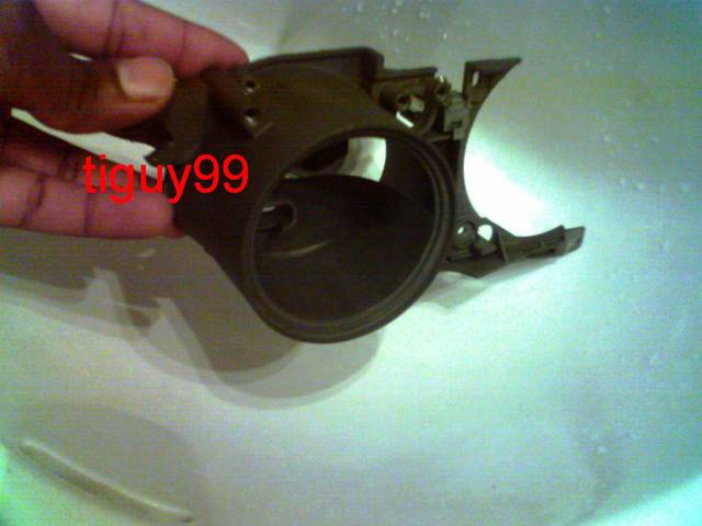

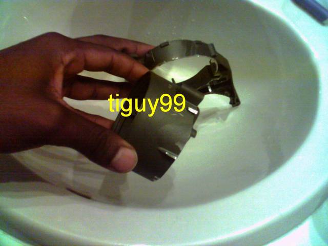

my hand's unintentionally covering the bottom part in this pic below

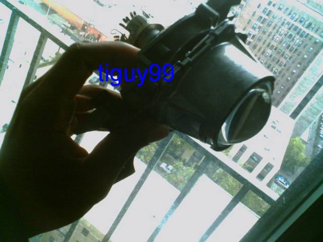

I'm holding both left and right projector cylinder assemblies off the SUpra in my left hand for illustration...
Now here's the short story. Last night I went out to test the Valeo Hybrids after I assembled them. Needless to say I'm both bitter sweet. MAd that I sold my last set but happy that someone else is gonna benefit from such awesome projectors.
I have a few shots but like I said my camera sucks. I'm gonna get the Sony on Sat. so at least I'll be able to show nice color shots when I hand these over to their rightful owner. All you TSX and S2000 guys watch out because there's a new kid in town and his name is Hybrid!!!!!
ANyhow the short story goes something like this, I spoke with the owner of the project I'm working on last night and he was concerned about cutting/modification of his lamps and was wondering if/why it had to be done. I explained to him that its a requirement and that I'm going to make it OEM stealth so that the only difference is gonna appear when he actually turns on his headlight to reveal his new HIDs to other Supra owners alike. Although he was still concerned, he explained that he's trusting in my judgement and has a good feeling its going to come out well. I also explained to him that this is the exact same lamp as the first gen ES300 (which he read about in my old thread a couple years ago)which was a pain in the **** to work on. I had to go as gentle as possible without breaking anything but there are times when brute strength is required to seperate certain pieces. (see links below)
