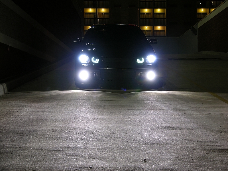

You can make your own, but what you can't tell from those pictures is that it's not actually very bright. Cameras never represent light the same way as the human eye. That DIY set up is only lit up by an LED.
The REAL Angel Eyes are the Gen V DDE. These use a ring that is a type of flourescent tube. These are way brighter and are still visible when the headlights are on.
The other thing is all the rings on Ebay and elsewhere are not the correct diameter to match the GS headlights. I have talked directly to one distributor who happens to be located in my area. I asked them why they didn't offer rings that are the correct diameter for the GS and they said they couldn't justify the cost to manufacture a new size. www.umnitza.com
The last time I spoke to Justin at Advanced Automotive Concepts, it sounded like he was still trying to get them made. It's been a while since I followed up with him, but I assume they have been finally released. He is the ONLY one to my knowledge that has the correct size, but there may be others.
So my point is, finding rings the correct size in the past has not been that easy. You can't just get BMW or IS300 rings on Ebay and adapt them.

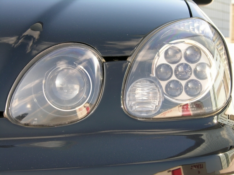

The rings for the bmw and IS are really small. The IS rings just happen to fit perfect around the q45 projector and the small IS one around the e39 projector. If you have a stock GS headlight you will have a hard time trying to mount the small rings around such a large reflector.
