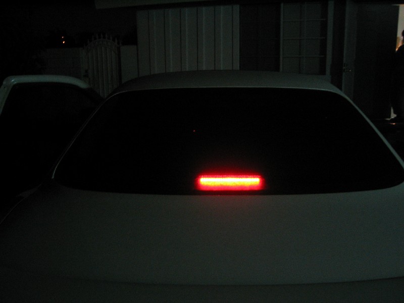

In case you guys don't check out the SC forums, I have retroed an LED into the 3rd brake light as an alternative to the stock halogen light. It gives the GS, LS, or almost any Toyota based car an option of doing this. I did it in 30 minutes too!

Mind telling us how you did it?? How about a DIY??

I bought an led strip, dremeled it to fit, wired it in, and epoxy glued it down. Took 30 minutes.

Do you have a pic of the LED before you put it in?...............MIKE

http://i4.ebayimg.com/02/i/01/76/26/b0_1_sb.JPG
It's the ones they use for RVs.

Not bad looks good..............Now find a very thin white with yellow LED's and we can make some turnsignal mirrors......Mike
