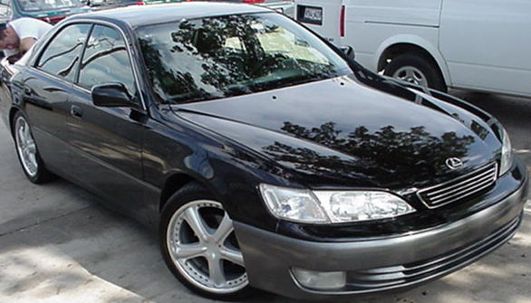

Ta ta ta tahhh!!! ! Guess whos bacc!! LOL just joking. After reading the posts I can take a stab at it. IF you have the ES from the 2000 model year, your headlights are the reflective type bud. This simply means thatyou have a couple options adding Xenon to your ride. Your lights look like these right?
If so, to add HID in the easiest way, just grab an H7 HID KIT like cheapsk8 mentioned before and you're all set. Make sure that you get either 4100K variety or even 6000K is fine. The numbers stand for color temperature and not how bright the appearance is. So make sure BEFORE you buy that you understand that 4100K is the factory setting for ALL cars that come equipped with HID. 6000K is supposed to be for show but because of the popularity of the color temperature, its the highest legal color you can buy in regards to HID. Buy only Philips or Osram bulbs. Remember, there's a ban on HID Kits sales as of August 2003. Some vendors still sell them, I'm pretty sure some folks here know where to get them. Ask around.
This method of HID upgrading is the simplest and that's why I recommend it. Make sure you get the proper kit meaning H7 in your case because its really important that your new light bulbs matchup in the exact spot the old ones did. Other than that, the whole process shouldn't take any more than 30-40 mins on your first attempt. Ask away if you have any other questions. And take pics with your regular cam than have them scanned at walgreens and upload them here at Kinkos or whatever big photocopy chain exists near you.
