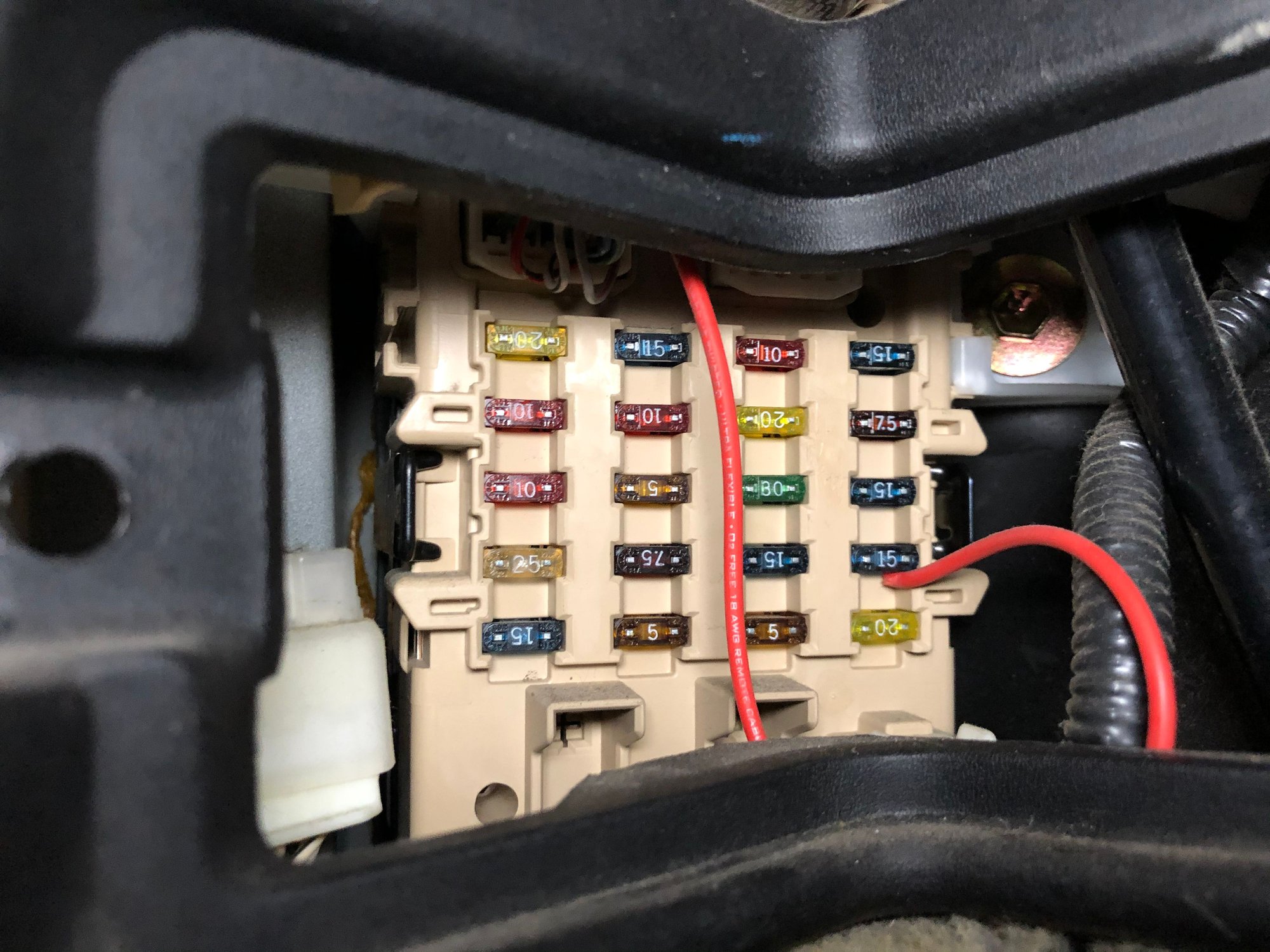

What type of fuses do these cars (1998 GS400) have? I need to purchase two fuse taps to hardwire my dash cam to two of the fuses in the fuse box near the drivers feet.

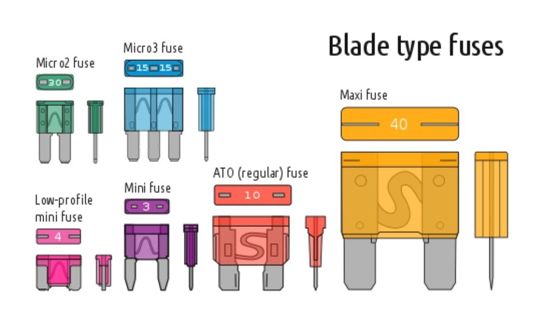

Mini fuse is what it takes.
