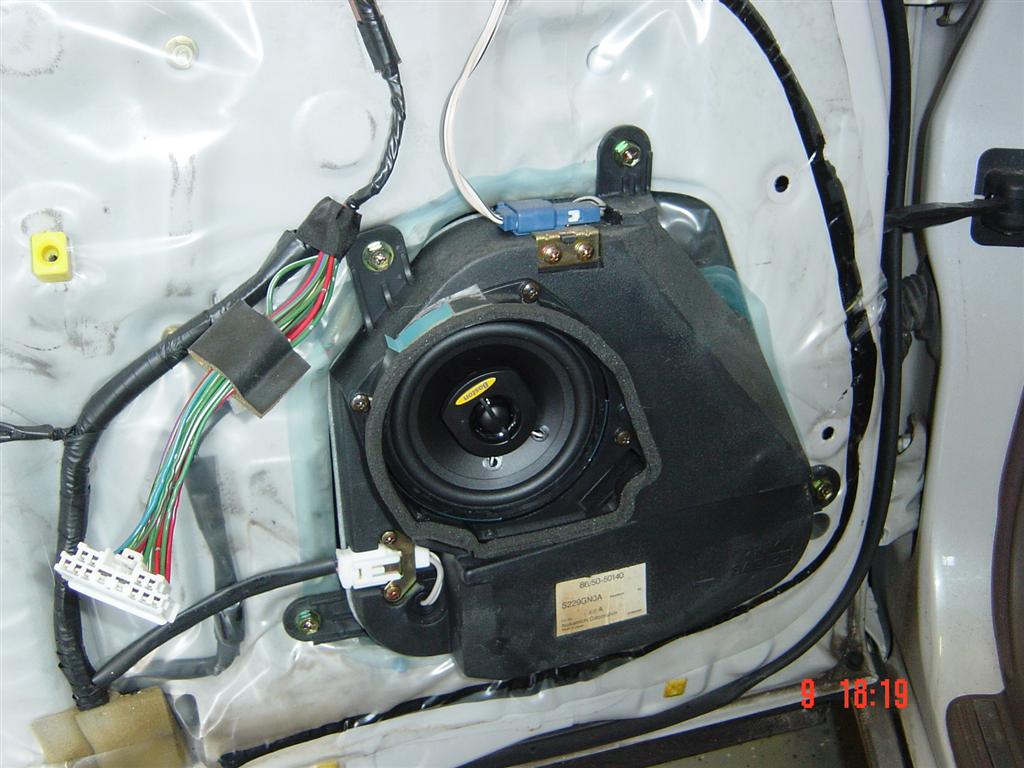

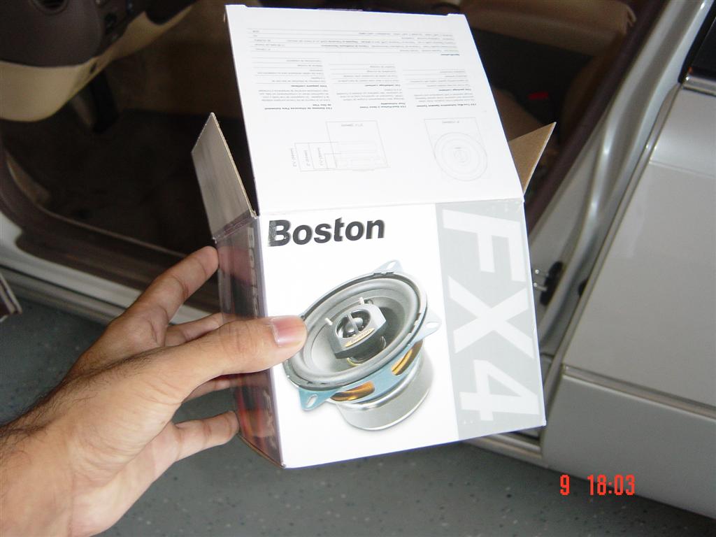

These are my new front speakers that operate at 4 OHMS. I'm an idiot and I just got what the tweeter guy told me was nice! I think they are handsome speakers don't you think? At least the box anyways. It's a 4" coaxial.

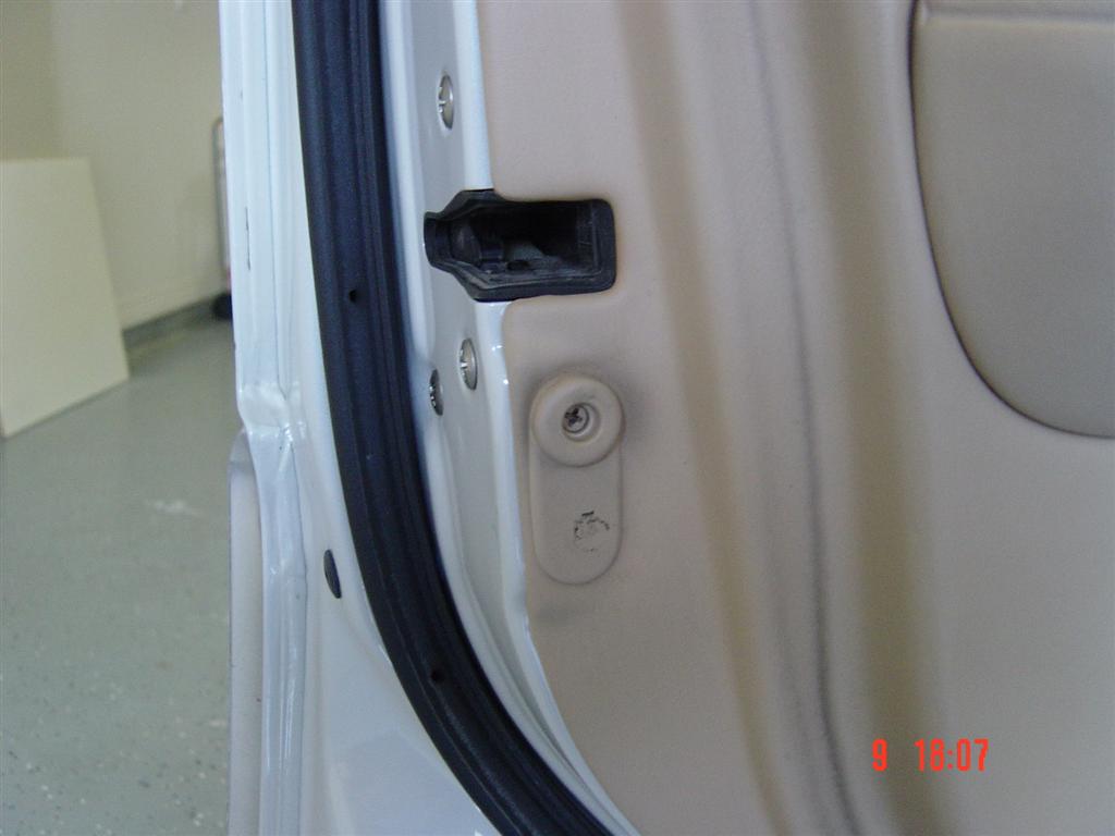

Sorry I kinda jumped a section, what happened here is you put a flat head screw driver between the door handle and the edge and push the frame out a little bit. Same with the top between the door lock and the frame and push the frame (or squeeze a better word?) out a little more and then you open the door handle so the entire frame comes out. It's not that hard to do but you have to have patience otherwise you'll crack or break your frame. Just use some common sense while doing this part to get the studs out of the holes. To be a little more clear, what you are trying to do is lift the frame so you can pull it over the door handle and lock.

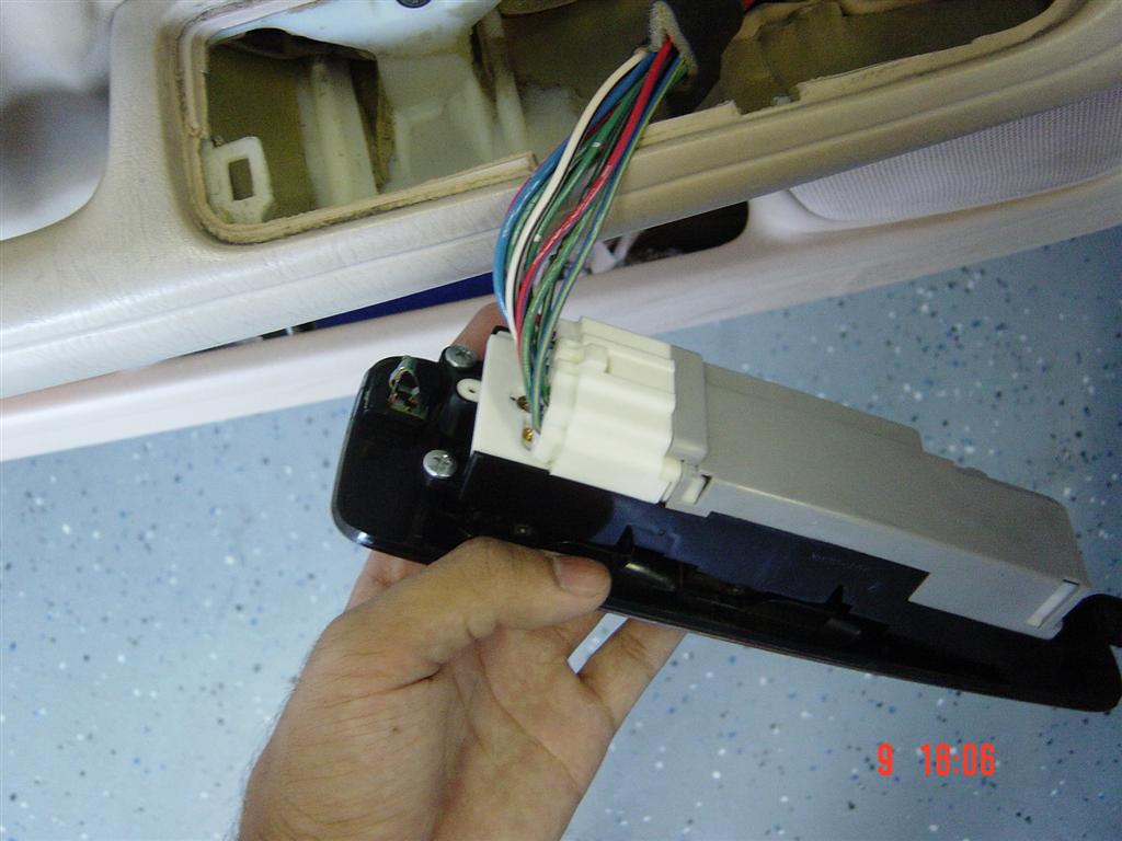

Now I'm stupid. I should've taped my flat head so if it slipped it wouldn't have scratched. But I didn't slip, so this time I got lucky. Just slip the flat head under the wood trim that has the window switches and doorlocking button and snap it out of place. It'll slide backwards out.

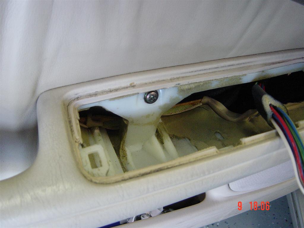

Sorry for the flash yall, but on this picture, you need to to see the recessed screw deep in the door handle. Just get underneth to see this and take it out.

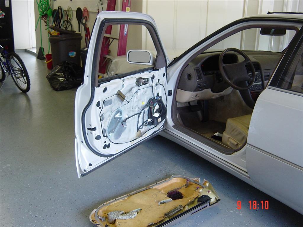

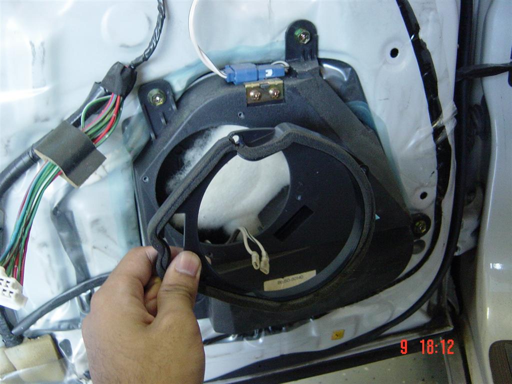

Back to the door. As you can see you have to take off the frame first before you remove a speaker. Mind you I had my speakers removed BEFORE I did this as I have taken my door panels apart many times. There are four screws to do this. It's simple.

The frame and the four screws.

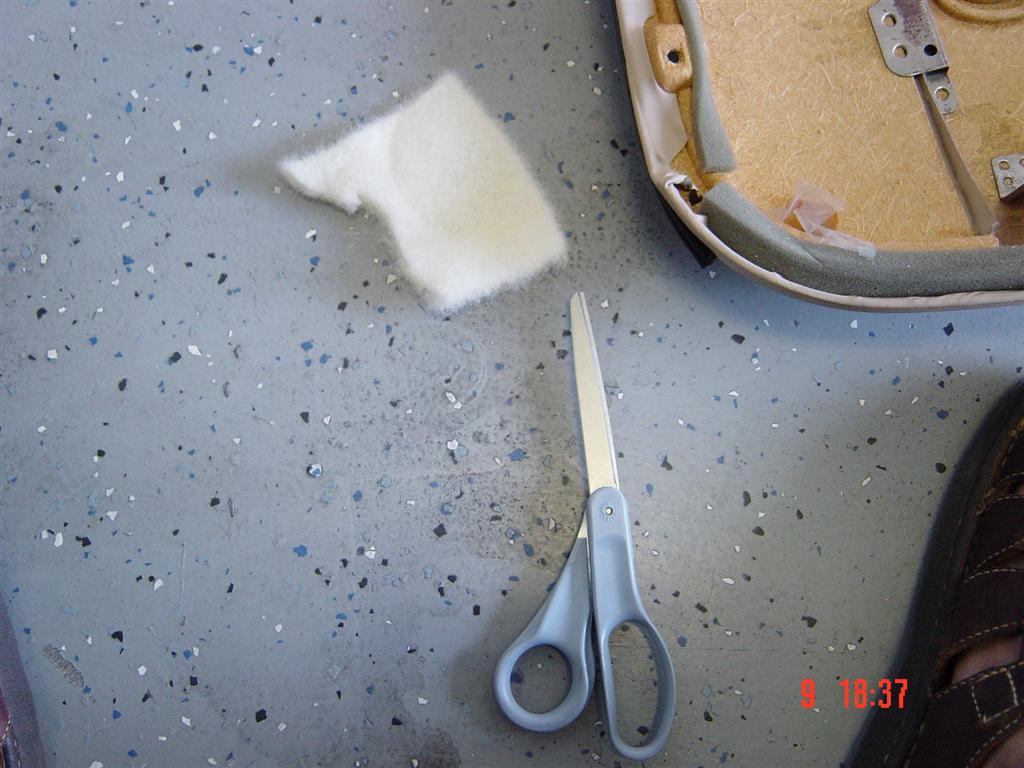

Houston (get it? I live in Houston!), we have a problem. Actually not really. It's just this padding what two fold and a little bit too thick to have my speakers screwed in perfectly. I could have done it without any mods but I didn't want to so on this door I refolded it and smushed the remaining padding in and on the passenger side I was too lazy so I just cut it off.

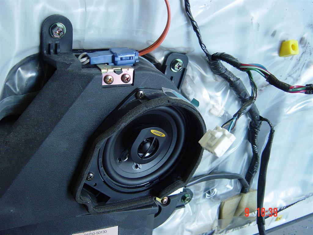

Here is the beauty installed. Random credit goes to kaosmoon for assuring me that the speakers I bought are in fact decent and not "crap" as I thought they would be I love you man!

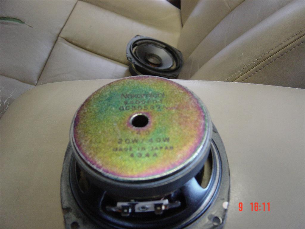

The two speakers I removed, as you can see they are 20W / 40W @ 4OHMS. I'll miss these.

A rought outlook on how much I cut on the passenger side from the padding.
Speaker installed! Check that sweetie out.

Those are Boston Acoustic FX4's as seen in the first picture.
Front and rear speakers on OEM Nakamichi are the same 20W/40W 4ohms 4" except for the fact that there is a component setup in the front.
Now my car has Boston Acoustics for the front and OEM in the back (including woofer).
