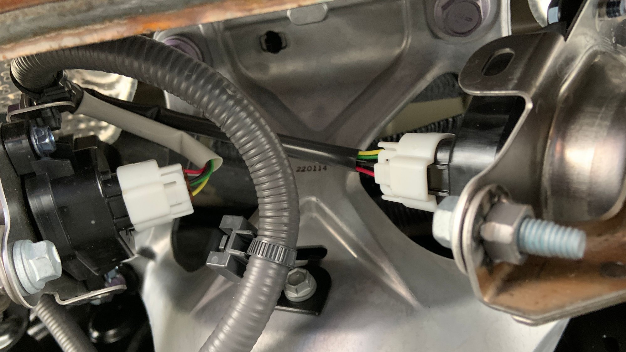

I’m sure it’s already posted somewhere here. But I found this video on YouTube and applied it to the vert today. Easy as unplugging these two connectors here
sounds fantastic all the time now.
Just unplug the two white connectors. I then tapped up the ends with electrical date and strapped them to that grey wire

how come you don’t like it ? I only took it for a short ride and I’m already in love. Before it felt very dead under 3000rpm.

I tested them out even 3 times on 3 different days and same weather condition ( Cold @ 50 F ). Yes, you will have aggressive exhaust sound in 3k to 4k rpm. But you will LOOSE the pops in the exhaust in 1st, 2nd and sometimes 3th when you shift at 5k rpm.
