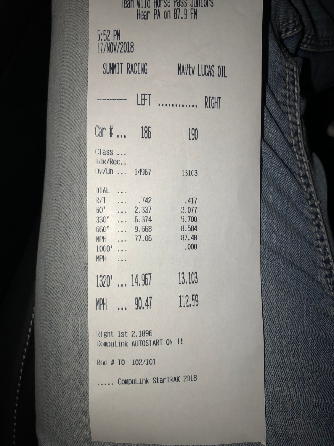

First time at drag strip car #190 in right lane here. As you can see the 60ft is just over a 2.0 and I did a best of 13.1@112. I was initially discouraged but after seeing the weight of the car and taking into account that I'm on 21" wheels with pretty much the best all season tire you can get, I felt a little better. I ran the car in auto with TC off with it on, ran it in manual with TC off and on. No burn out, then burn out and even ran the rear 21" tires at around 25psi for better traction. I think with better track conditions and some stickier tires I can hit 12.8 or even a 12.7. Not sure but I may have the world record for the fastest LC500 ROTFL unless Car & Driver has a time slip to substantiate the 13.0@109 they claimed to have achieved.

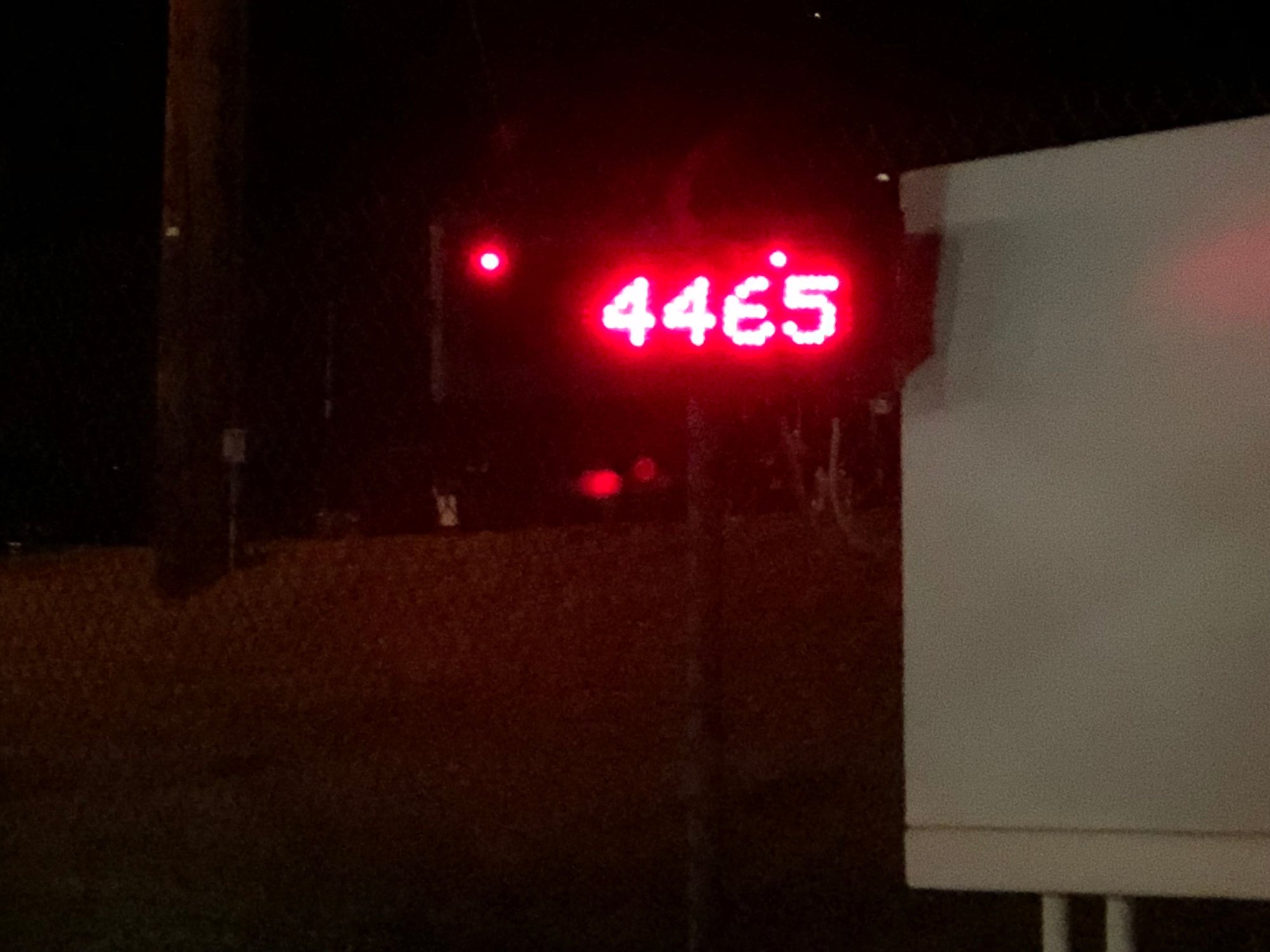

As you will notice the photo below the time slip I weighed the LC with me in it on 1/8 of a tank and it was 4,465 lbs.

I for one appreciate all the testing and pictures / dyno graphs you have been posting up. Going to be hard for this car to actually be quick in a 1/4 mile without some serious power mods due to the weight it needs to over come. I believe without a s/c or nitrous it will be hard for the LC to break into the mid 12's with a decent trap speed consistently. Then again just my opinion. Im going to wait for the LCF or the RCF GT to come out before I start touching anything with the motor.

Not really. I hit a 13.1 on 21" Pirelli P Zero so simply putting some forged monoblock 20" wheels on wrapped in a set of Toyo R888R's would drop that time down to a 12.7-12.8 easily. Also I discovered a way to completely turn off TC and all driving assist in order to stall the converter off the line as a simulated launch control that should drop another .1 or .2 as well.
