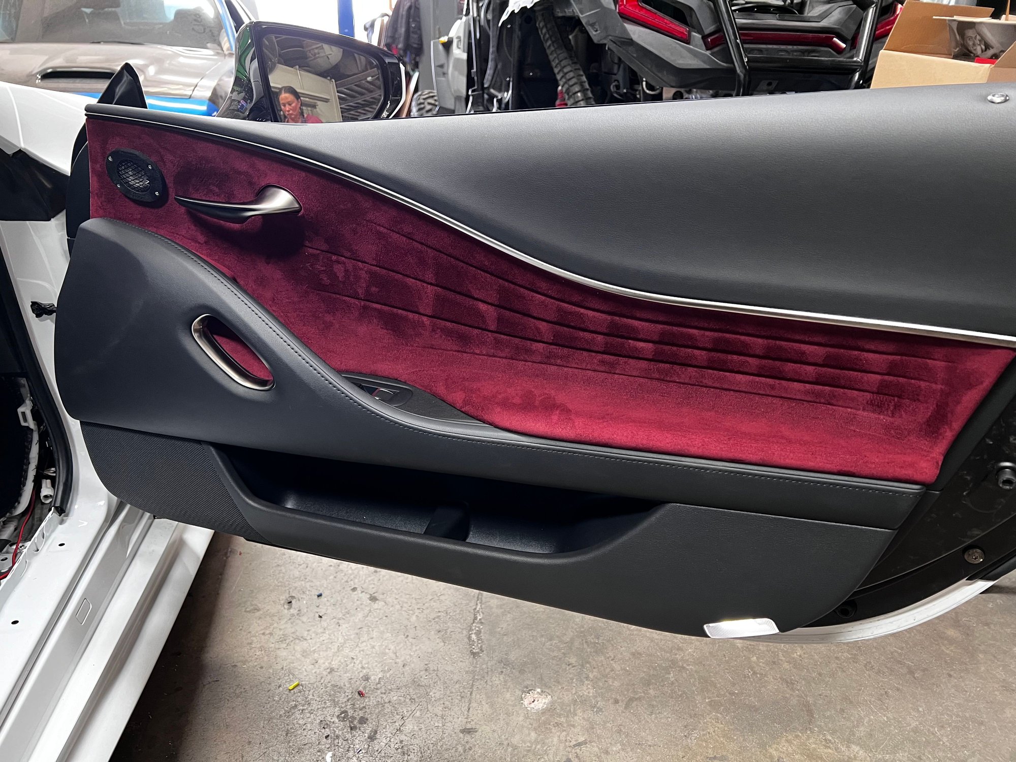

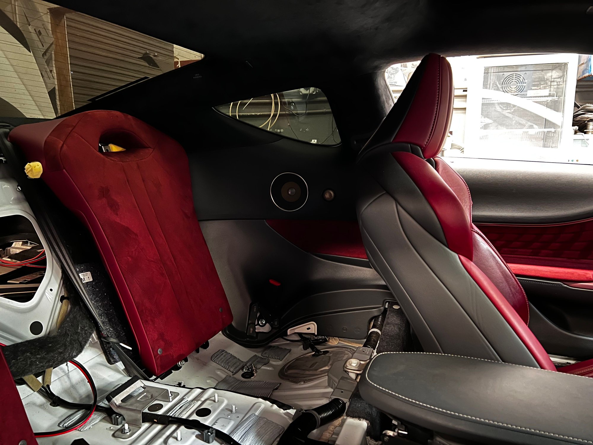

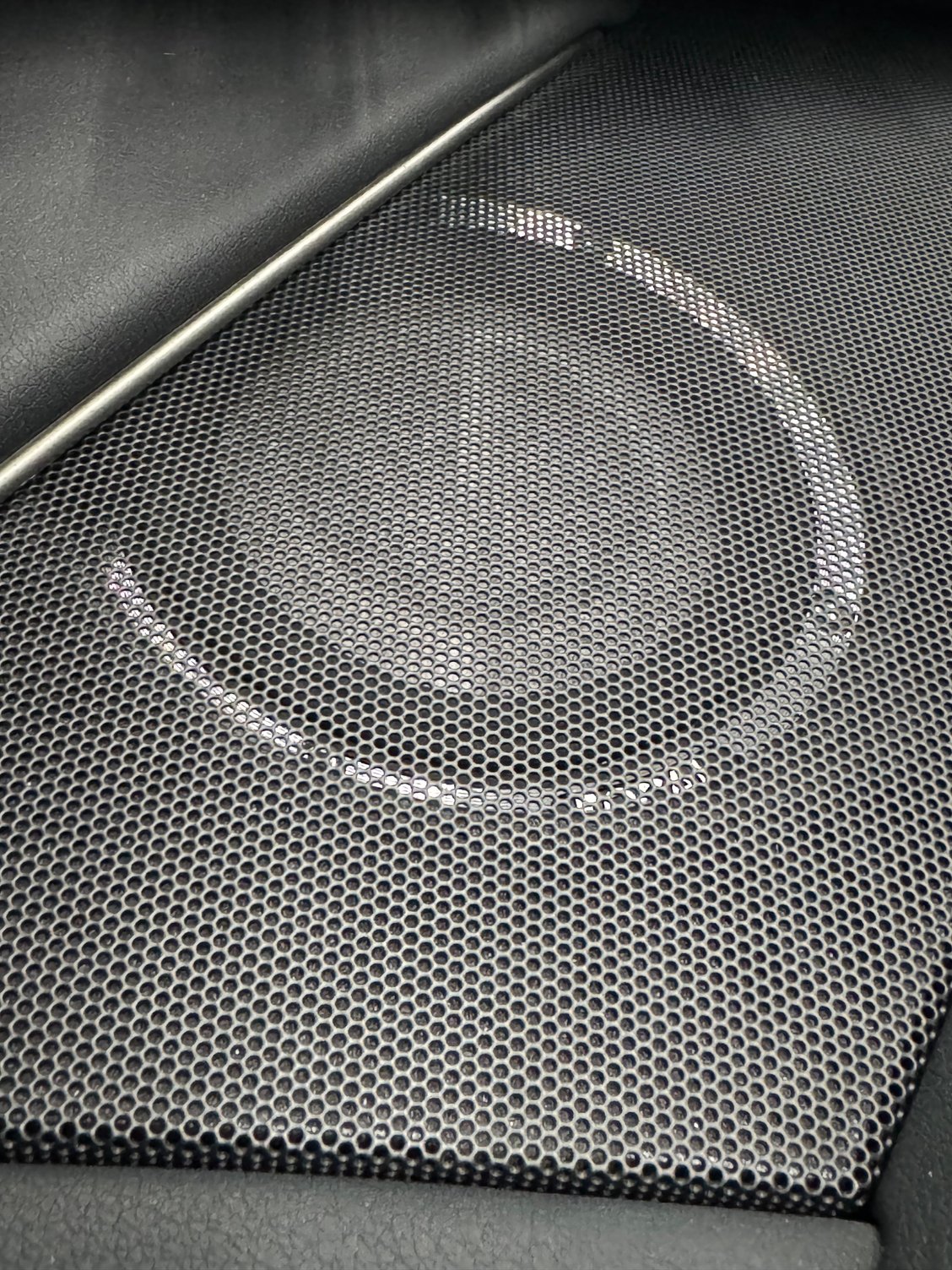

As I've spent the last two years transforming my LC500 into how I personally want it to look, I went ahead and ripped the entire sound system out as I found the sound quality in the LC500 terrible. My wife has a 2016 Lexus RX350 F Sport and the audio in that is 10 times better than the LC500.
For the front speakers I have a 3 way Focal Utopia M set up with 6.5" in the doors, 3.5 mid range in the left and right dash, and Beryllium tweeters installed in the doors running in an Active Crossover. For the rear speakers I I have Focal ES 100 KE 4" component set with tweeters in a passive crossover. I replaced the factory subwoofer with a single 8" JL Audio W7. All kids and highs are powered by a Mosconi Pro 8 | 30 DSP Amplifier with a single Mosconi Pro 1 | 1000 amplifier for the subwoofer. The majority of the car has sound deadening and I have to say with all the cars I've tweaked over my life, this is the best sounding audio system I've ever had. The 8 | 30 Amp has a built in DSP and this thing has been tuned for the best audio quality possible. The clarity and volume you get out of this thing with zero distortion is amazing. Below are some pictures.
This is in my 2019 Lexus LC500. I see I havent updated my signature on here for quite a while. I'm not on here much, but if you have any questions feel free to hit me up on instagram. @melymel_96

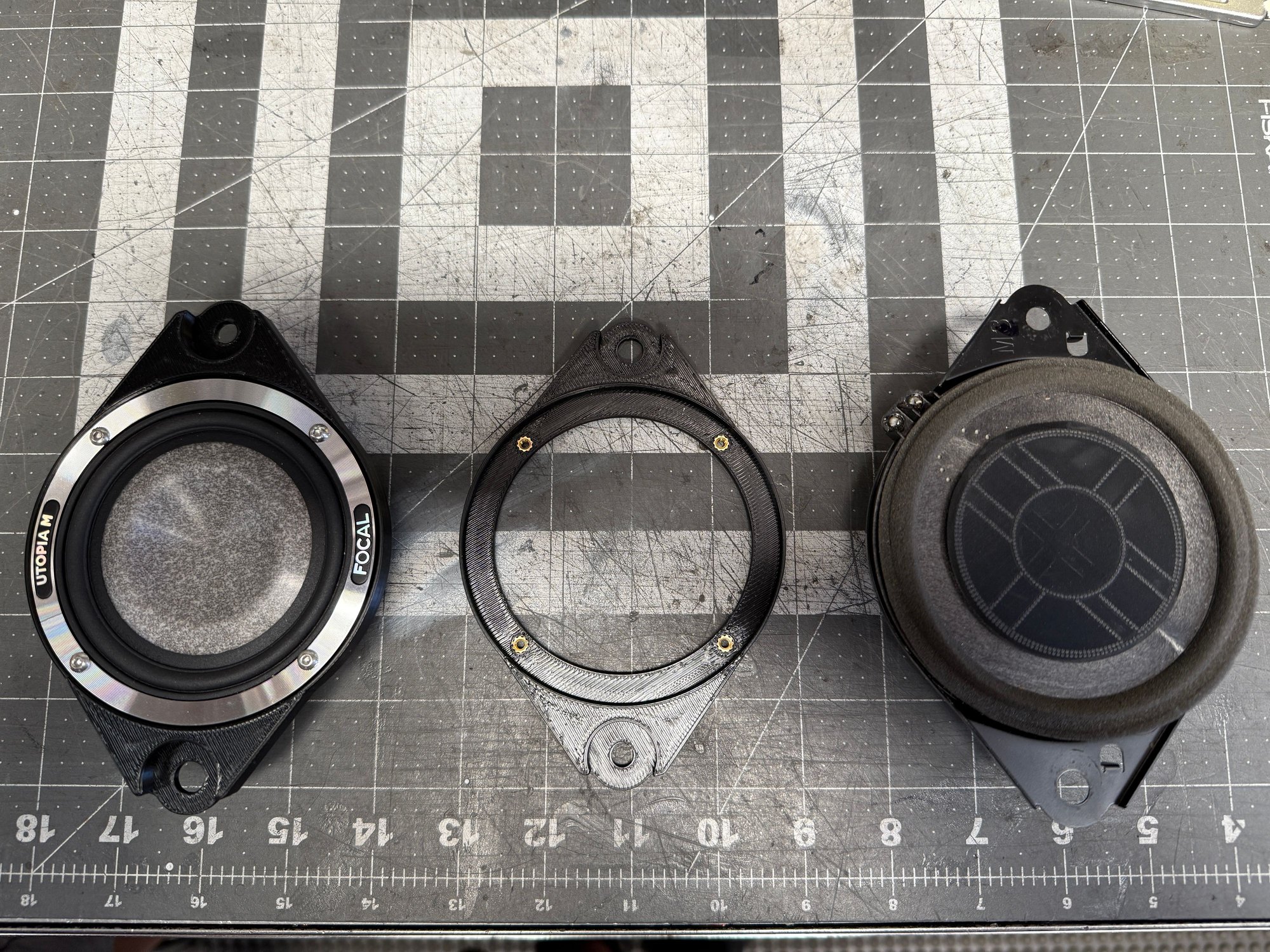

Focal Utopia M 3.5
Focal Utopia M 3.5" drivers with 3d printed mounting brackets.
3.5
3.5" Focal Utopia M in dash

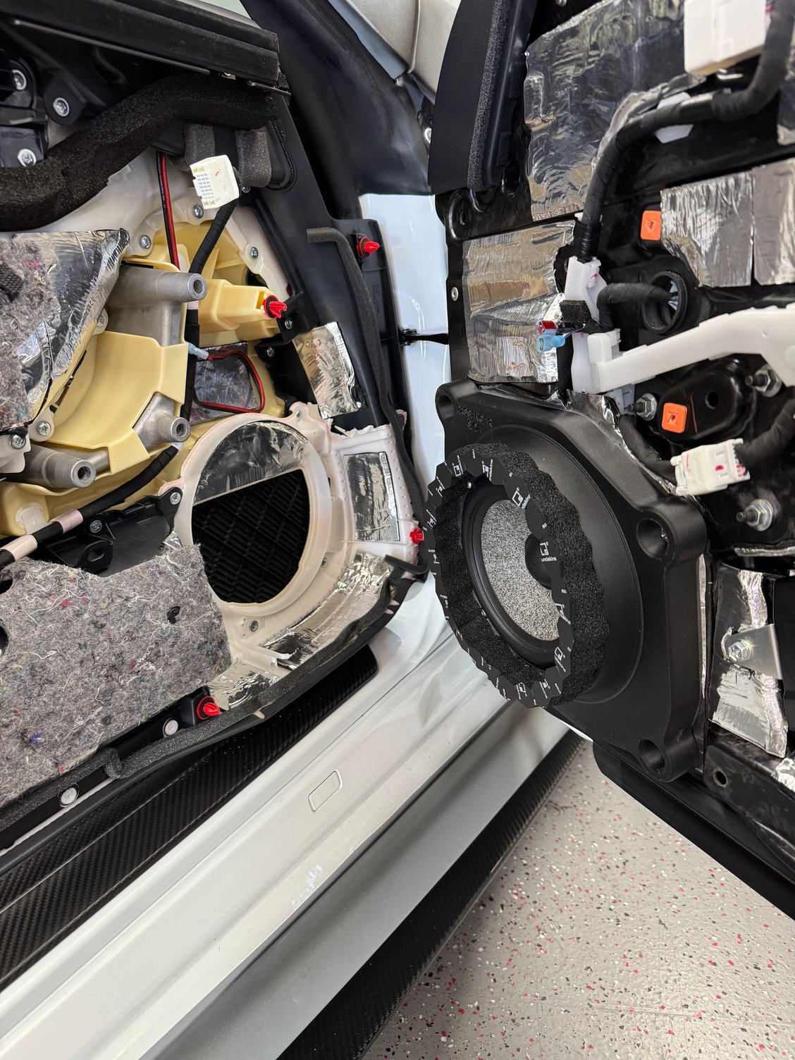

6.5
6.5" Focal Utopia Speakers.
Sound deadening
Sound deadening
JL Audio 8
JL Audio 8" W7

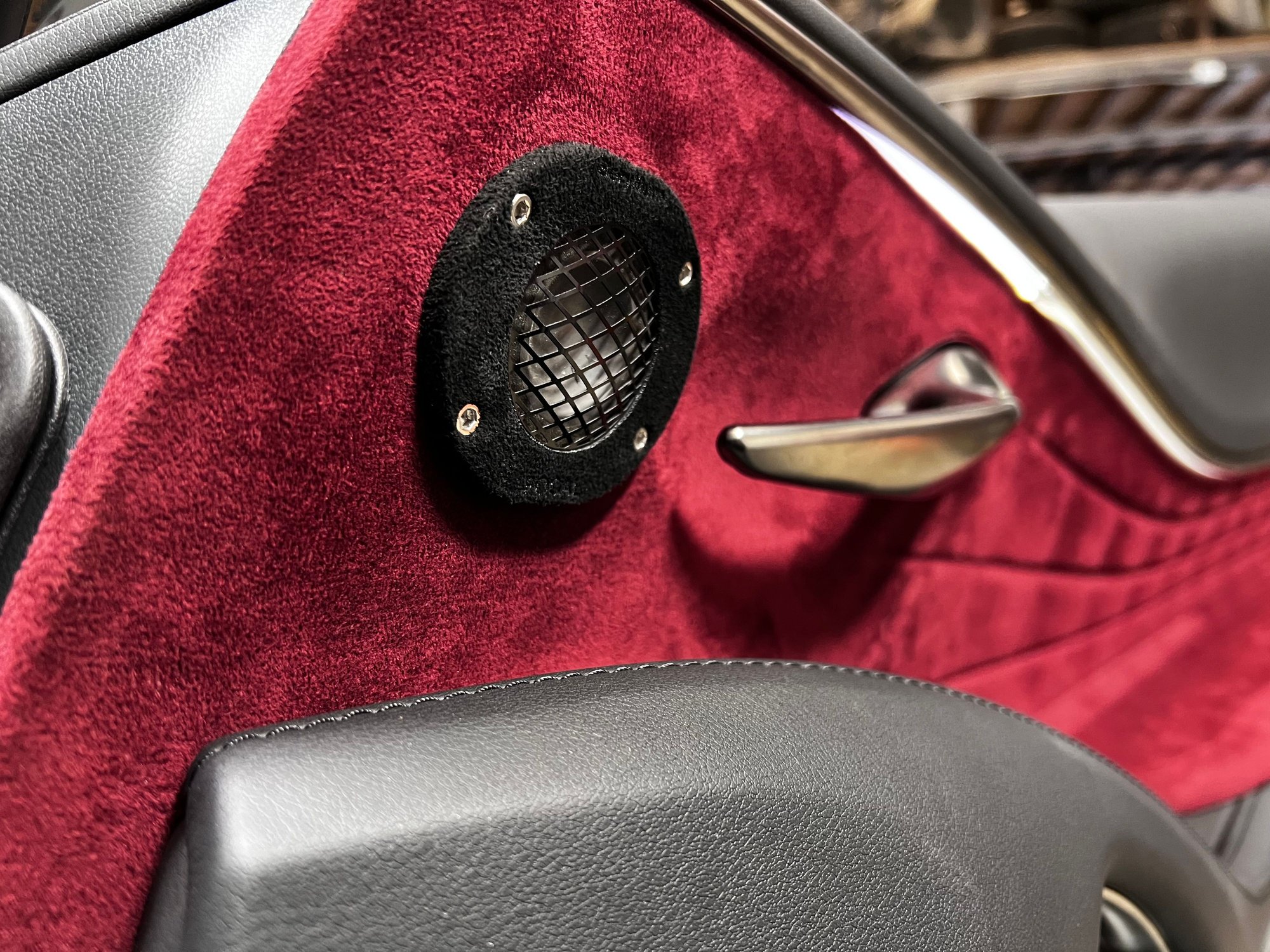

Focal Utopia M Tweeter wrapped in black Alcantara and Focal logo burned into Alcantara
Rear Focal ES100 with 4
Rear Focal ES100 with 4" Driver with Tweeter

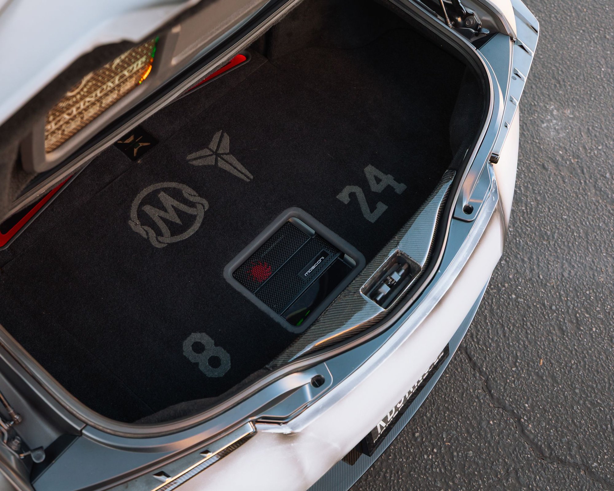

Mosconi Pro 8 | 30 with built in DSP
Mosconi 1 | 1000
Mosconi 1 | 1000
