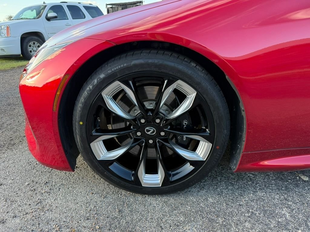

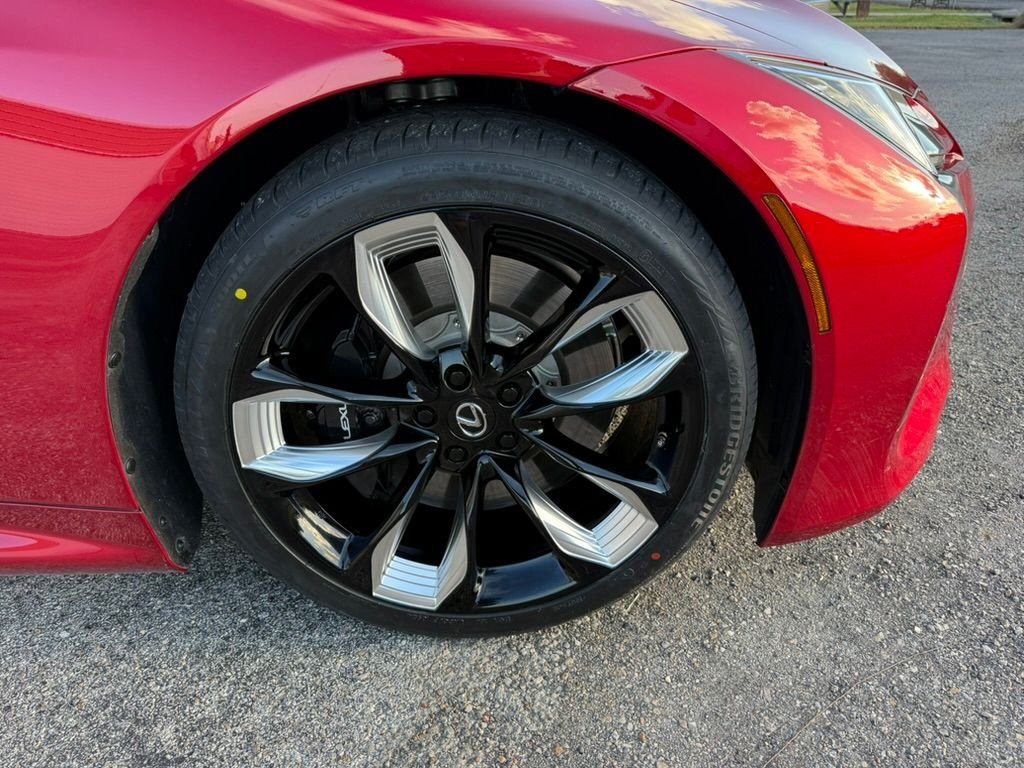

Default changed out black to sliver lugs
2024 wheel with black lugs
changed black lugs to silver and it makes an improvement in my opinion at least.  not so black in the center is better...

So new wheels can fit lug nuts I wonder if old wheels can fit lug bolts too.

This is a quote from his other post. Don’t assume ‘24+ MY LC500 bolts will take previous MY wheels. They likely will not as the surface of the lug holes is different.
Originally Posted by michaelacc
I have a 2022 LC convertible. I purchased a set of Lexus OEM wheels from the 2024 model (silver on mostly black) from Japan. Turns out these Japan Lexus OEM wheels were mounted with ball/radius seat lug BOLTS unlike existing OEM flat base lug NUTS. I had to purchase (not too common) M14x1.50 thread ball/radius seat - 19mm hex to properly mount. It was successful but unexpected. Not sure why the difference with Lexus OEM except I guess Japan market is different standard than US.

I'm surprised the '24 wheel looks sooo different with just the color "inversion"; and yes, they look simply awful IMO.
Wheels are such an individual preference, but these, c'mon man.
