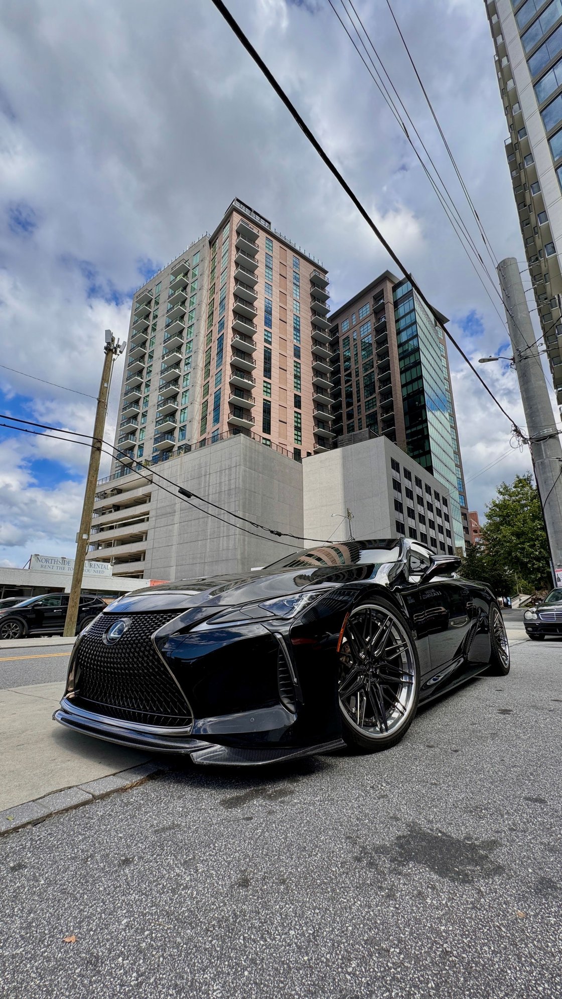

Originally Posted by iamnaeem
I've been looking more into suspension setups for my LC so I thought I'd share what I've come across.
I tested one of the cheaper options first, RS-R springs. Saw zero need to go any further. Gave me the exact height I wanted and the car drives beautifully.
I just got a 2021 Convertible and my experience is that suspension is on the soft side, leaning over quite a bit in corners, except when in Sport +/+ but even then still leaning too much
What is your experience performance-wise with the RS-R springs?
