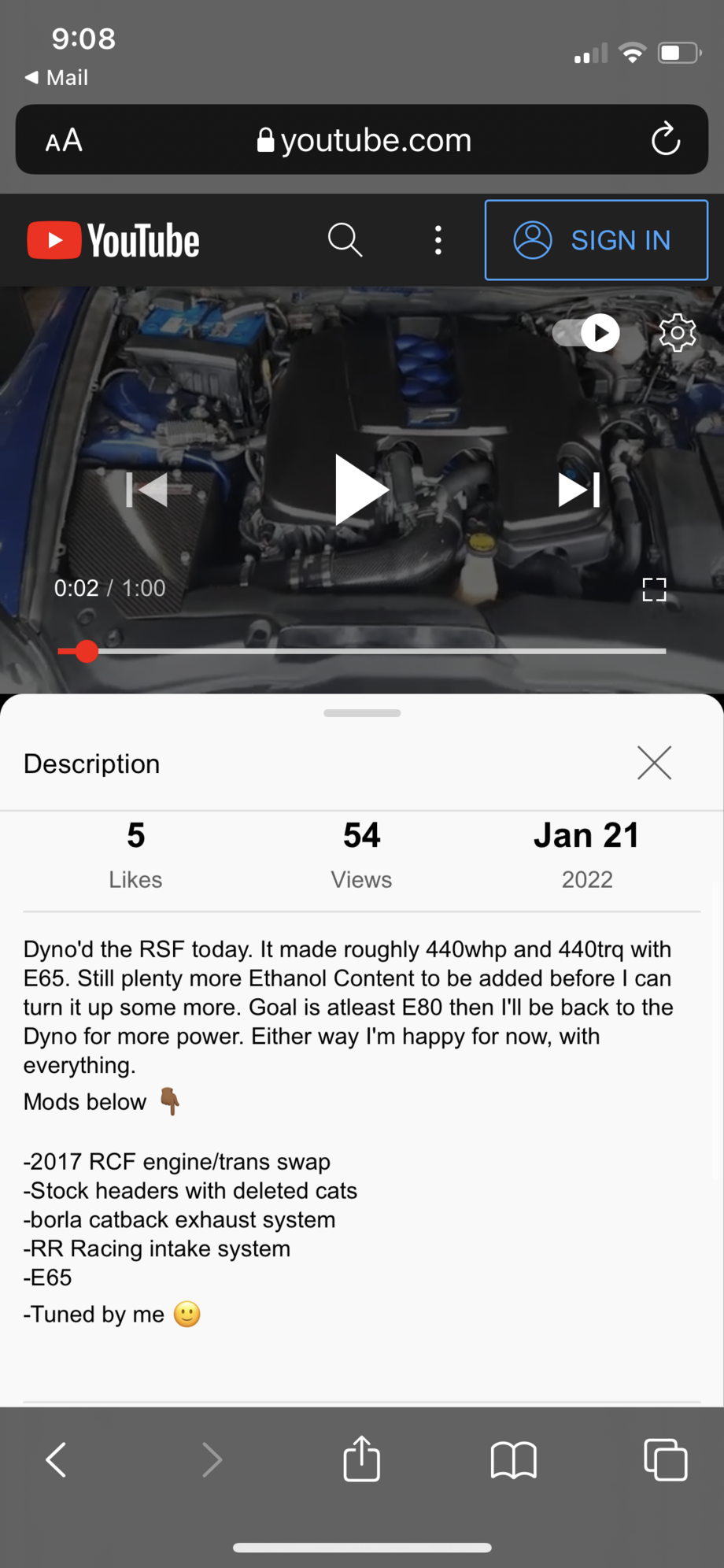

^^^^In case you have trouble reading the results:

Nice catch! Couldn’t make it out on my phone. Need to message him on YT and see if this was one of the first pulls or if it was the one when he did 440whp and 440 torque as listed on his video.

This makes me question if using the ISF Ecu is such a detriment. Those are pretty solid numbers. I wonder how his A/F ratio and timing is, looking for any indication the Ecu is holding it back.

Is he FBO as well? Or just RCF motor and intake?

He used to be boosted, so probably at least header and exhaust. Sounds like maybe oem ISF tune.

Gutted stock headers, intake, exhaust, E65
