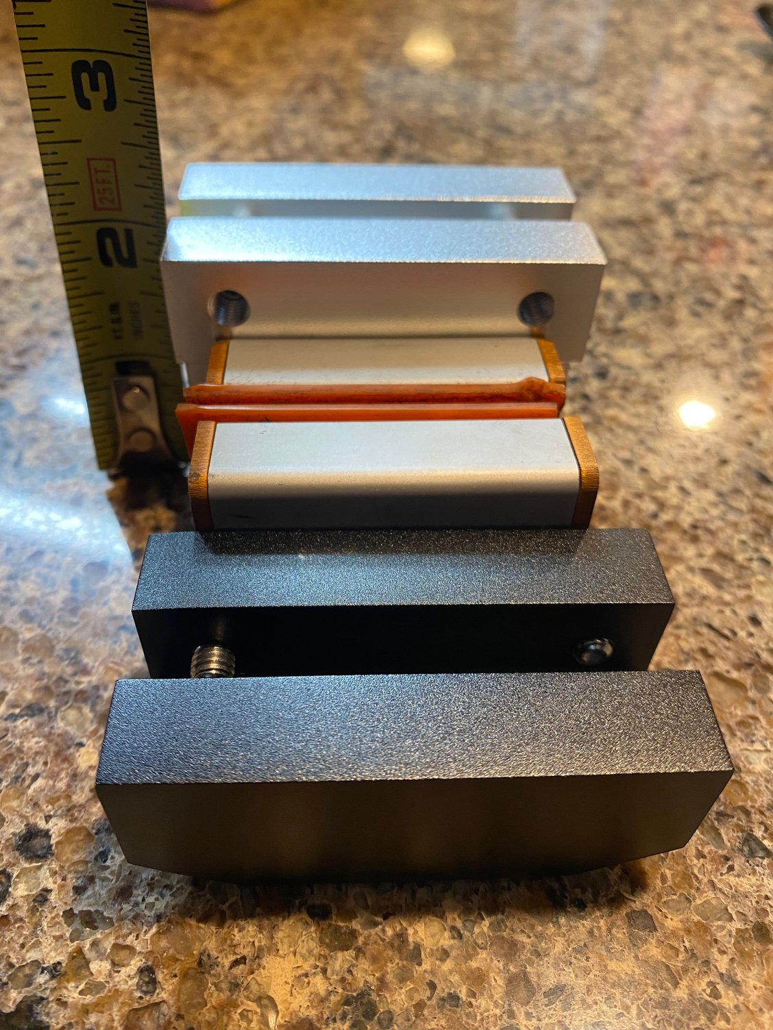

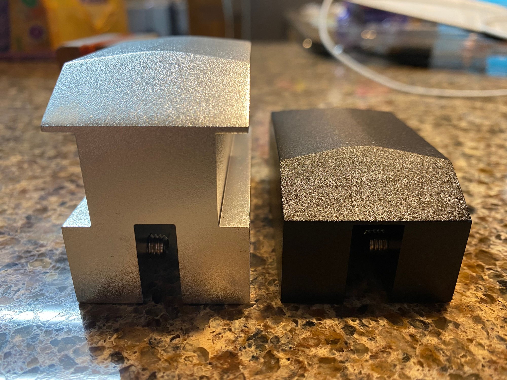

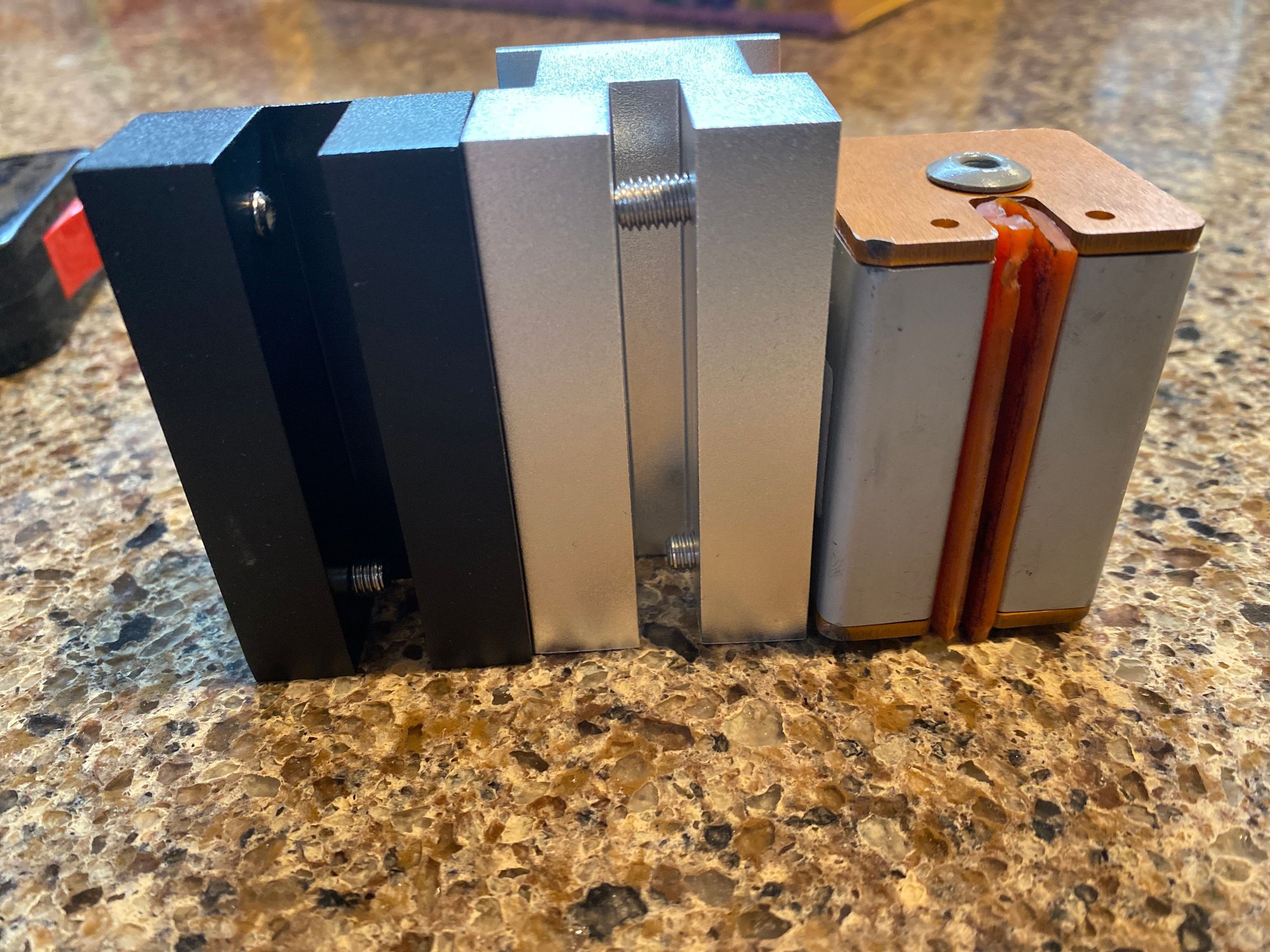

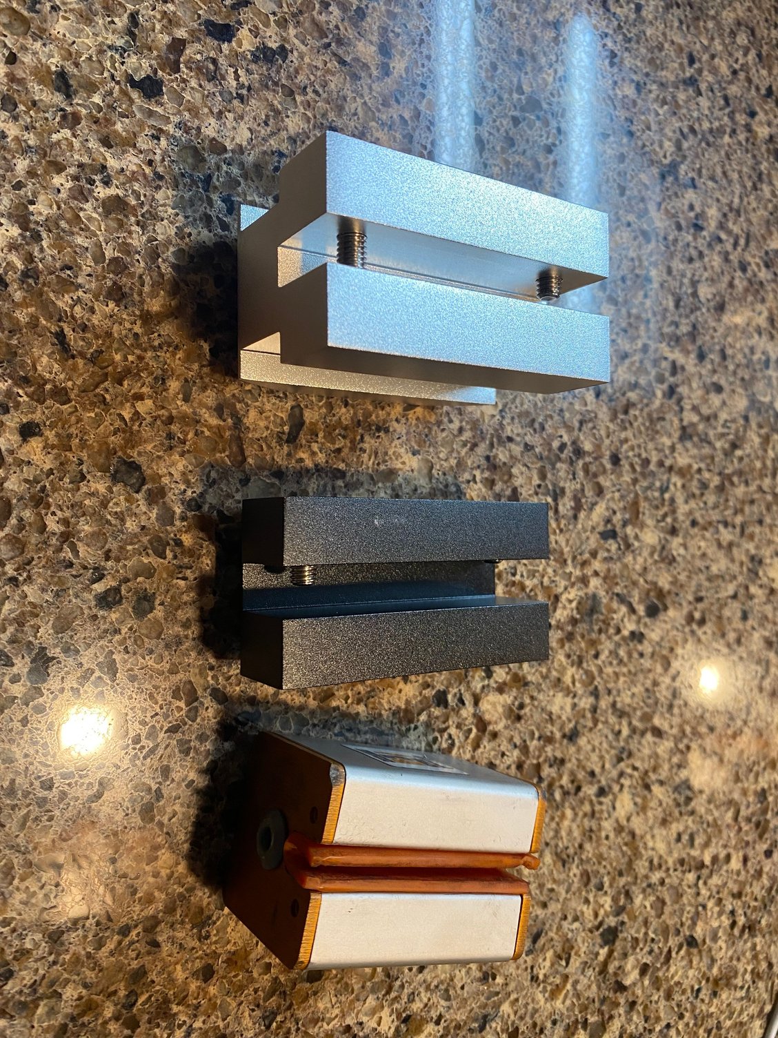

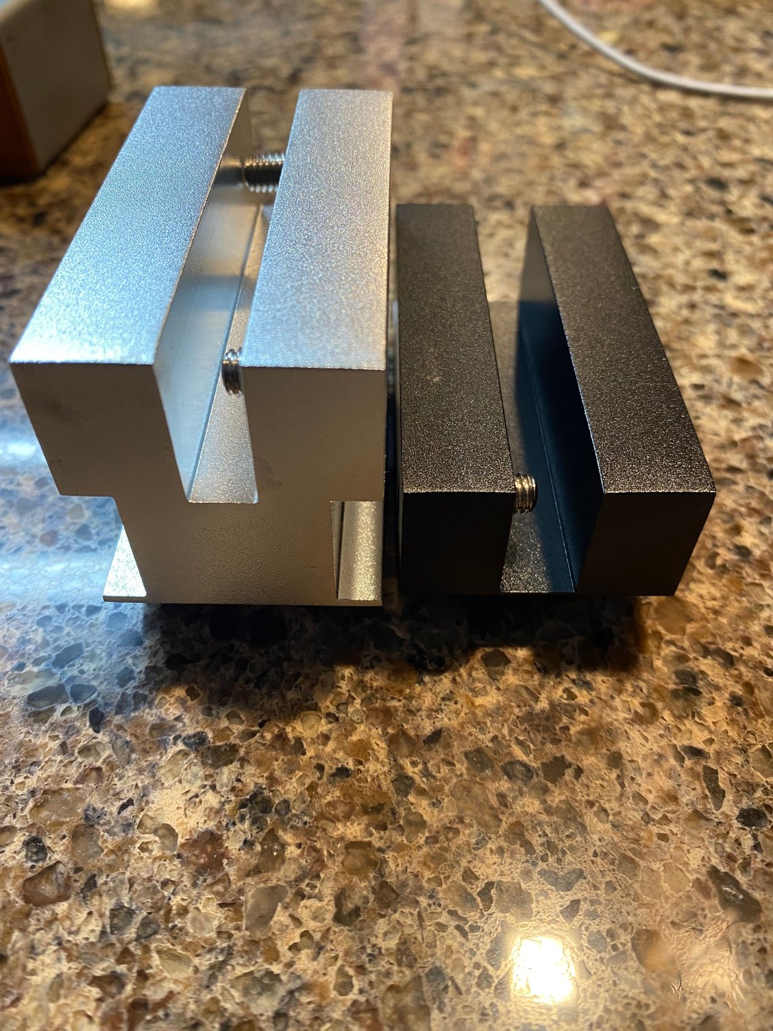

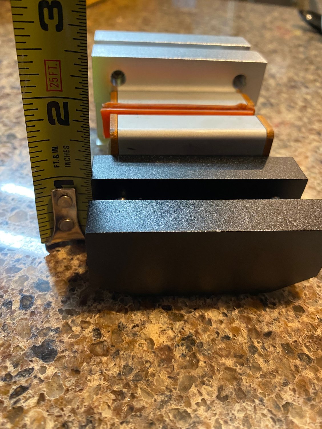

Below are three products to solve this issue. I won’t cover the Figs piece, as we all use and love it. I’m just tired of not having a permanent attachment, so I bought two different sized Dewhel units.
The taller silver piece is for a 6th Gen Camaro. The smaller black piece is for a 5th Gen Camaro.
The channels in the figs and 6th Gen piece are the same width, at slightly over 5/16”. The channel in the black 5th Gen piece is wider, at just a hair under 7/16”. I really wish these came with narrower channels. I’d prefer to borderline compression fit them with some form of permanent epoxy, but that won’t happen with these pieces.
The channels in the Dewhel units are substantially deeper.
I need to move my garage heater before I test these in a car, so that is soon to come. I’m installing hardwood throughout my home, so everything is out of place it seems. Update soon.
Final note, the Dewhel units offer more contact patch, as they are around 1/2” longer.
