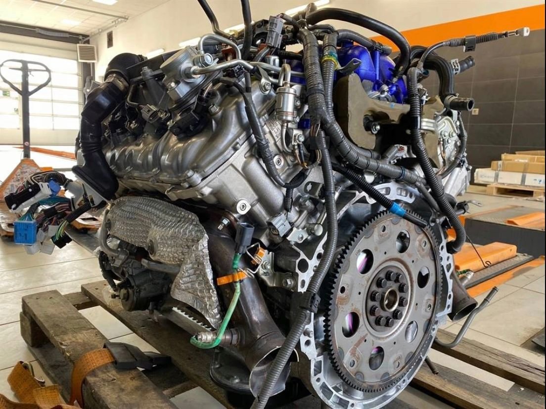

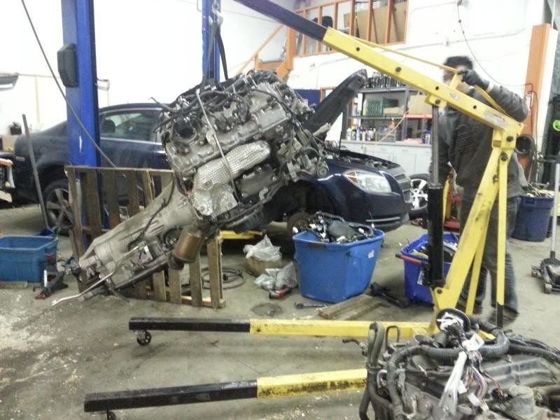

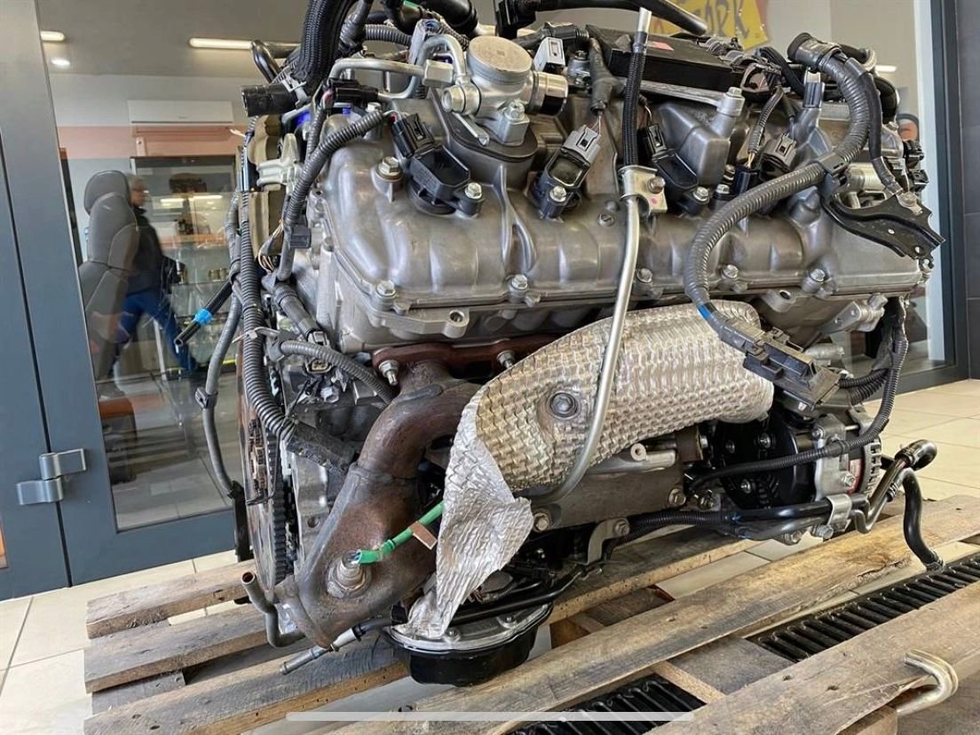

IS F motor & trans
RC F motor - CAT cut off after A/F sensor
Joe Z

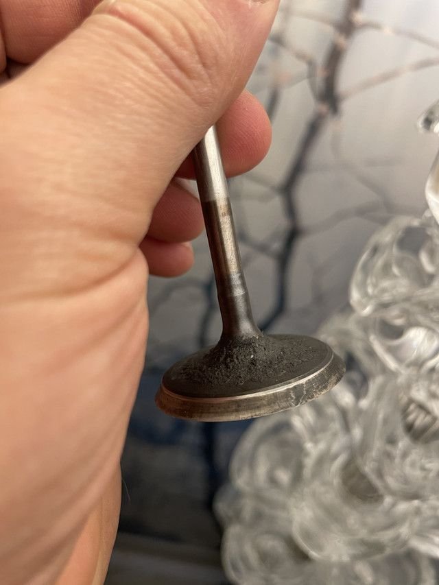

new one \ old one

look
may be this is carbon piece or another mechanical damage?

Originally Posted by Faaith
look
Were the plugs on 7 & 8 wet with oil from the tube channels??
For the one’s your keep seeing damaged the same way…
Joe Z
