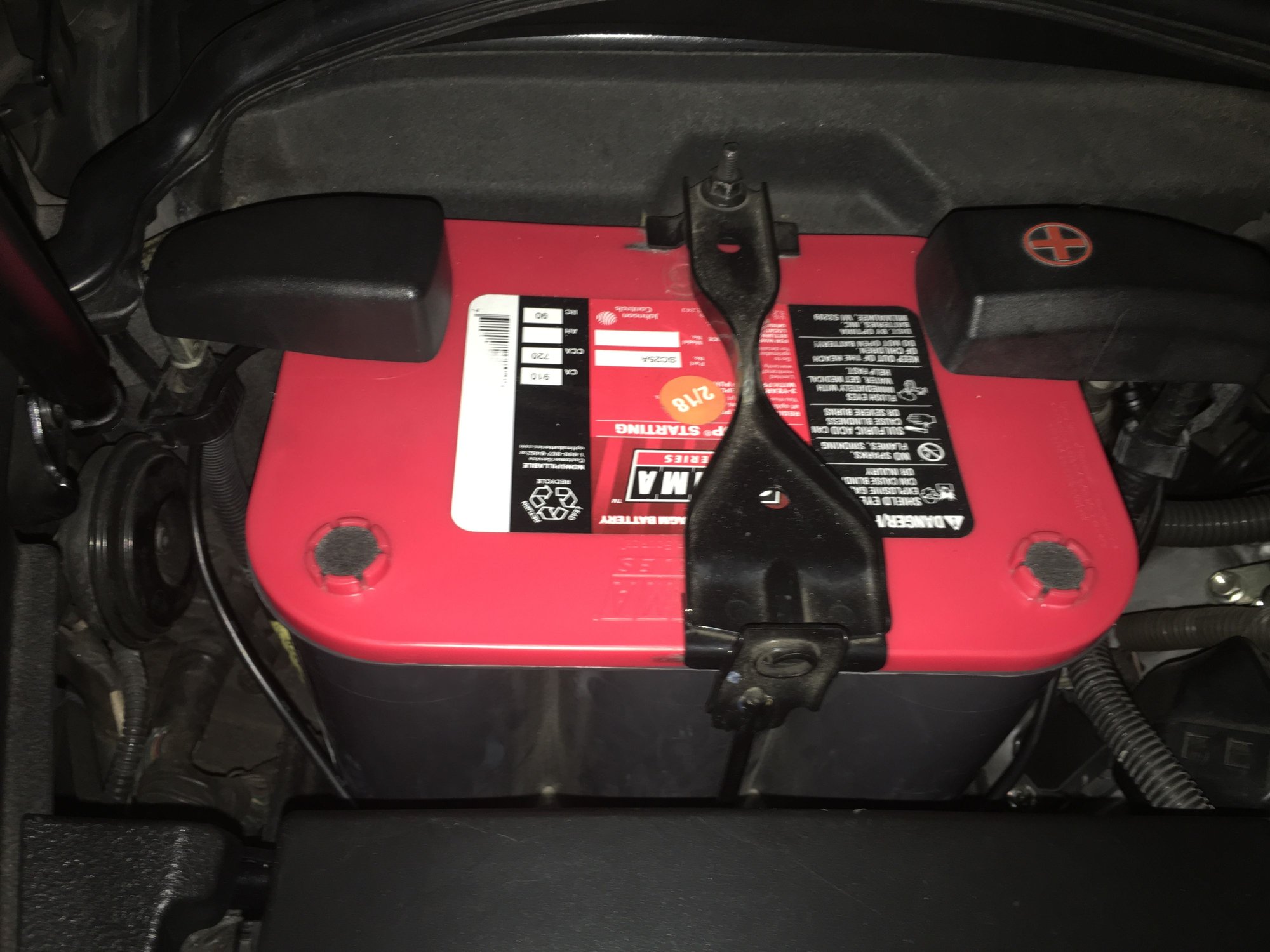

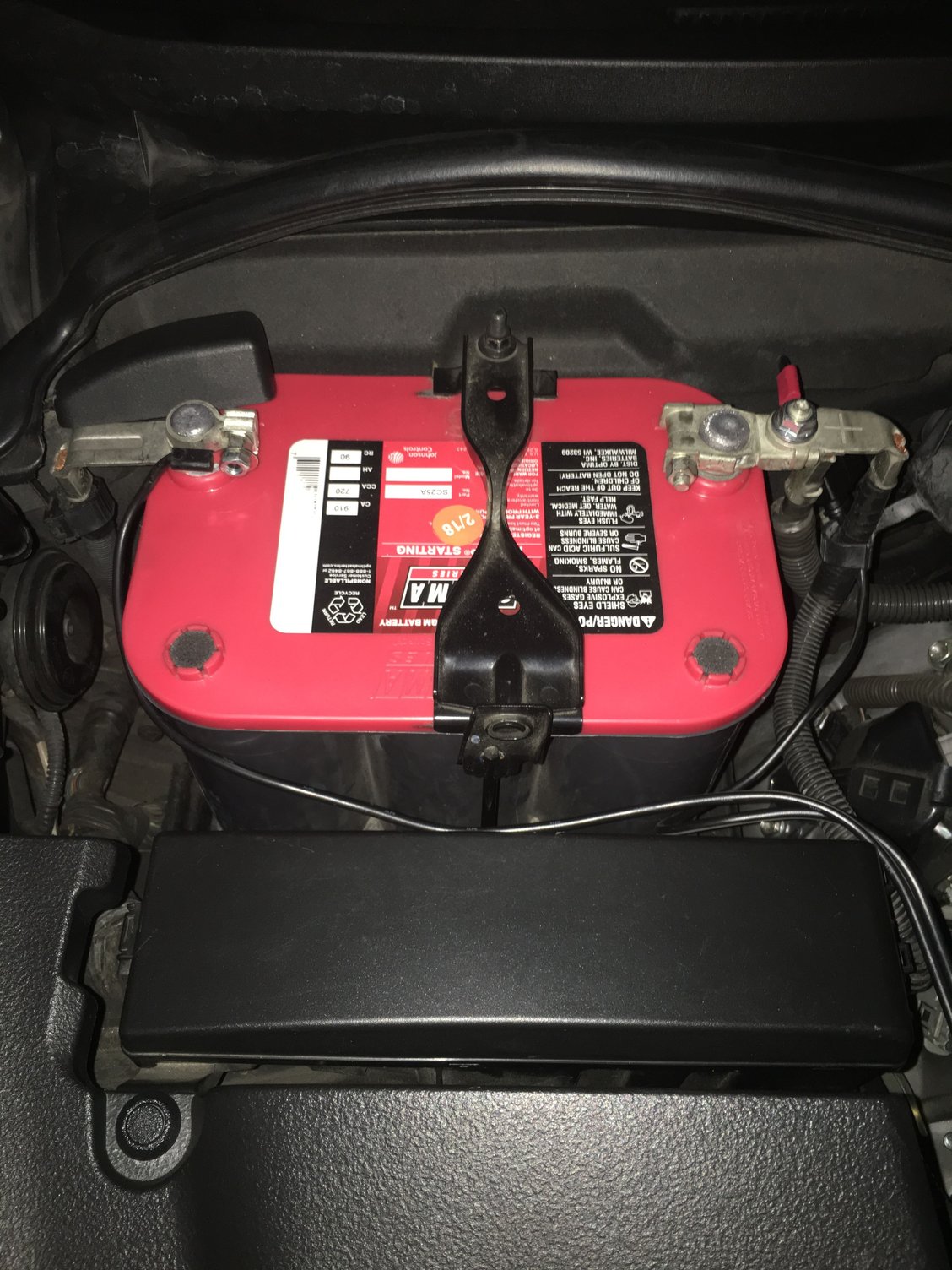

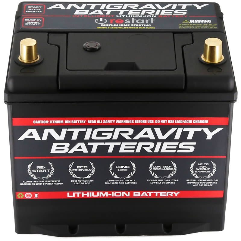

@ChpEng if don't want to install it upside down... Be sure to get the one in this orientation..
Seems like on their ordering page you select Postive Left or Right.
However be forewarned it moves the cables forward towards front of battery vs towards firewall..
For example red top optima does not have that luxury, so when I ordered their group 25 I had to flip so the cables are in line with OEM spec towards firewall..
You can use the pepboys or Costco interstate battery links to see what I'm talking about on standard batteries in 24 / 24F layouts.. Use an 08 IS F vs 08 ES350 as they go in oposite corners.
Hope that make sense... When you go with a non standard replacements you run into universal fitments that are not as ascetically pleasing.. The battery below would be great if they flipped their labels.
^^^ I wouldn't order this one...
Get the one in this orientation, sticker / label will be upside down but the terminals will be in OEM spec locations

So the issue is with antigravity they aren't clear, and don't have specific pictures of where the positive terminal is.
When I spoke with them they mentioned that the orientation is in regards to the battery terminals towards the front of the battery. If that's the case then the positive would be left, and turning the battery around with the posts towards the rear would place the terminal on the right. That is at least what I remember from memory, would be best to try to contact them, but admittedly slightly difficult at this time.

I called yesterday and confirmed this. The correct fitment is positive left, which places terminals closest to firewall and labels/stickers upside down, exactly as shown in @AlOtaBblGm's photos above.

Agreed guys..!!! As seen in post 1... Label flipped around, but terminals where they need to be
As seen in post #1

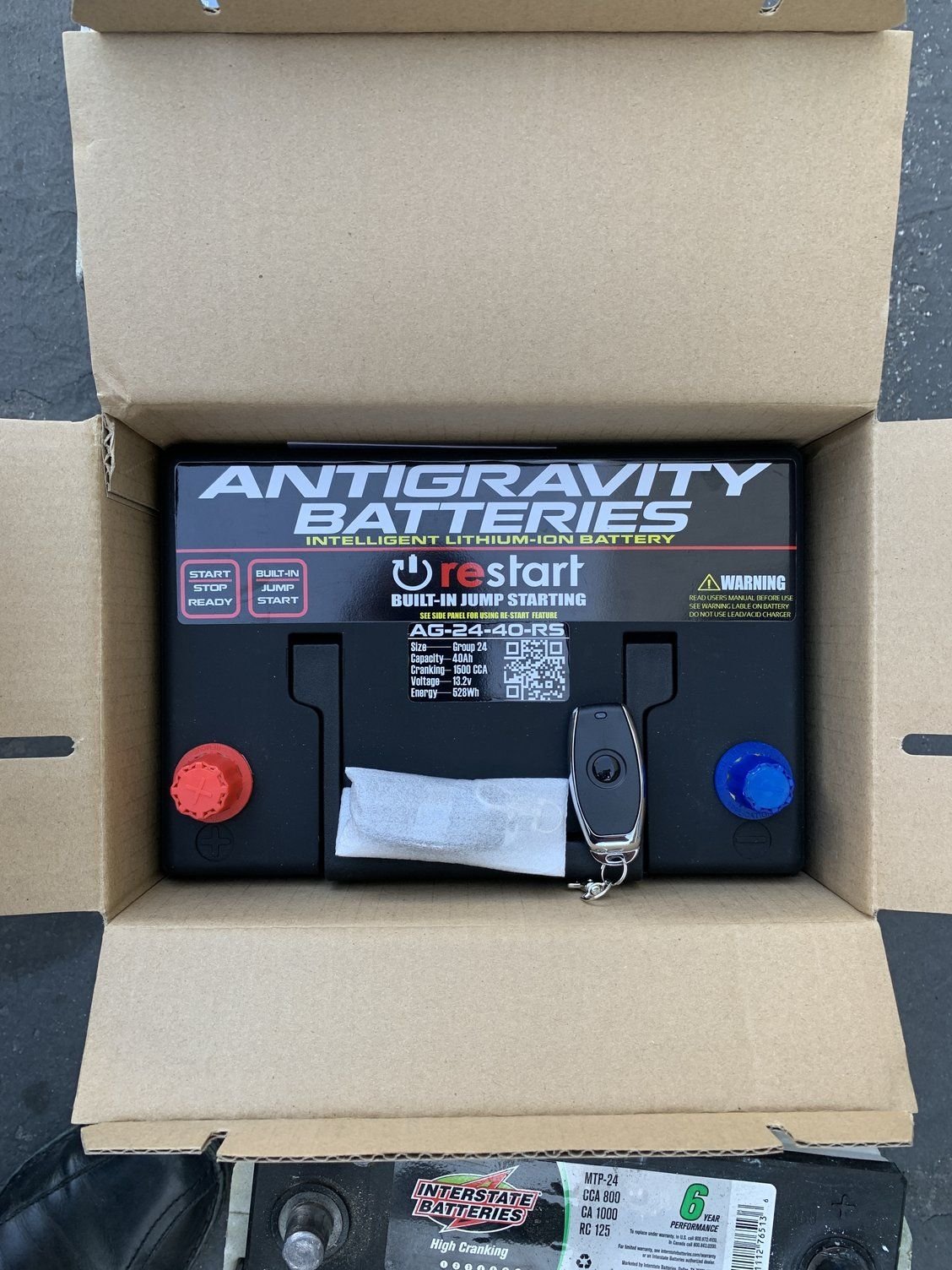

Antigravity Group 24 at 30 Ah showed up today. Perfect fit and much lighter than any lead/acid battery. I paid $750 for the Antigravity battery with a CTEK charger (normally $85) using the Black Friday discount. Life expectancy is 10 years, so longer than most people keep their cars. It can never spill acid in your car. The terminals won't crack and release hydrogen to corrode your battery terminals. If it ever drops below normal voltage, it disconnects the internal cells until you invoke the restart feature to start the car and start charging again. Best of all, it's a super quick way to lose 30 pounds off the car's weight. Sure, it's not cheap for the initial outlay, but the value proposition is unbeatable.
Oh, bonus - they send you a Bluetooth battery monitor to connect to their app on your phone and monitor battery charge, starting voltage, and charging system operation. Buying this by itself is $35, but they send it with every battery they sell too.
Weights below in pounds and kilograms as received from Antigravity.

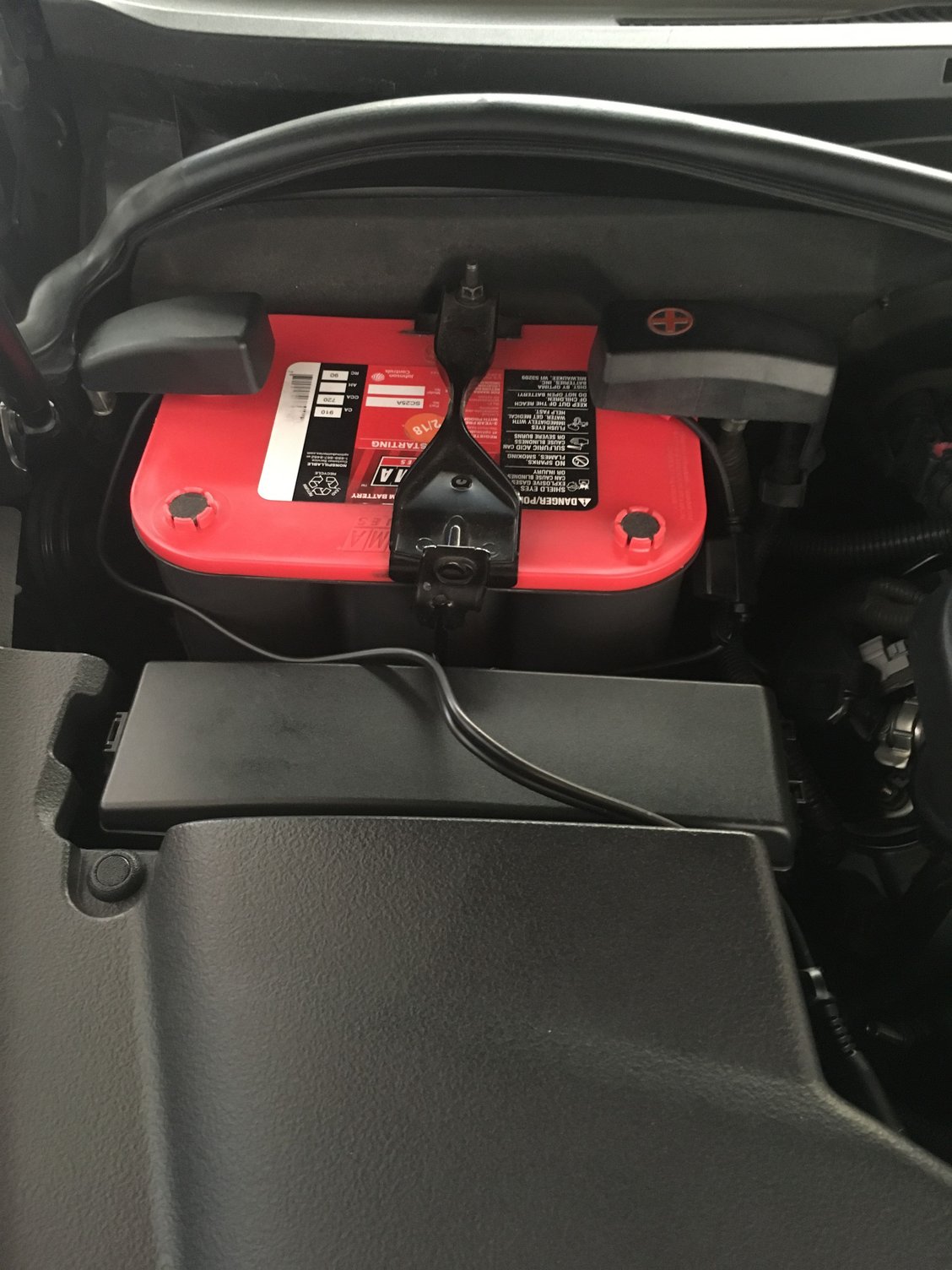

Nice you flipped the stickers... Well done..!!
Did you cut openings into the terminal covers??
Mine was challenging too when I installed the eyelet ring terminal connectors for the tender.
Final install on mine.. For the hidden look. Don't mind my upside sticker
