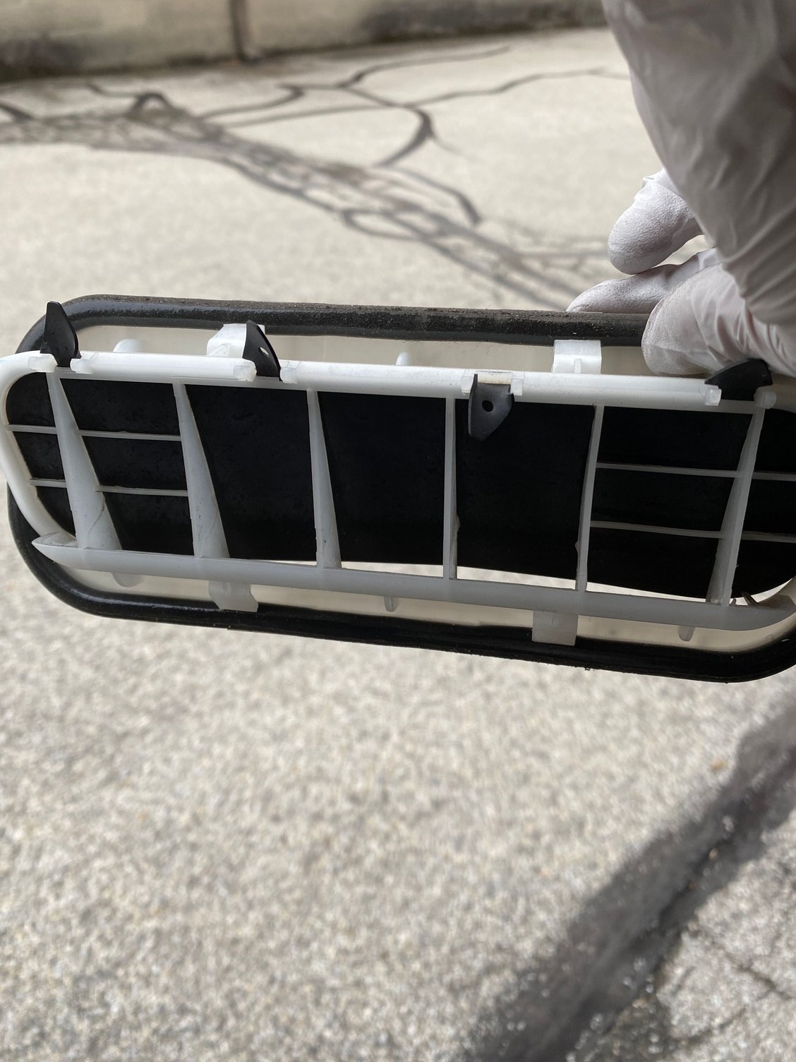

Both of my flaps are completely intact. Just looking at them, I can tell it isn’t air tight in either direction. I taped them both closed, with zero change in behavior closing the trunk. The trunk smells badly of exhaust, so I’m confidant that is a big part of the issue.

just following up. Both of my vents are completely intact. I taped them both shut for an experiment. My trunk and doors all close as usual with zero resistance.
My exhaust smell was drastically reduced this morning. My interior smells like exhaust when the car is off, so it probably just needs a clean and to air out now. Windows were up, and heat on full blast. As the airspeed of the vents increased, there was no discernible change in smell.
so I’m rather confident that these flaps, in perfect condition, allow exhaust into the car with the stock exhaust tips. I didn’t pay attention to which model of flap I have on my car, but I’ll get that data when I remove my bumper completely to remove the oem tips and replace with aftermarket ones.

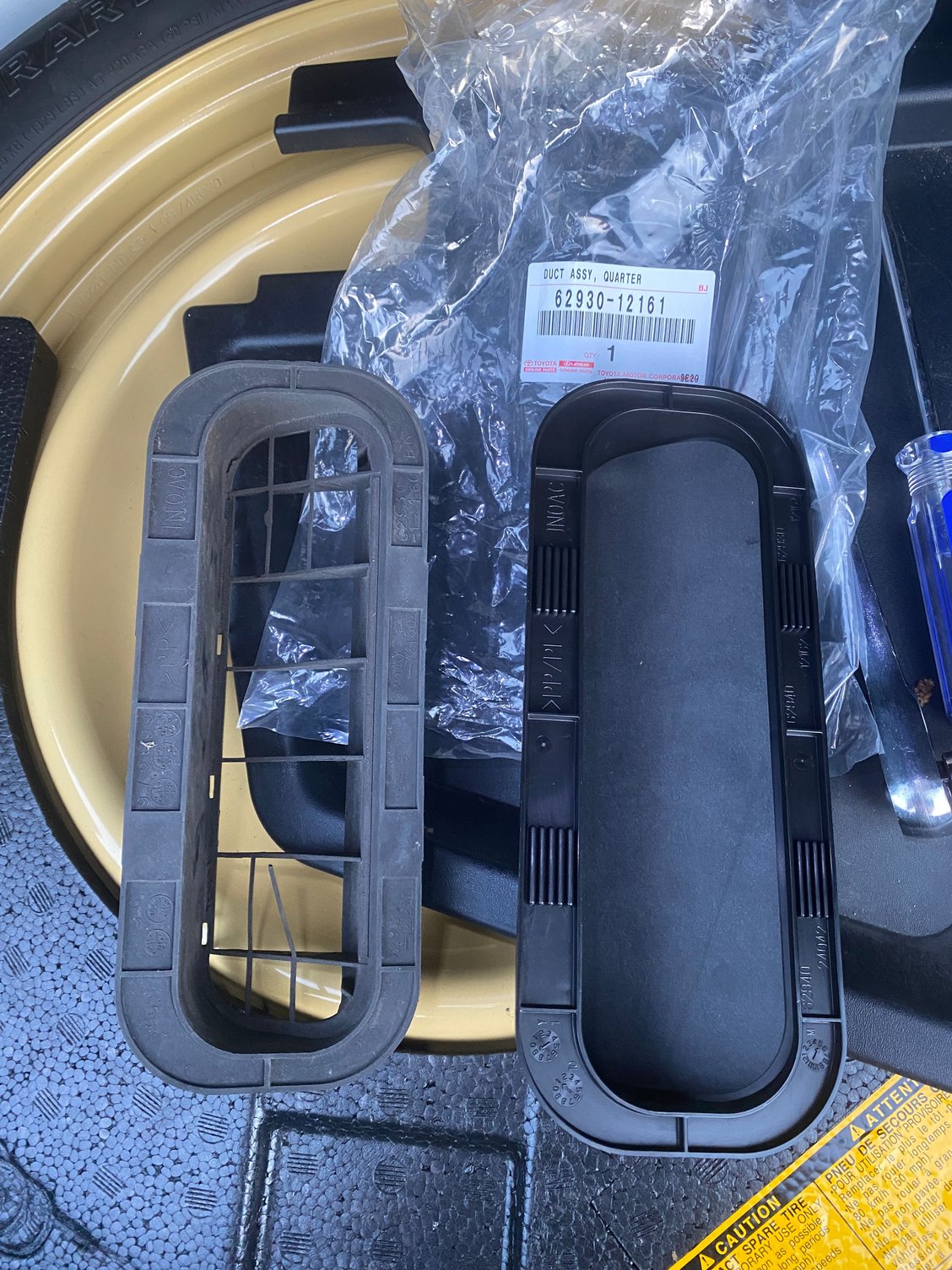

Just got a new pair of vents and went to inspect the old ones.... looks like the flaps were completely missing on both sides. Comparison of the old vs the new

Looks like I have the old. After I get my exhaust extended, I’ll try the new. Thanks for posting.

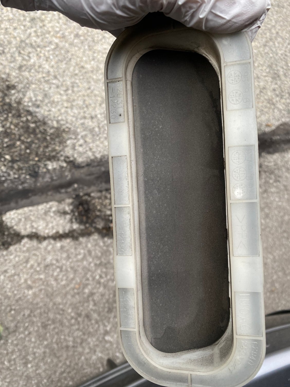

So mine were no different than anyone else's. The flaps were hard as rocks and not sealing at all. I ordered new and just assumed mine would be bad. The install went just fine. Instead of wire, I used a pair of stork pliers and grabbed the rib right behind the locking tab and pulled until it clicked. It's easy enough to get the bottom engaged and locked, just the top needed a pull to lock in place.
Now I am wondering if the HVAC will work better with this seal working again. This definitely needs to be added to the known issues, and I would suggest anyone with one of these cars check and see what condition the flaps are in. I'd bet a lot of money anything 10 years or older needs replacement, maybe even less.

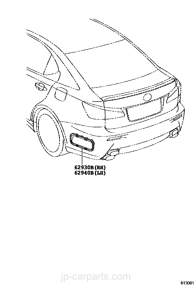

I did get a message or two on where the "Sunroof Ventilators" are located...
Just in case..
