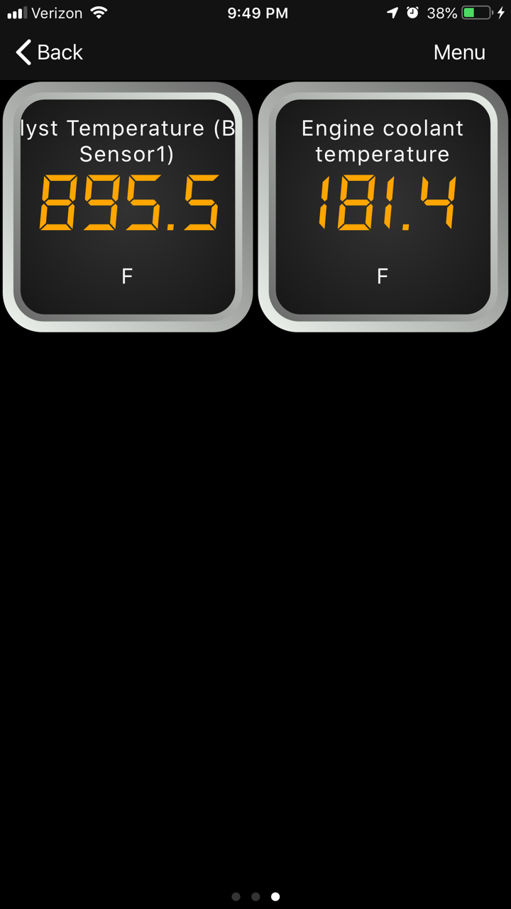

Start engine, using my obd2 app i monitored my coolant temperature, TEMPERATURE MUST BE AT 180 DEGREES BEFORE ENGINE SHUTDOWN also found the temp gauge on the dash to be at normal operating range at 180 degrees.

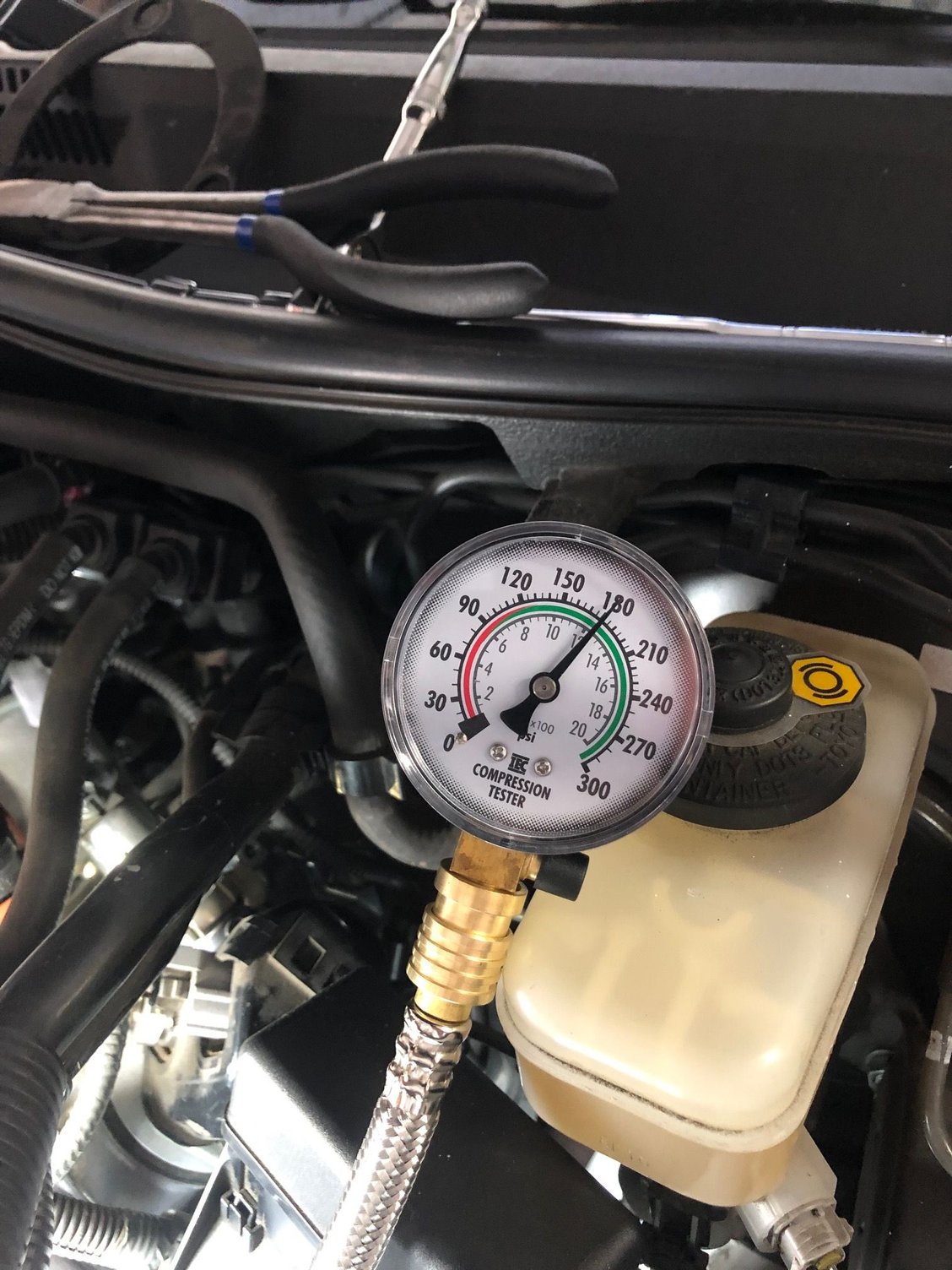

Remove the spark plug from the first cylinder you are going to test,
Thread in your compression tester hose until it fully seats to the rubber o-ring
Crank engine for 5 seconds, depress brake, press and hold the start/stop button
Your gauge should read your pressure in the cylinder it should be above 180 psi to upwards of 200's
Depending on manufacturer, there should be a pressure release near the gauge, release the pressure from the gauge until needle reads 0 psi
Remove compression tool and reinstall spark plug torque to spec, I believe it is 15ft/lbs Note: When using extensions and swivels a torque wrench will not work accurately, so please use your best judgement.

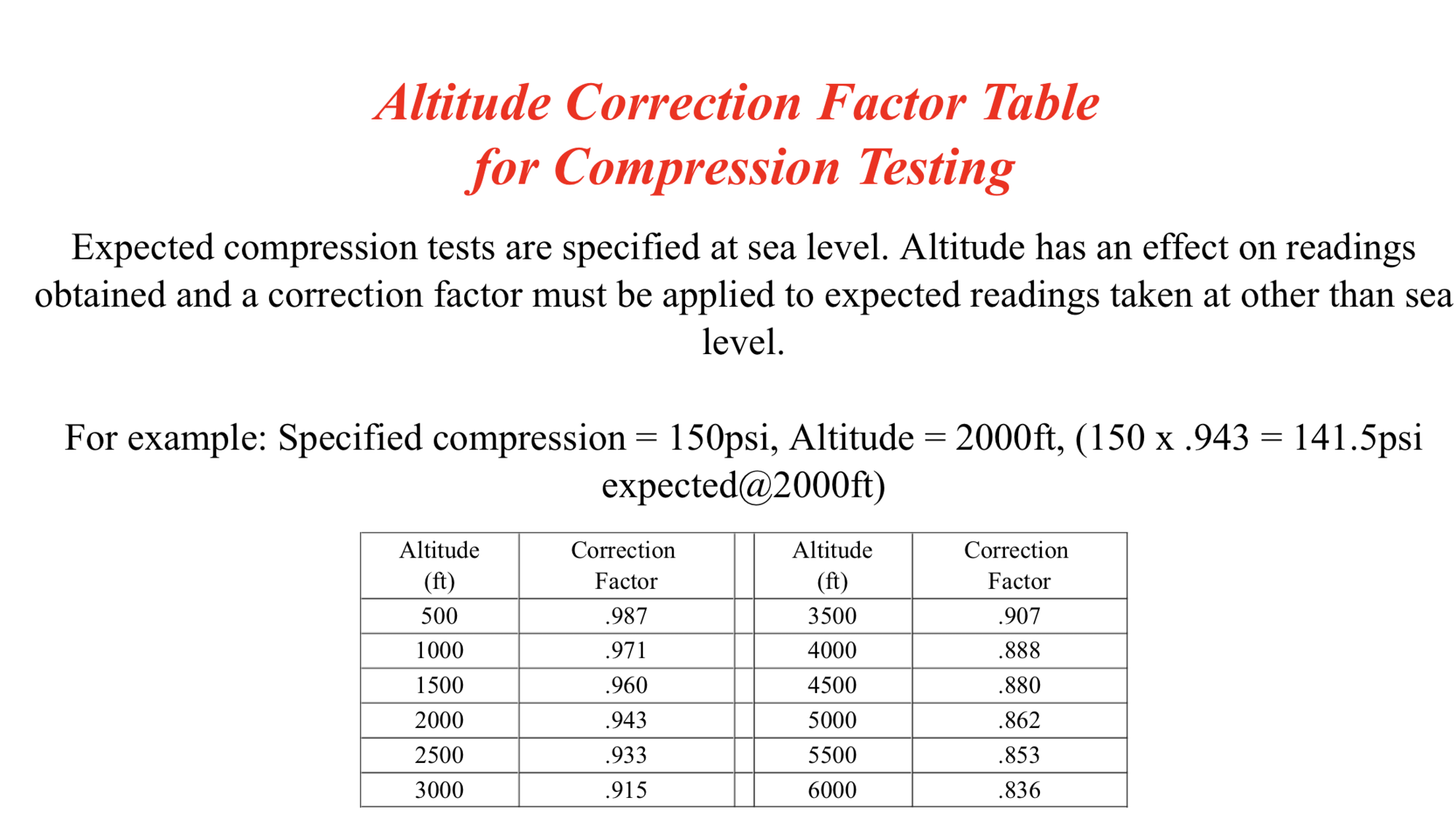

Notes: I am at 5300 Ft. above sea level, the amount of air density at altitude is lower than those at sea level, therefor my compression numbers are lower and require an adjustment. Below is a few pictures taken from the process as well as the chart for altitude correction
