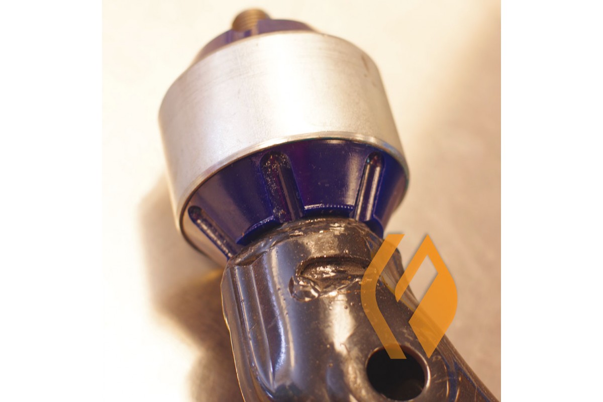

I would say that you need to look at the bushing design, not the durometer to make your decision. Our SuperPro bushing is designed to be progressive, meaning higher resistance relative to load. It is not designed to be a zero deflection bushing, so it is doing its job perfectly. For higher loads with larger brakes and stickier tires we have a 0 deflection solution for that, the Poly version is designed to maintain comfort while delivering performance and longevity. We have thousands of these bushings in service over the past 7 years they have been offered and the feedback has been consistent.
As you can see in this image, the conical profile and relief is intentional and provides a damping function to absorb the force. This also means that the bushing will deflect as a function of the load. This is desirable for many reasons and is not a defect or a lack proper function. The Factory bushing is an undamped fluid filled unit, making it more prone to maximum excursion under most loads without increased resistance. We have had many people come back to our bushing after trying other brands. They work as advertised, always have.
