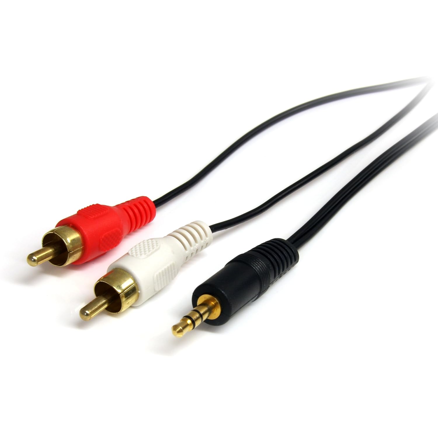

You can check to see if the amp/sub work by connecting an RCA to 3.5mm adaper cable like this --> http://ecx.images-amazon.com/images/...L._AA1500_.jpg and playing audio - if the amp/sub play then you know its an issue with the hi/low convertor.
