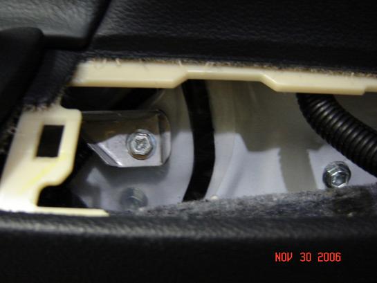

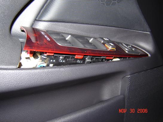

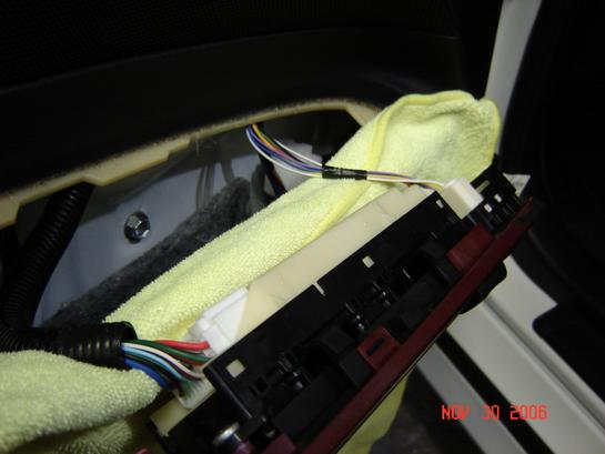

The photo's are from those that blazed this trail before me - IS 250 photo's
The inner door handle has a cover, pop that off and there should be a phillips screw.
Then remove the power window switch and it should reveal another screw.
The rest of the panel is held up by plastic clips or pop pins (I think there is about 6 of them), pop them off by pulling the lower part of the door panel away, and when they all all off and loose push up as the window weather stripping needs to be unhooked along the top.
