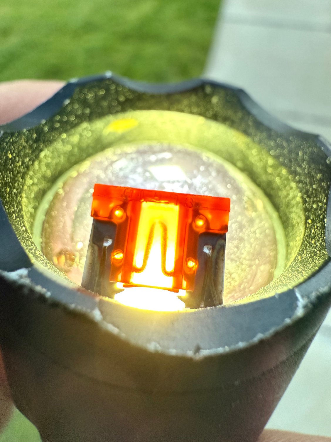

Passenger side fuse box: #4 for Stop Light, I think I got it, I don’t have one on hand though, but hopefully
Thank you @Logic3016
https://www.clublexus.com/forums/is-...ke-lights.html

UPDATE: All sorted
I put the original brake light switch back together, replaced the fuse then re-connected the fully charged battery. Car started right up. So game, set, match :-))
Thank you all who chimed in and supported me with this ordeal.
