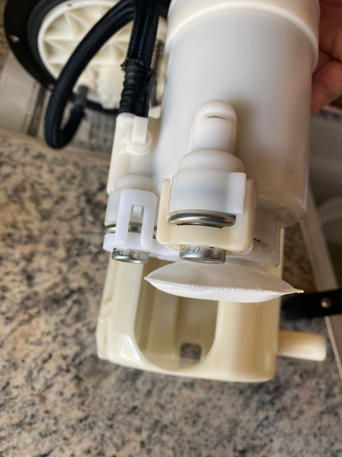

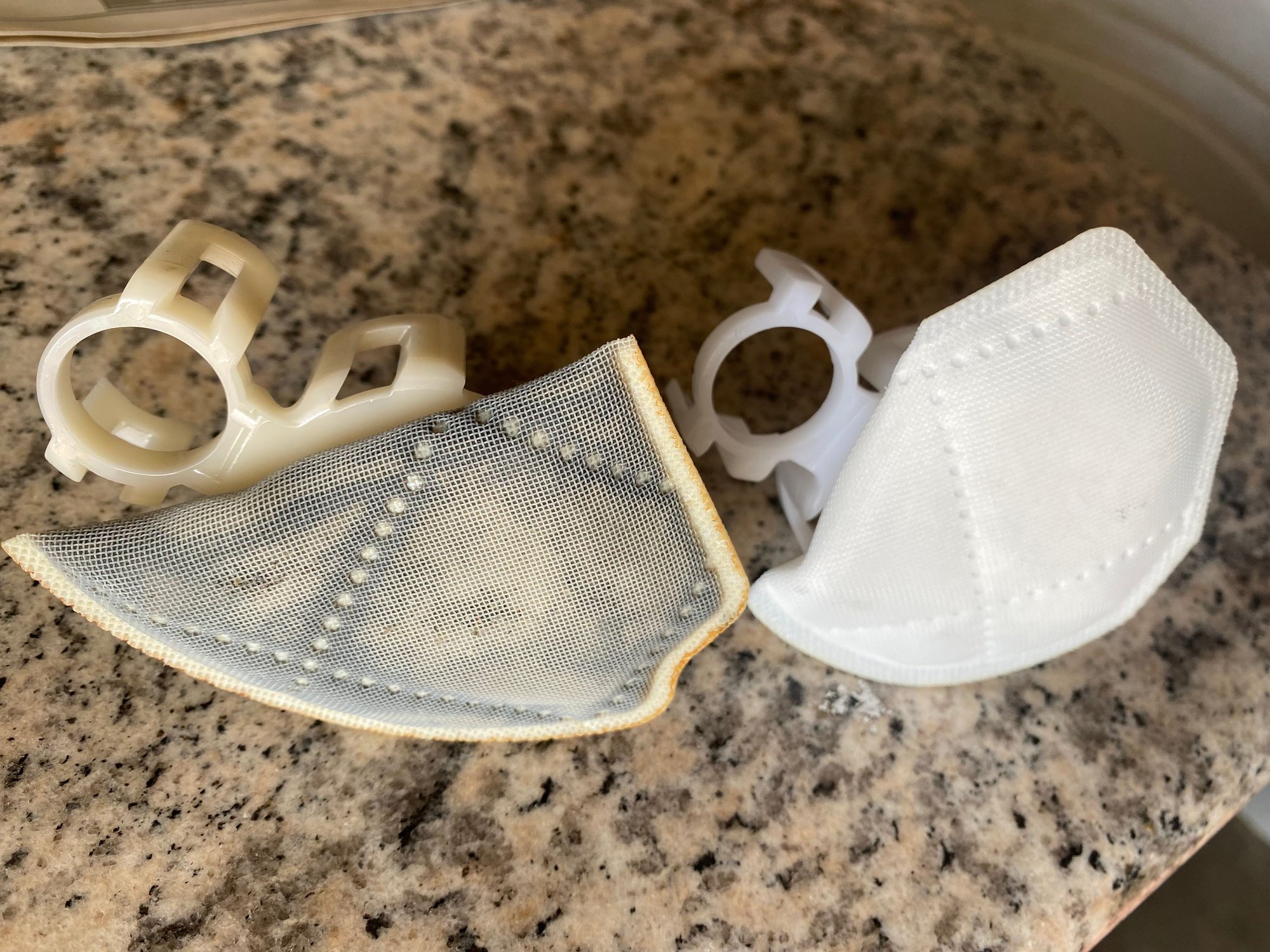

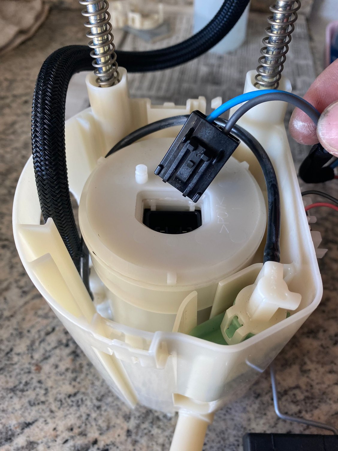

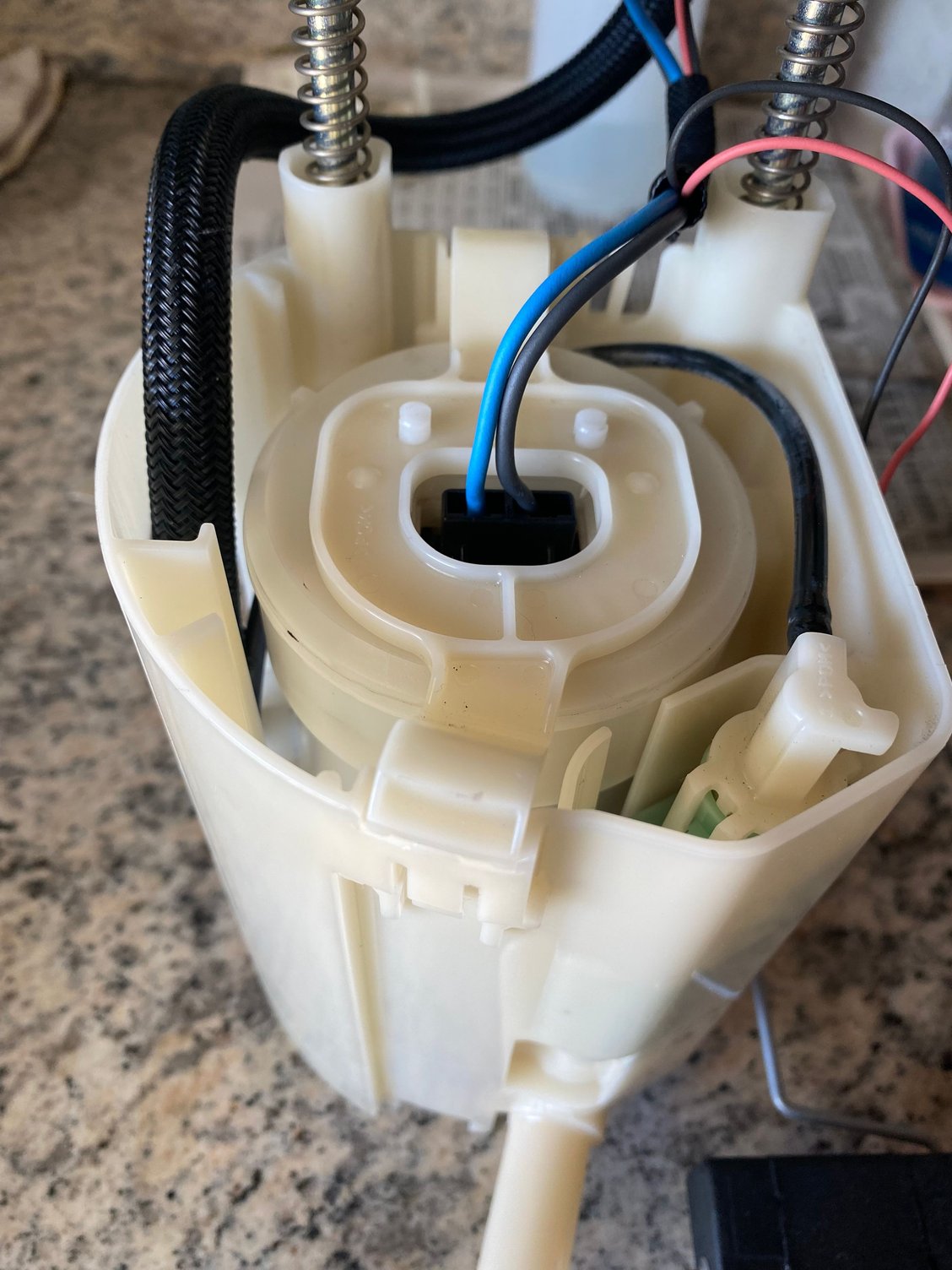

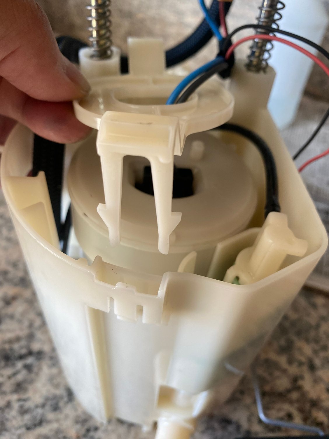

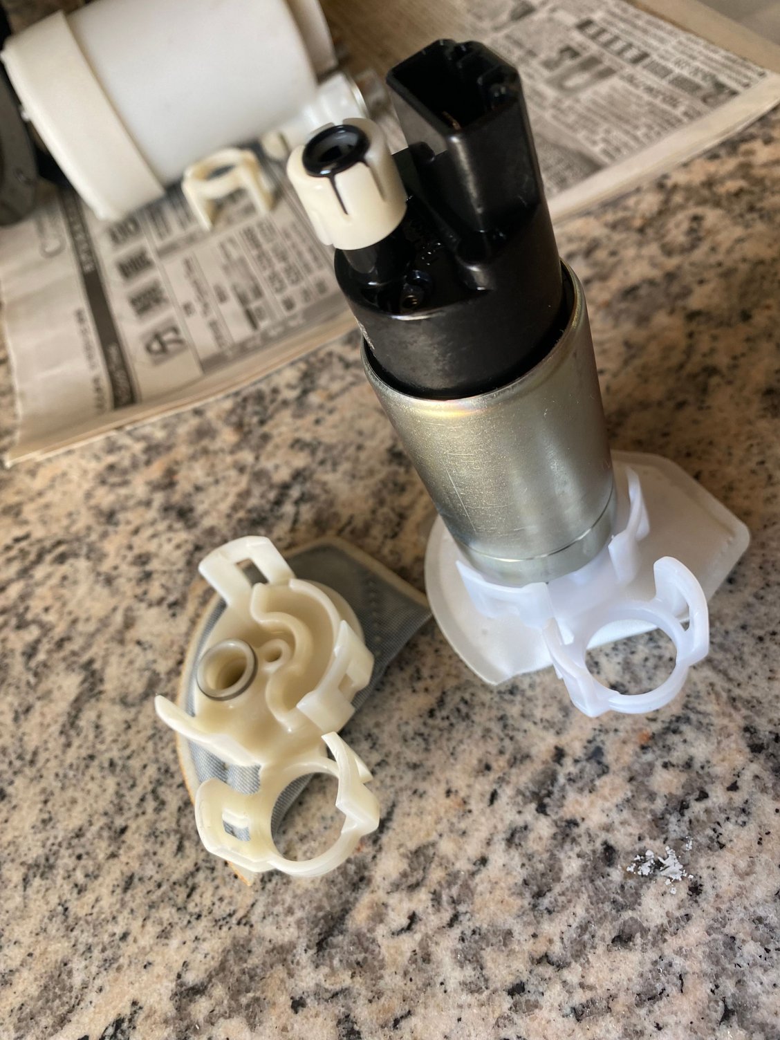

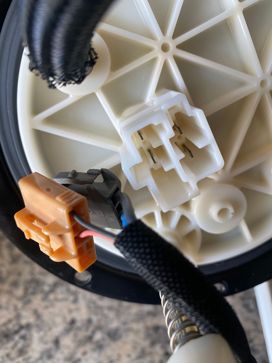

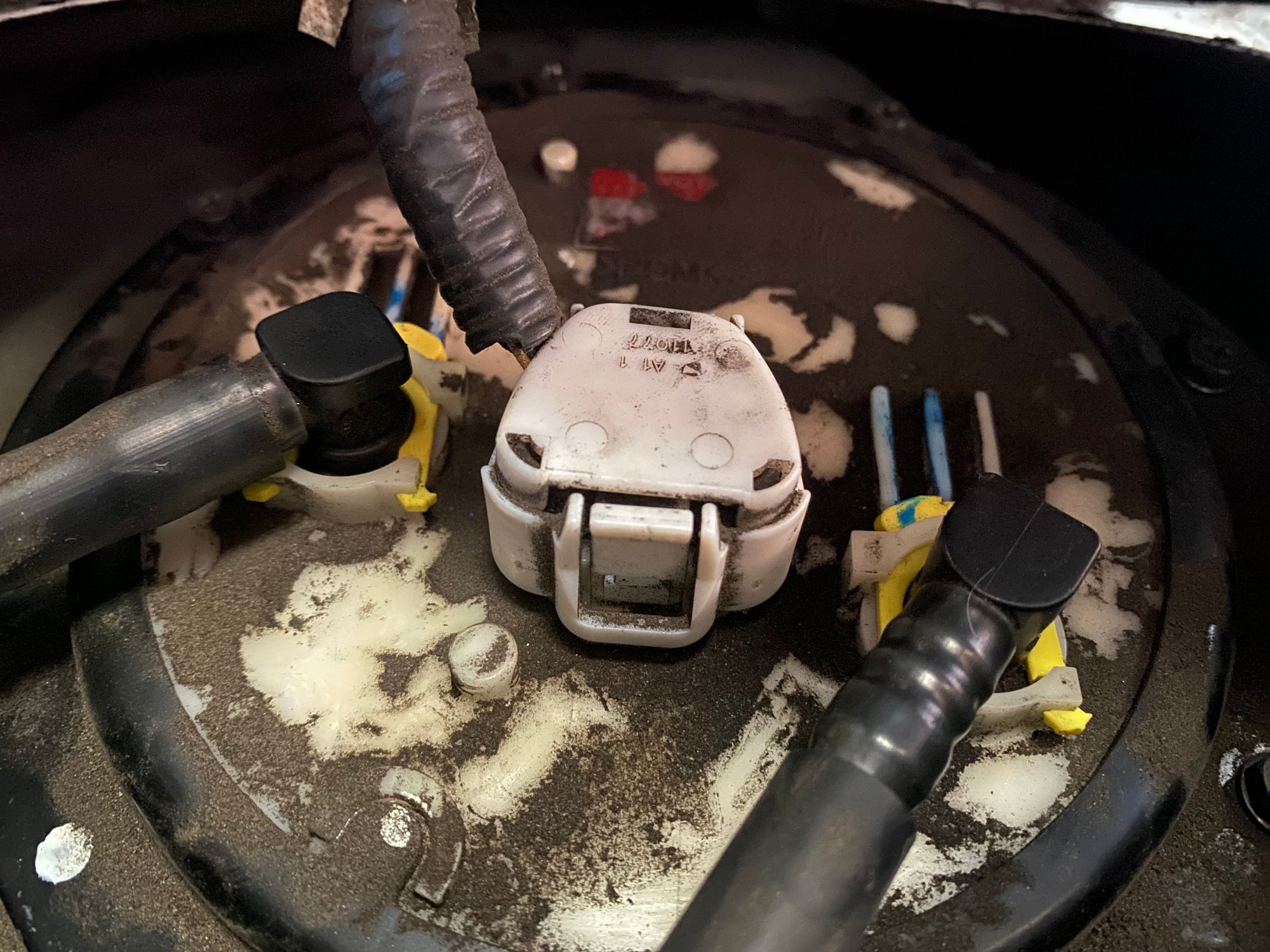

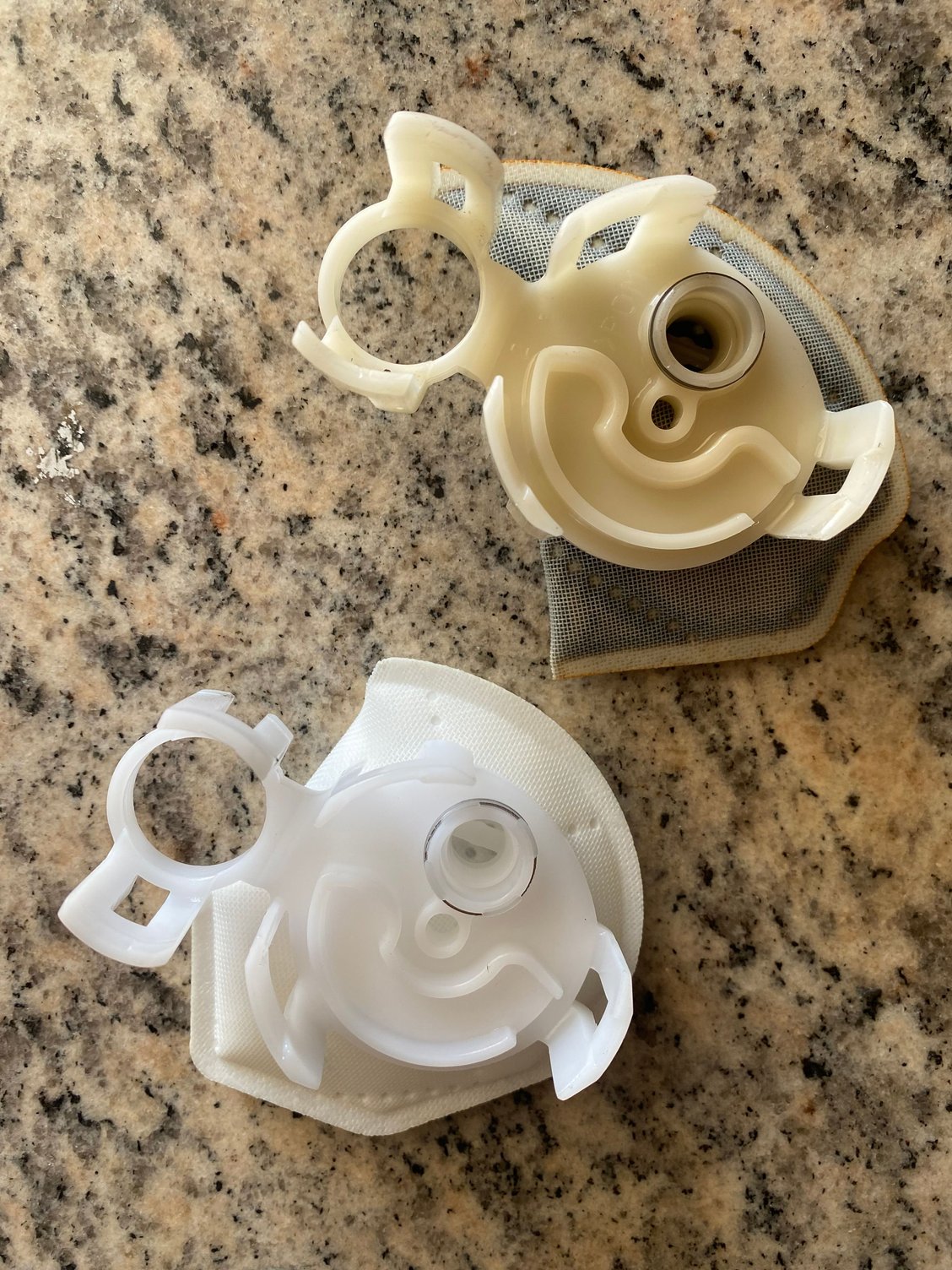

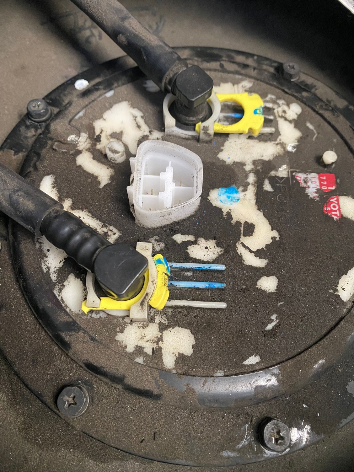

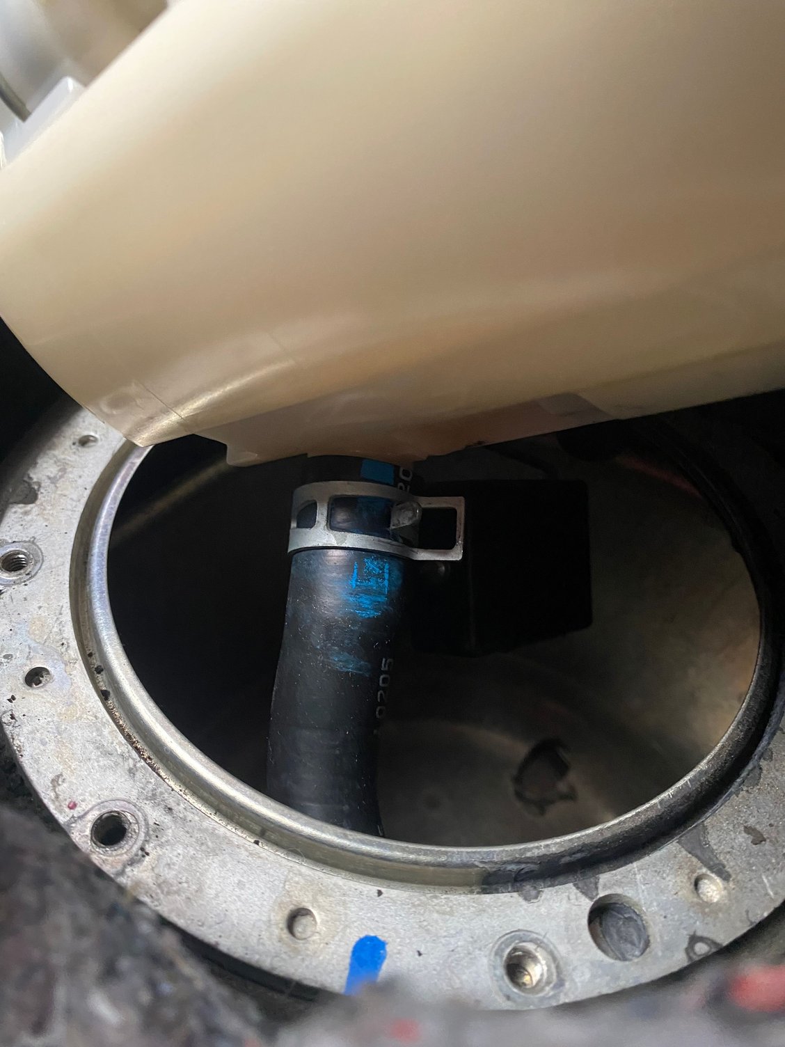

Wasn’t sure if this has been cover but had this strainer laying around and made the switch. 180k miles.
The pump is located beneath the rear seat on the driver side.
Part # Spectra Premium STR125
