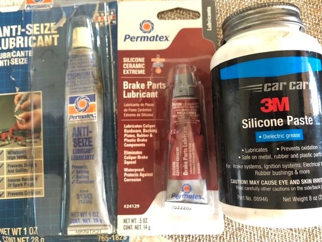

What I did just to redo the pads:
1. Get the right chemicals. See attached pic. You need clip/pad grease, caliper pin silicon grease, anti-seize, and brake cleaner.
2. Take it slow, clean everything. You’ll want to sand the rotors to remove any deposits etc. and present a nice clean surface to your new pads. If they are scored or you suspect they are warped, you may want to just get new ones. Brembo blanks are surprisingly cheap/about the same as knock offs. Toyota ones are crazy expensive.
3. Clean the clips then sparingly grease them so your pads move smoothly.
4. Make sure to use the 3M Silicone paste to lube the caliper pins. Those need to move freely.
5. While you are in there, use anti-seize on the back of the rotors so they won’t rust onto your hubs (if you have to use bolts to remove them, you’ll understand why this helps later).
6. Lots of suggestions on how to push the pistons back into place. As they are displacing fluid, make sure you watch your brake fluid level. Open the cap and remove some if need be.
Again, lots of write ups on these forums. Good luck, it’s pretty easy and after you do it the first time, you’ll have no trouble doing them in the future. Have fun with it.
