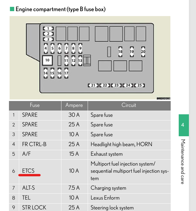

@Nevada thanks, great advice. I missed that fuse box because it was not visible without removing the plastic engine shrouding. Sure enough, the 10A ETCS fuse was blown. Be aware that Google AI incorrectly identified the ETCS circuit as the 15A above.
Following replacement, the car fired right up, took about 10 minutes for the throttle relearn (I just let the car idle until the RPM stabilized at about 700RPM (A/C off). RPM started at about 1,500 and slowly decreased until stable. Upon start up, the check engine light extinguished after about 60 seconds, TRAC OFF remained until I manually turned traction control back on. Drove fine today!

I believe the cause of the blown fuse was low battery voltage or the jump start.
I have seen that fuse blown on a few RX350's with dead batteries, I never had to replace the throttle bodies.
There is unlikely to be a short in the throttle control motor and certainly not a short in the throttle position sensor.
