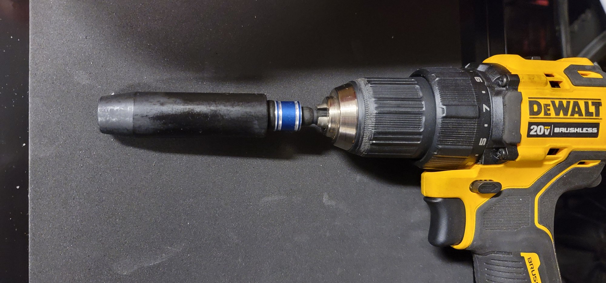

After bleeding finger and a soar arm, I asked RR for tip and they told me to use tapered wrench. Why couldn't I think of that before lol?

I bought tapered impact wrench set like this and I used the Silicon lubricant and put the tapered impact wrench into Silicon hose end for few hours. I left it overnight so it will be easier.
After leaving tapered impact wrench in the end of silicon hose overnight, it stretched nicely and I was able to angled it with silicon lubricant and finally that damn thing went in!
If you are installing RR racing AOS version 2, get a tapered impact wrench. It will make your life easier lol.

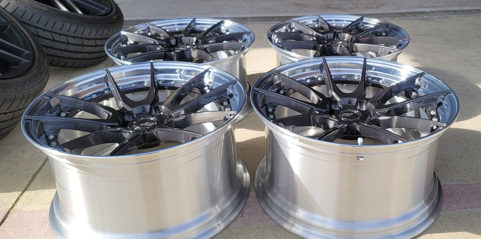

Bonus: My BC forged HCA162s wheels arrived this week too! I need to put it on ASAP. Good thing it's holiday tomorrow!
