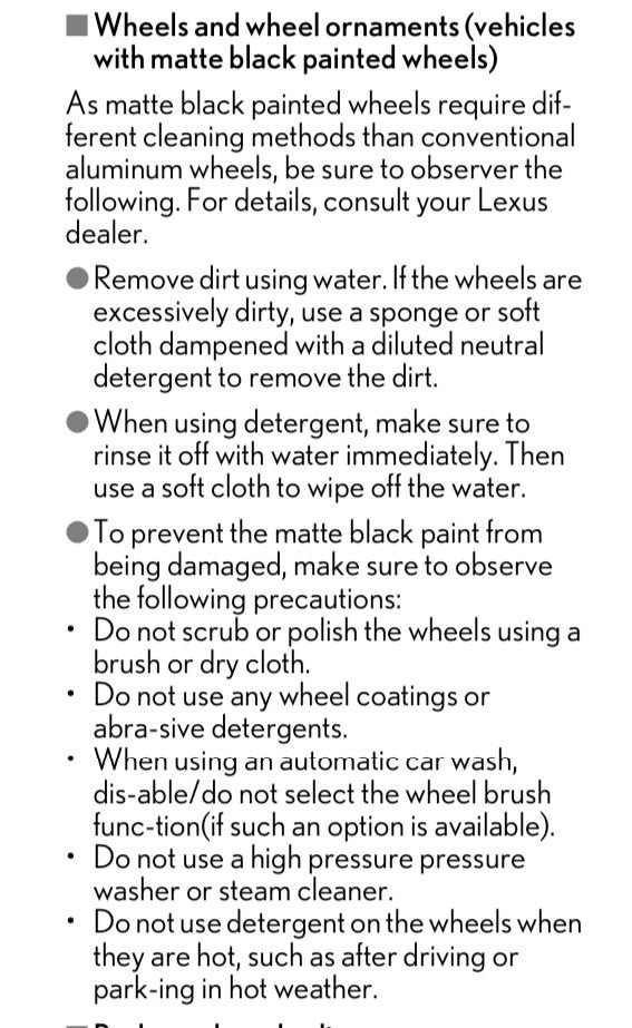

I havent had any issues with mine so far however i did read in the manual that special care must be taken to that trim...thanks for giving us a head's up

I need to find that in the manual.
