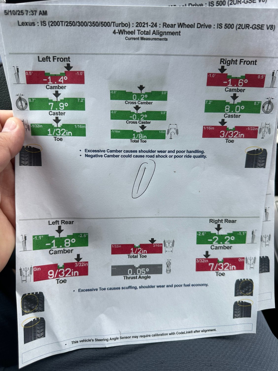

Originally Posted by spielnicht
@snowyblue and @PeterRC350 , how were your readings after a wheel alignment? Are all wheels still within spec? Camber issues?
sorry for the late reply, here are my alignment readings. No LCA bushings or Rear camber arms btw
Before
Before
After
After

No worries and thanks for posting your alignment numbers. I ended up with the Swifts but looks like the additional Eibach drop doesn’t really impact alignment that much. Either way we need adjustable front top arms.

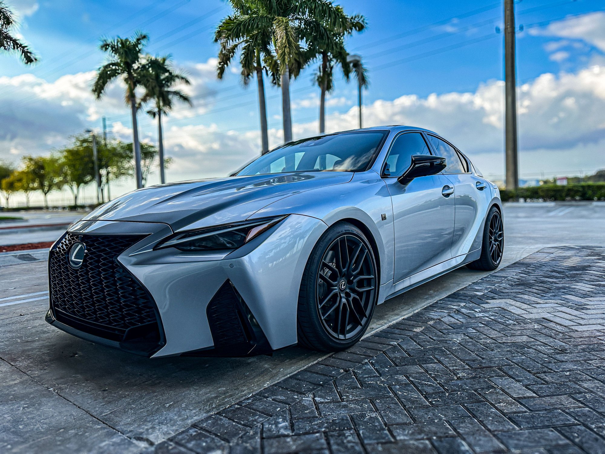

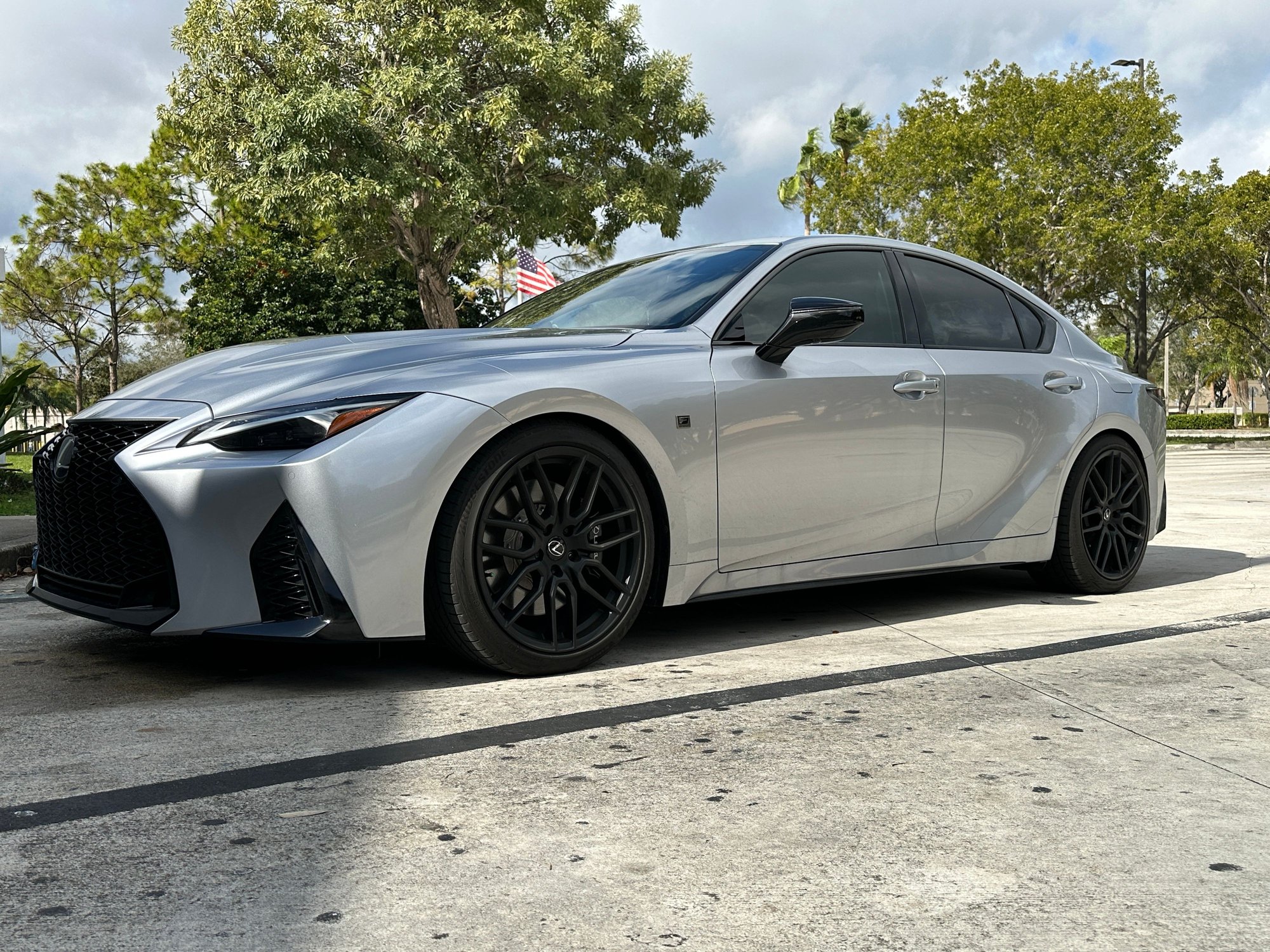

Originally Posted by PeterRC350
Yeah I’ve been running them for about a month and have yet to find any negatives, the ride stiffness feels like stock but with much better cornering. Based on my experience with Eibach in the past, I definitely recommend.
All 3 pics are with the Eibach springs? Was the last photo taken after some settling time? It looks even lower in the front. The first pic looks closer to the drop I've seen with the Swift springs.
Old Sep 28, 2025 | 04:15 PM
PeterRC350's Avatar
PeterRC350
Joined: Aug 2018
Posts: 45
Likes: 57
the last pic was actually taken day the springs were installed so maybe it was just the angle in which the pic was taken, the other 2 pics were maybe about 200-300 miles after
