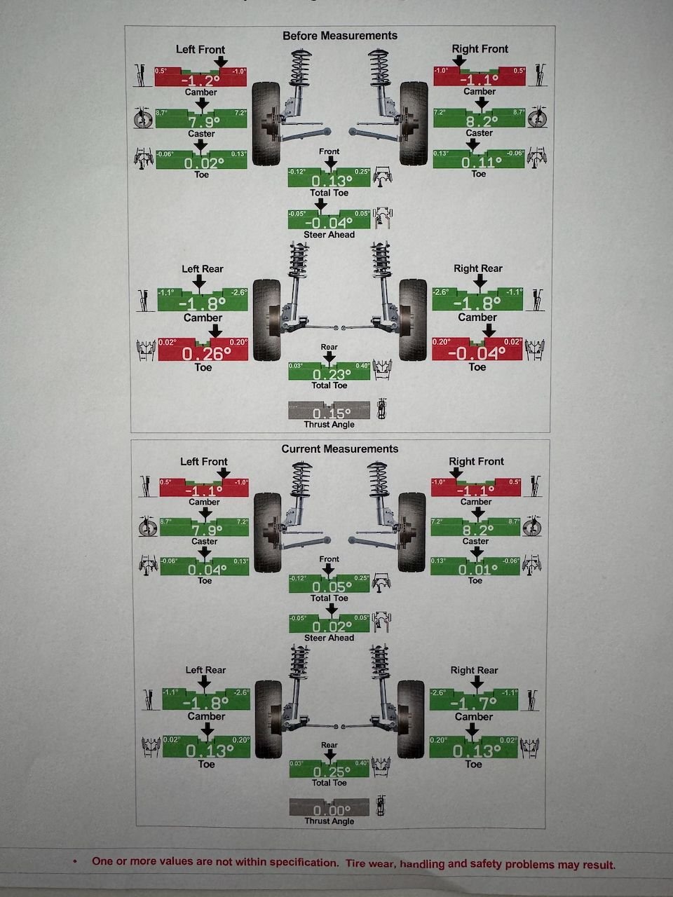

My readings.

That's actually pretty great. The factory front camber recommendations on these cars is super super weak.

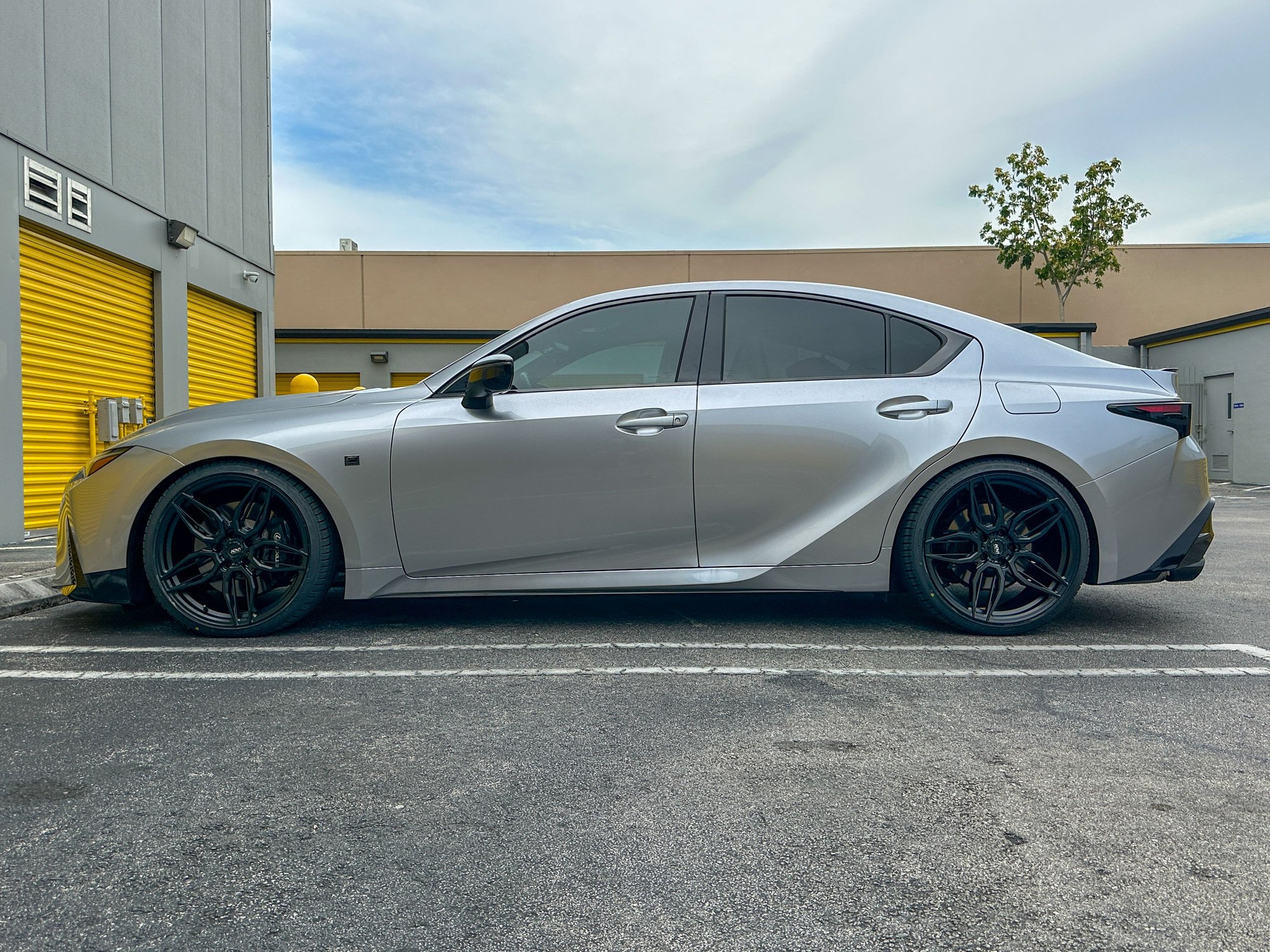

New tires on the car today. 245/40-19 and 275/35-19. Swift springs, Bonoss Spacers 15mm front 20mm rear.
