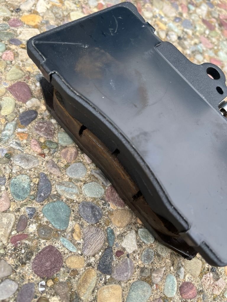

DFC and Stoptech (two examples I've looked into more closely), carry pads for the GS350 F Sport and on some sites will list them to fit the IS500. Looking at photos and at diagrams and now that I test fitted the DFCs, I'm not sure they are the correct pad material shape.
  • Yes the pad backing plate is close enough if not identical to our OEM pad, and they do install properly and do not have any play in the caliper.
  • However, I'll show that the contact patch of the pad material to the rotor is different and appears to leave a gap in certain areas. It's not necessarily problematic, unless you were to swap back to your OEM pads and if a lip were to form on the rotors from using smaller contact patch pads - but why wouldn't you want to maximize thermal capacity and contact patch area if you could?

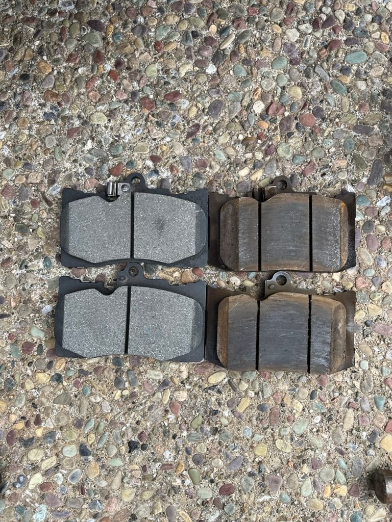

Here's a side-by-side comparison of the IS500 pads (on the right) and the DFC Active Performance pads (on the left). Notice the shape difference at the bottom:

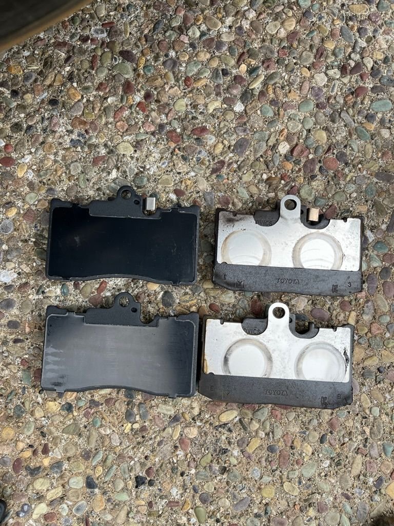

On the material side, you can clearly see the pad shapes are different and DFC is noticeably smaller in total surface area too:

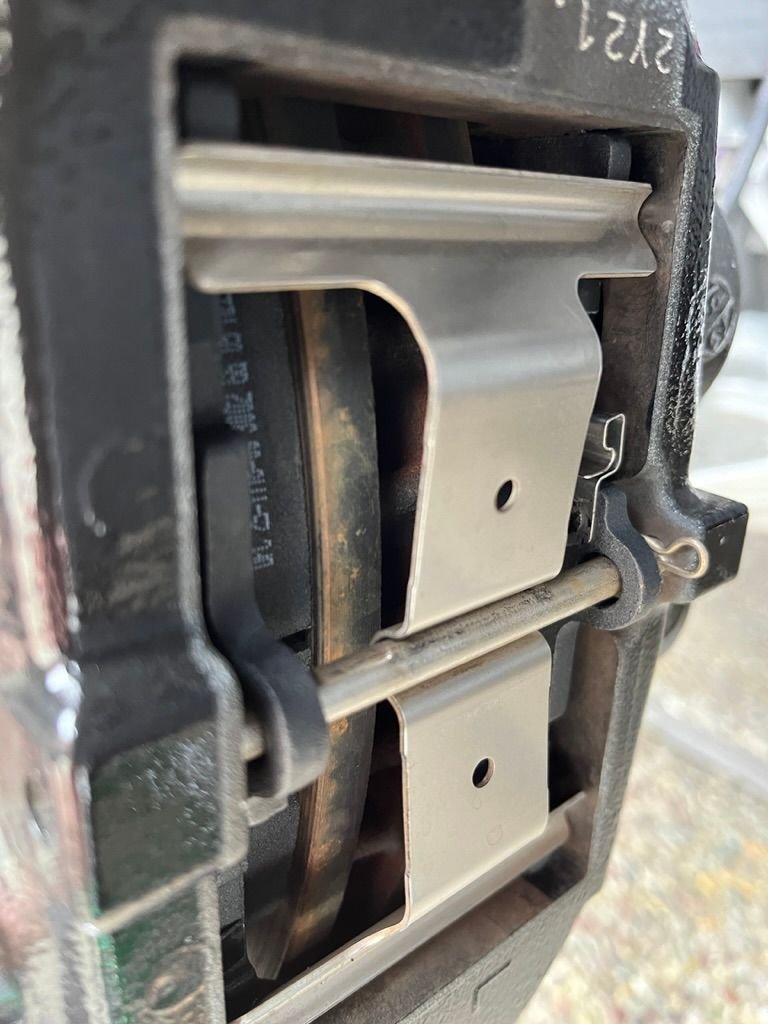

DFC is installed and there's a 2-3mm gap between the pad material and the inner edge of the rotor:

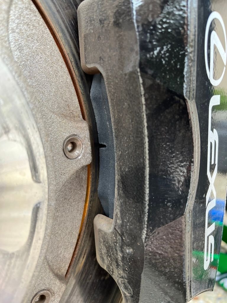

DFC installed and on the outer edge there's less of a gap but still maybe 1mm from the outer edge of the rotor:

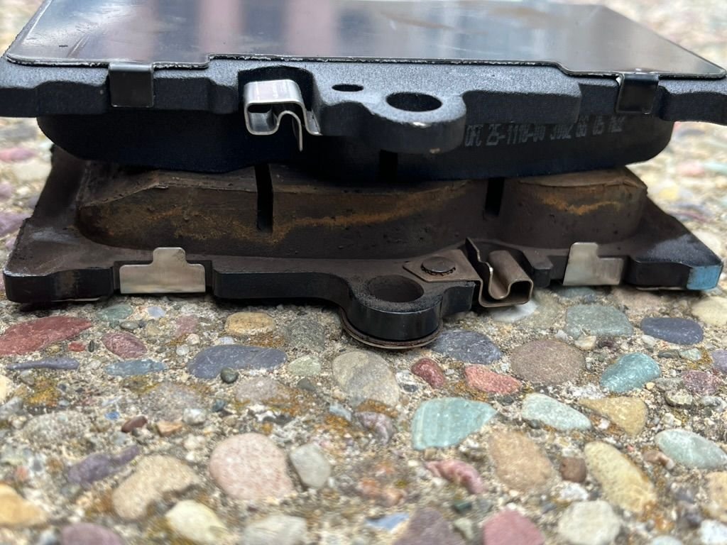

DFC on top and OEM on the bottom - the pads are fairly square/aligned by their backing plates.
This is the OEM pad installed in the caliper, pretty much full contact with the rotor, inner and outer edges:

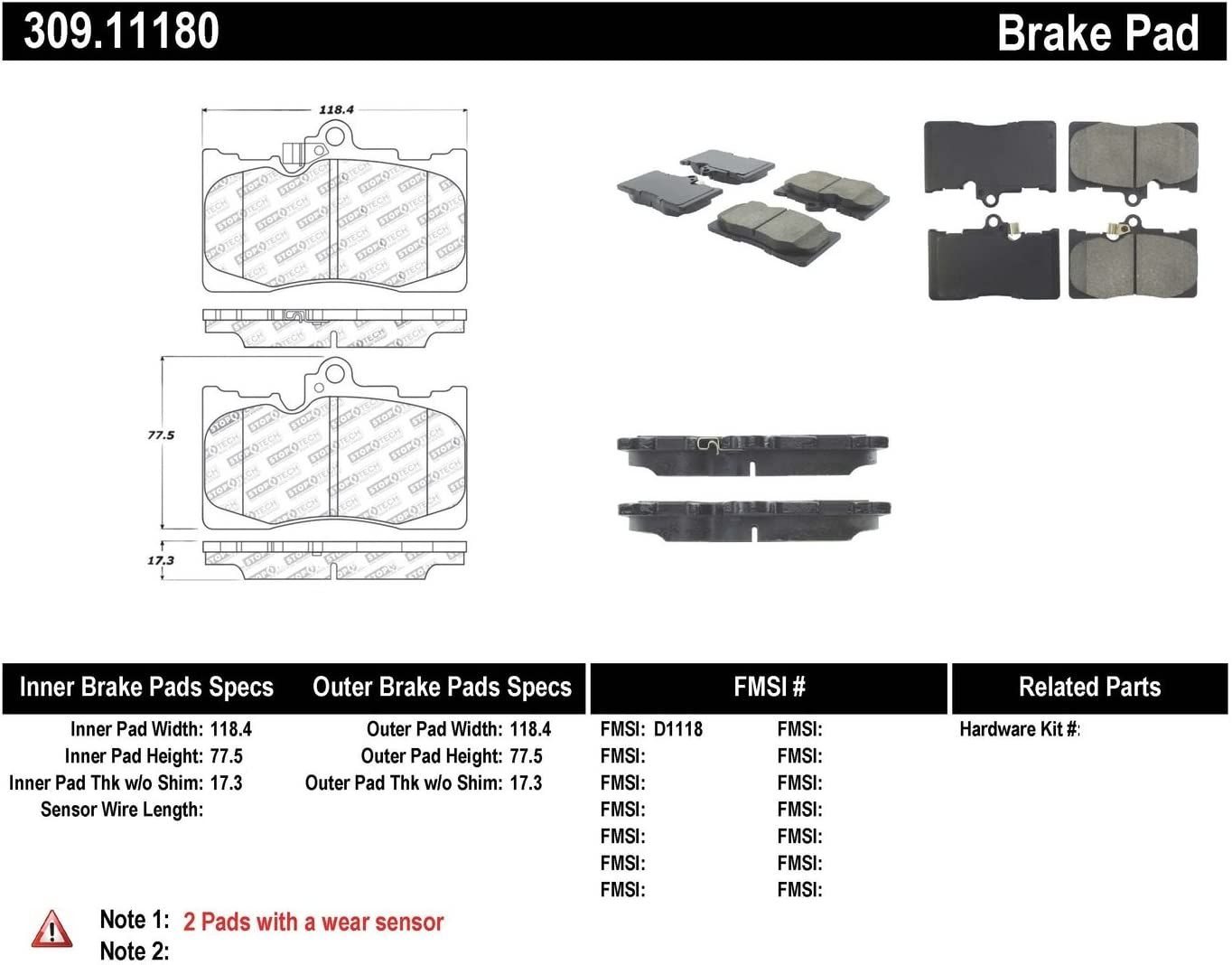

For another comparison, this is a StopTech sport pad that should also fit this car - the shape/design is identical to what DFC is using and would likely result in the same gaps:
