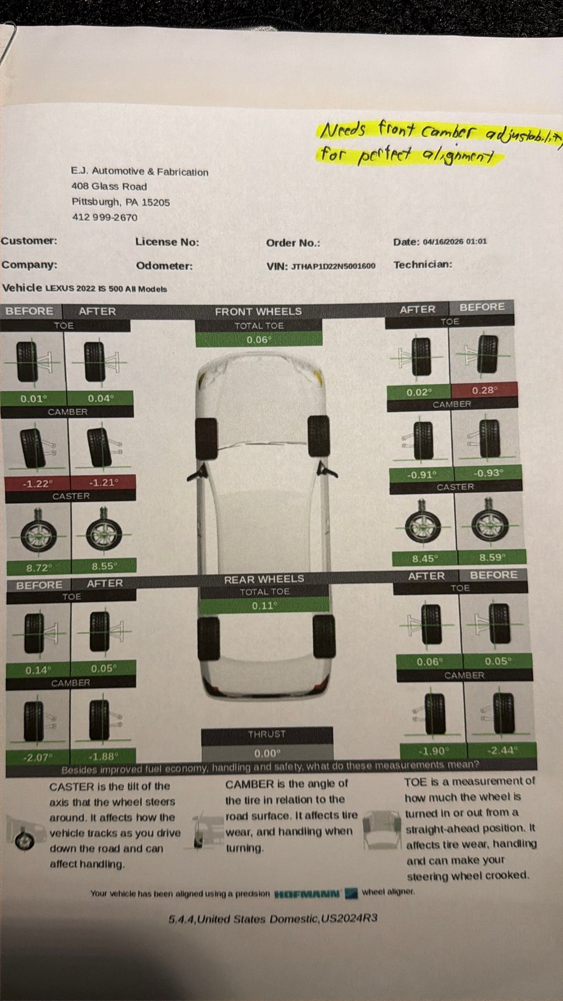

What is everyone’s camber after swift springs installed for the front? I believe there is no adjustment but a little concerned on my alignment.
