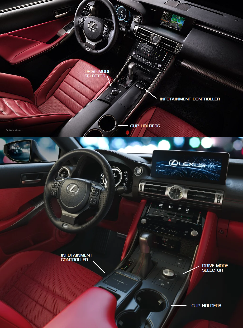

Originally Posted by TipsyTonio
Certain aspects yes. Others no...
Here's a visual aid on the changes in layout. Note the cup holders are conveniently further forward in the 2021+ so the center console is just slightly bigger as well.
Old Feb 21, 2022 | 10:46 AM
hoffheins's Avatar
hoffheins
Joined: Jan 2022
Posts: 17
From: WV
ah very nice, that's really helpful thank you.
