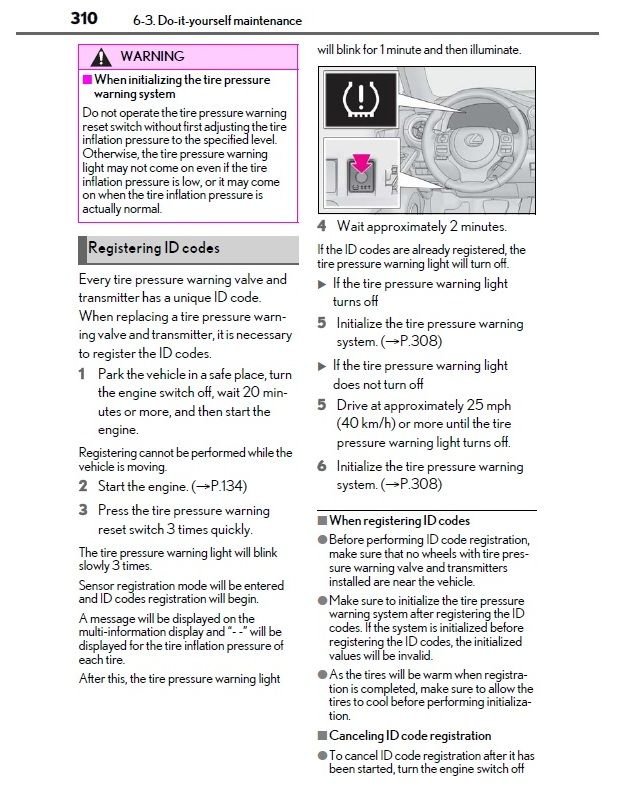

@Sasnuke Circling back on this one.
Regarding programming the TPMS on the 2021's - do you happen to have a link to the online manual about that so I can read more about it? I had the link somewhere a while ago, but can't seem to find it.
Wondering if there might be an option in there somewhere to disable the system altogether.
Old Sep 8, 2021 | 07:44 AM
jcruik's Avatar
jcruik
Joined: Dec 2019
Posts: 69
Likes: 17
The TPM initialization procedure is on page 310 of the 2021 IS manual. It worked perfectly for my new sensors, although I did need to drive for a few miles for the replacement sensors to register. There is no option to disable the system.
