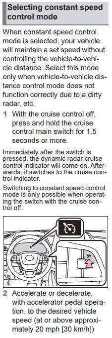

On the cars that came w/ the proximity "Dynamic Cruise Control", can you turn that off so that it won't trigger and just act like a normal cruise?
Found out my mom's 2020 Highlander won't allow this to be turned off, which I think is an awful design. Curious if the Lexus's do the same.

When you're at both vehicles next be sure to check the Owners Manual.
Page 201 for the Lexus and page 261 for the 2020 Highlander.
Unfortunately the ability to turn of the Dynamic cruise and use Conventional Cruise is there...on both vehicles.

I don't know why "Unfortunately", but thanks! I searched online and tried it myself, but couldn't ever get it to turn off, but I admit that I never looked in the manual. I appreciate the help and will give this a try.Originally Posted by Sasnuke
When you're at both vehicles next be sure to check the Owners Manual. Page 201 for the Lexus and page 261 for the 2020 Highlander.Unfortunately the ability to turn of the Dynamic cruise and use Conventional Cruise is there...on both vehicles.

I relayed this information to my mom and she was able to turn it off. I appreciate the help.
