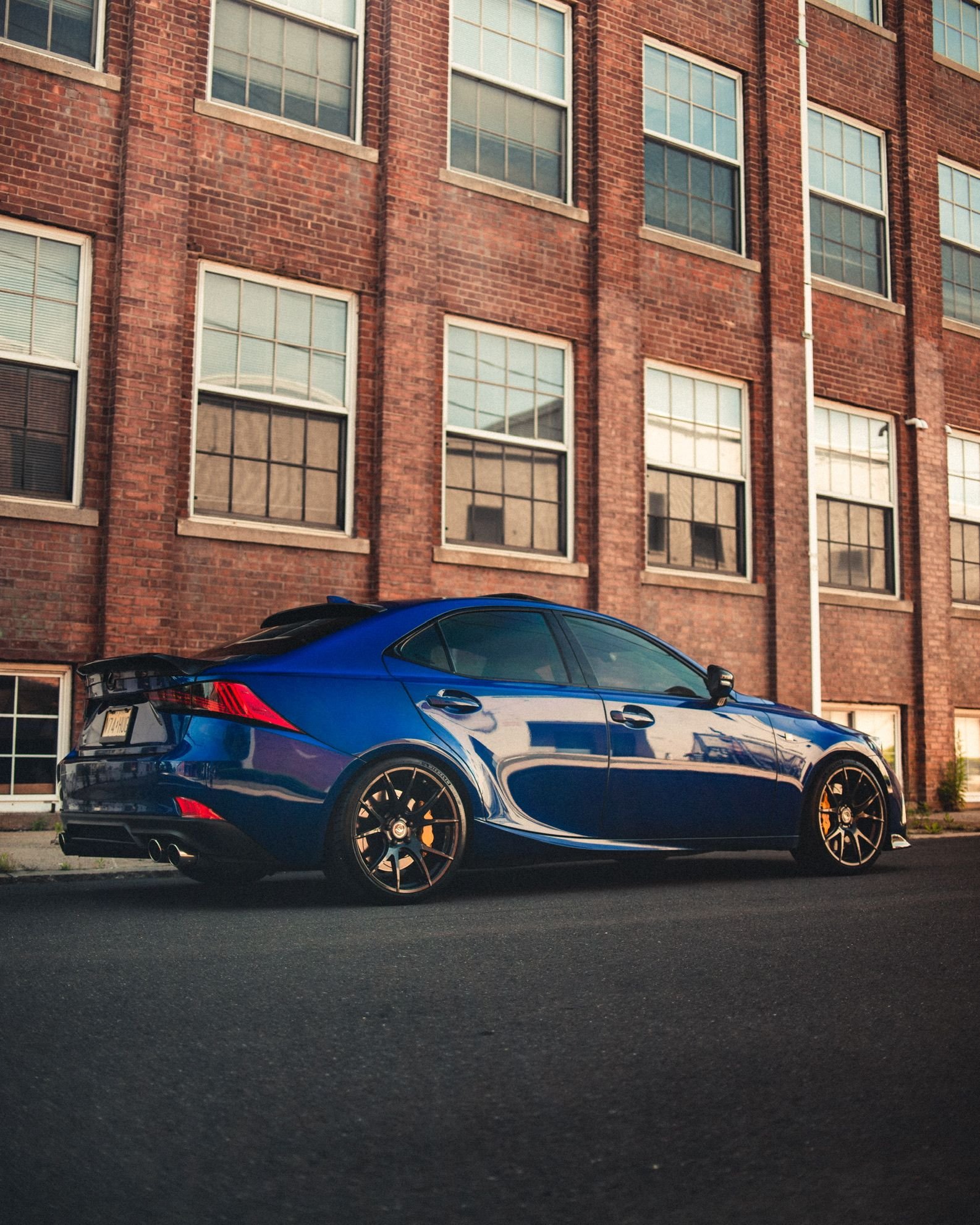

that tire shop is telling you some weird **** lol. stick with 19x8.5 19x9.5 and do +35 up front +40 rear and you should be fine with the RR BBK, it really depends on how concave the wheels are with clearing the calipers. for instance with my forgestars i have to use extended studs in the rear because i have a deep concave in the rear semi deep in the front!
Old Jan 6, 2021 | 07:22 PM
jmull3r's Avatar
jmull3r
Joined: Jan 2016
Posts: 1,080
Likes: 253

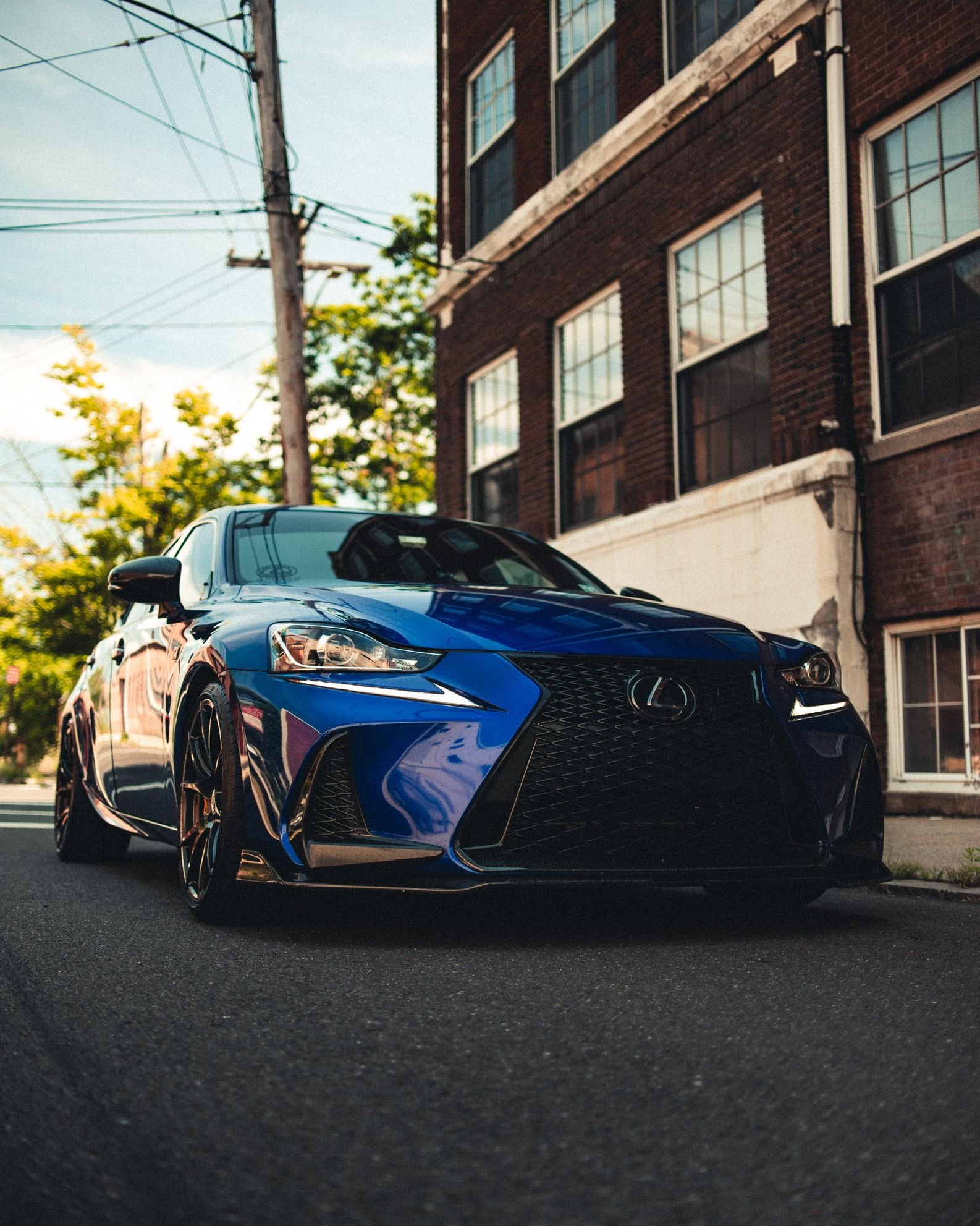

oh yeah i just looked up those wheels and you’ll be fine with the BBK! i’m running +30 front and +40 rear with the BBK and lowered on coils to give you an idea of what the offsets would kind of look like
