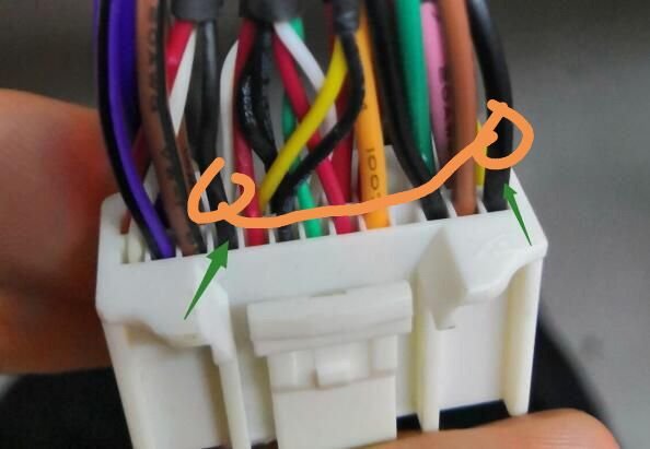

First you need to switch to AUX on Lexus side. still no sound you may have to short two ground wires together like this. It fixed for me I also had no sound when I first installed it.

Problem with Bluetooth is you cannot hear any navigation sound from CarPlay or Siri just music. I didn’t have to cut wire I just used breadboard wire with pins just inserted from the back of connector harness.
