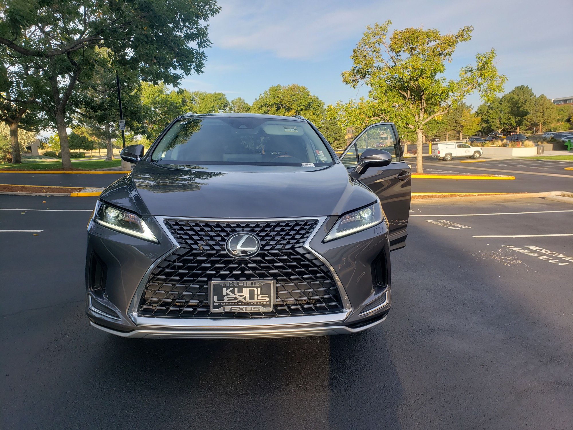

Update: got mine done! everything went awesome from start to finish.....Kuni Lexus in Greenwood village...awesome all around
Master Mechanic worked on mine, sent a vid of thorough inspection tires, suspension, etc.
Loaner car was a super nice RX
i usually do all my maintenance, etc. but if i needed a dealership for recall, i will take it to them!
