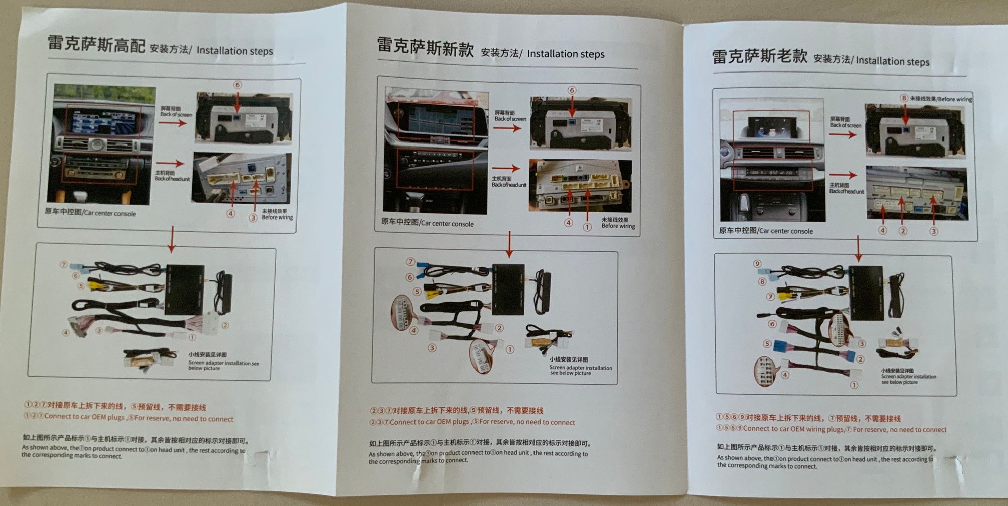

Originally Posted by kobrah
do you have the carlink install instructions they provided ?
I took pic of what came in the box.
Old Jun 30, 2020 | 08:53 AM
  #200
zhifan1's Avatar
zhifan1
Joined: Nov 2016
Posts: 568
Likes: 78
From: Oregon
Can i ask, on the 2nd pic, there are shown 3 methods of installation. For a 2016 base IS200t, rotary ****, 7" non-navi, which installation procedure to follow? 2nd or 3rd pic?
thanks man.
i was talking to the rep and she asked me
to check harness and then provided the following attached pdf.
told her I had connected like step 2.
she asked if I can switch it to the other .
I think that depends on which harness came in your box, non-nav needs a specific harness vs nav.
thanks man.
It seems logical to reverse those connection if not working but I was told same thing and didn't work. I think that's their scripted way to solve problem like if your PC doesn't work reboot.
I had to reach a higher up tech guy they had to make a new modify cable, I haven't received it so not sure it will work.
Old Jun 30, 2020 | 10:53 AM
  #204
kobrah's Avatar
kobrah
Joined: May 2019
Posts: 61
I just switched the cables. so connected CAN to OLD and connected the loopback dongle to the NEW car.
It works lol. I no longer hear the infotainment dings when using the joystick and OEM nav doesnt have options being selected.
I'm thinking that they buy their harnesses from different suppliers that might have not followed spec or they are repurposing some from others. .
Based on this, the harness they modify for you should resolve your issues. Hoping for the best broda.

I have a couple of questions and would GREATLY appreciate any insight before I tear things down in my 2017 IS300 - 10.25" Screen - Joystick Control
1) In this picture they have the OLD CAR NO SPLIT DISPLAY plugged into the CAN CONTROL and the NEW CAR SPLIT DISPLAY plugged into the loopback - I am assuming I need to swap these so the NEW CAR is plugged into the CAN CONTROL, is that correct?
Picture 1
