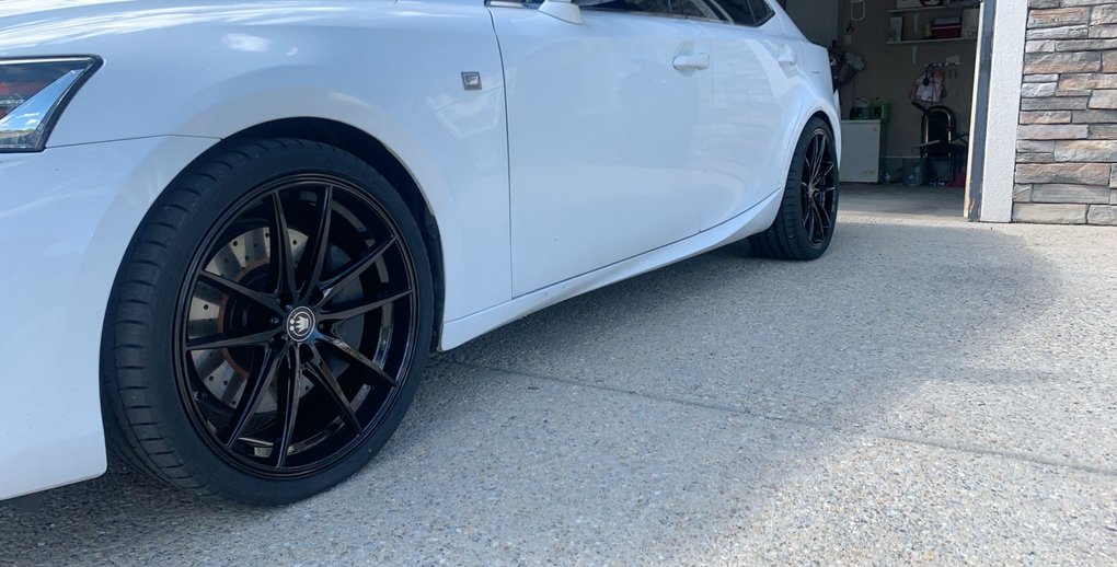

What was the final setup (rim size, offset, tire size) at the end of the day that fit?
Old Aug 8, 2020 | 05:00 PM
LexusSal's Avatar
LexusSal
Joined: Jul 2019
Posts: 13
From: AB
Wheels are Konig Oversteer 19x8.5 30mm - Square setup
Tires are Yokohama AdvanSport 255/30R19 - Square setup
Will post pictures once I get the time.
Old Aug 18, 2020 | 04:20 PM
LexusSal's Avatar
LexusSal
Joined: Jul 2019
Posts: 13
From: AB
